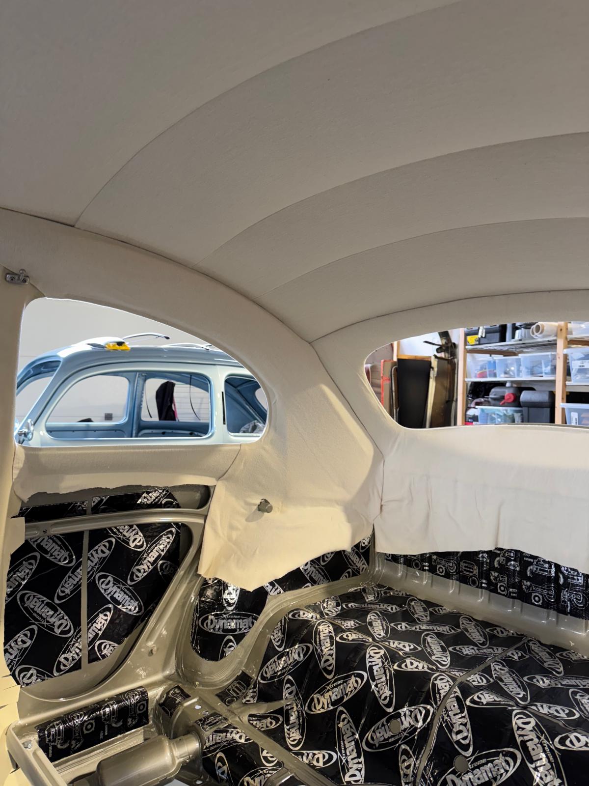

While the body was off the pan, I installed some dynamat in the roof and had the headliner installed. The headliner is from Himmel Service in Germany. The padding was from Wolfsburg West:

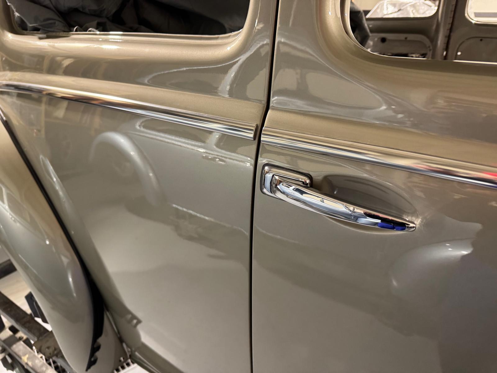

A few detail photos. Thanks to my friend Sasha and Milan who polished the plastic on my sunvisor and brought back the aluminum and chrome.
Some things I would have done differently:
- I would have removed the rear shocks and steering box given they got caught up on the body during the mating process which held up smoothly dropping the body on the pan. Please note I pulled the carbs from the engine given they wouldn't clear the engine opening.
- I filled the rebuilt transaxle right before dropping the body on the pan... I would done this a few days prior given I discovered the transaxle had a signiifcant leak after the two were mated. I still need to fix this...
- I would have skipped the passenger side mirror. I don't like the longer necks needed to use the mirror, and didn't know the smaller neck doesnt' provide enough reach to actually use the mirror. However, it looks pretty good...
- And.... many other small details that I haven't thought of yet...
