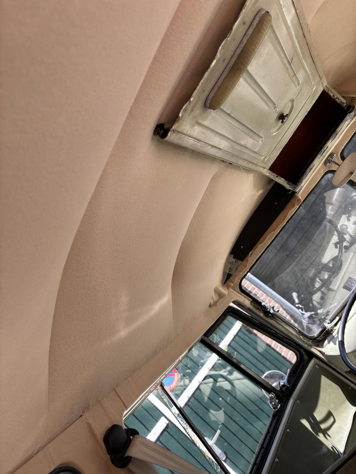

At this moment I'm installing a mohair headliner from WW in my '58 splitbus.
I've read (almost) all topics about installing the headliner (which helped a lot), but still have some questions.
Some progress..

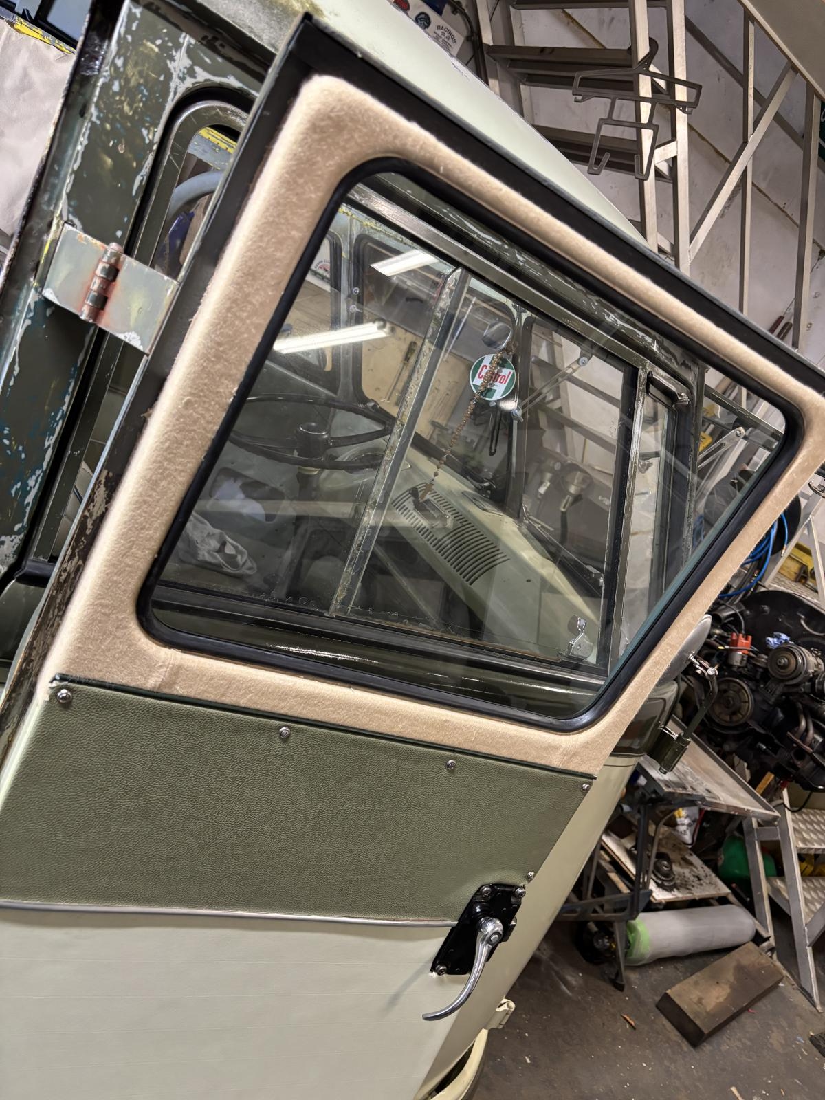

Started of with the window surrounds/vertical panels.
A lot of work, but happy with the results. I used 3M 90 glue in a spray can which seems to work pretty nice.
Now onto the main headliner. Started up front. It was a struggle, but just took my time and stopped every time my patience went south. Fitment is ok.

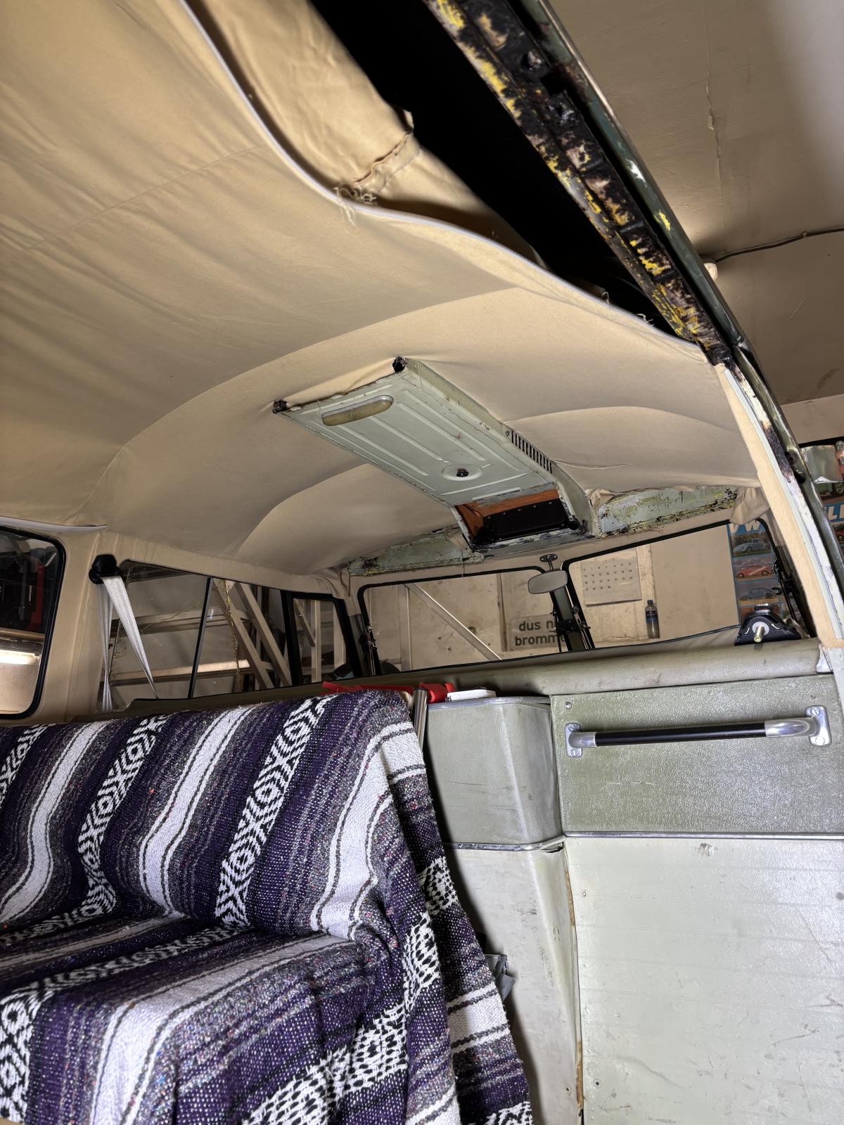

For the rear section, I believe the plastic strips have to be stuffed into the slots under the roof 'gutter'.

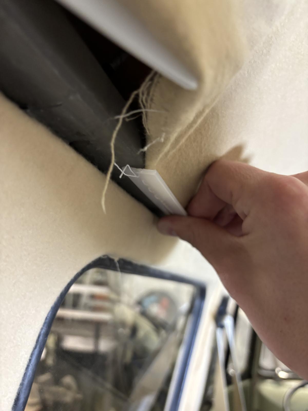

Now I don't fully understand. Do I have to apply glue too? Or will the strips be enough to hold it? Especially above the loading doors I cannot imagine the strips will be enough.
And how to stuff them in? Like this
Or this?
Or maybe flip the fabric once more to add tension?
Any tips are welcome, thanks!

Its difficult to explain, but you have to fold those plastic strips (originals were cardboard) inside, so you fold over the headliner cloth edge complete with the strip to the roof side, so its double thickness, then stretch the cloth and this fold and get the plastic strip to hook into the channel holder - the tension of the cloth holds it in place, and the as the strip is 'inside' the headliner due to the fold-over, you can only see the cloth, not any of the strip....
The tension of the cloth, and the restrictive nature of the channel stops the strip from flipping back over/coming unfolded - its locked in the channel.
Re-reading that makes little sense to me Laughing , but that's how its done.... its a simple, but ingenious design actually...

Thanks for explaining! That makes perfect sense. I'll try and report back.
