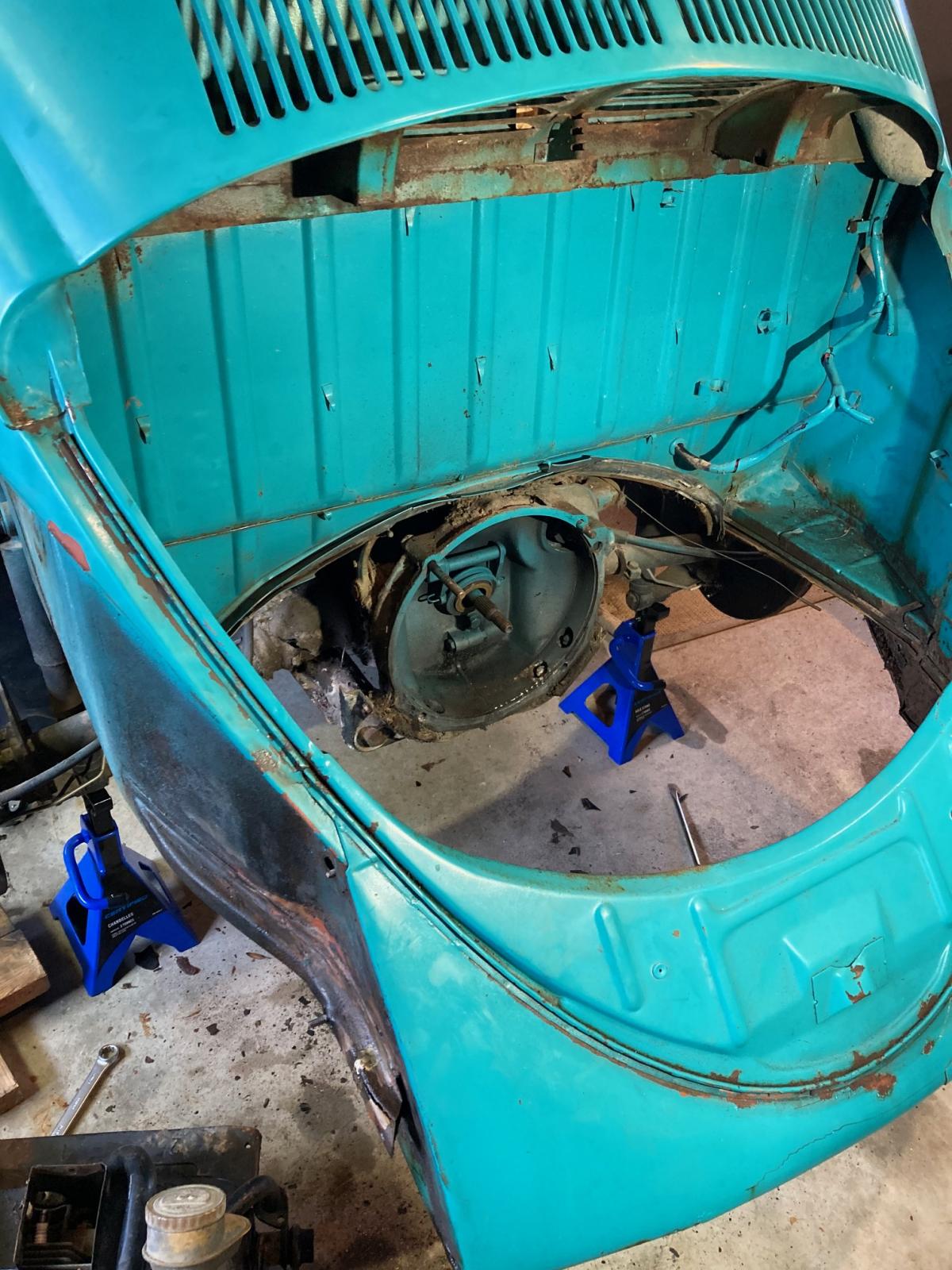

40 hp Stale air engine is now out. Thanks again to Don for coming over to help out.
Interesting bolt...... ended up removing with cutting disk.
40 hp stale air motor in good condition. Was running when I bough the car. Good solid compression and end play.
Transaxle will need new mounts and cleaning up.Otherwise in good condition as well.

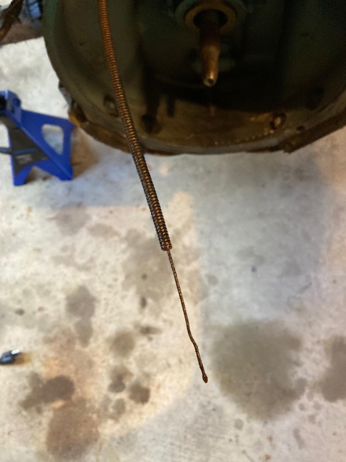

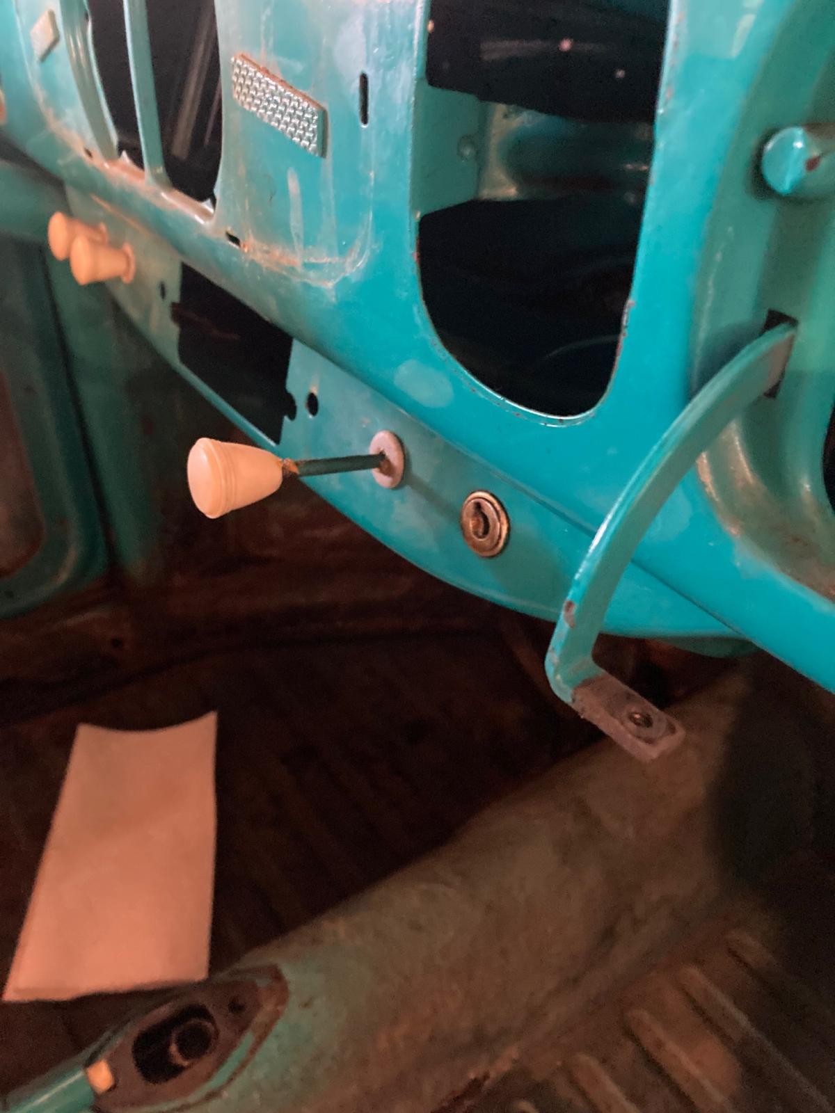

When I bought this car the choke was still located on the dash but not clear were it was otherwise. The 40hp was in place but it uses an electric choke. My immediate thought was maybe it was cut.
But somebody had coiled it up and left it underneath the rear parcel tray above the transaxle. This wasn't good. These old cables just love to rust up and then seize up.....not an easy replacement!
So I uncoiled it and sanded the cable end for rust and ran penetrating oil down the sheath. Also lubed it at the front dash. Closing and opening the choke is smooth as silk. Got lucky here.

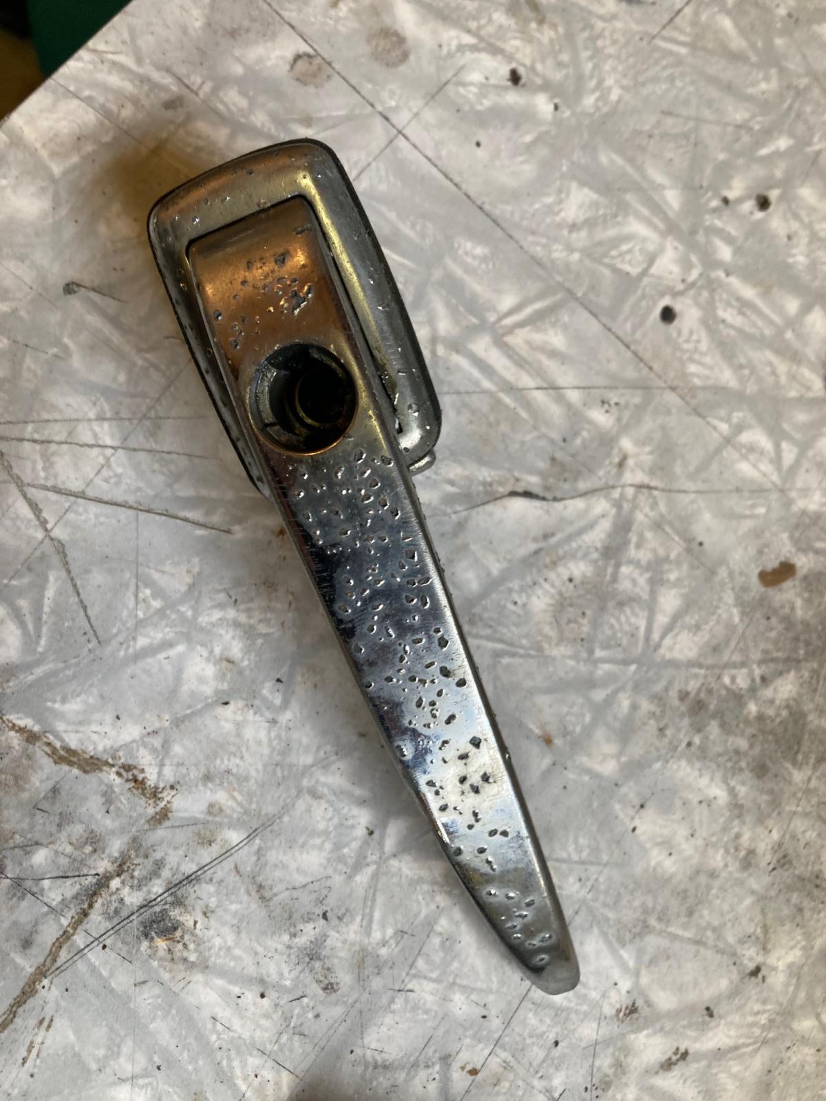

Taking the two small Phillips screws out to remove the drivers door handle, one decided to strip the head. So I thought another extractor attempt might be successful this time. This dream was cut short by the carbide extractor snapping off ... so I am zero for two .... again! Bought a Dremel carbide 562 burr($27) and just let it run without too much force on it. Important... make sure to wear safety glasses as carbide can shatter with shrapnel resulting!! Was able to sink two small holes on either side of the screw..... and it was able to be unscrewed with minimal damage all in 15 minutes! Fortunately the screw is relatively soft metal. In hindsight just should have drilled it out directly. No more extractors for me.
The entire lock cylinder fell out and the door handle is broken in poor condition. Will be looking for some replacement handles in the near future.

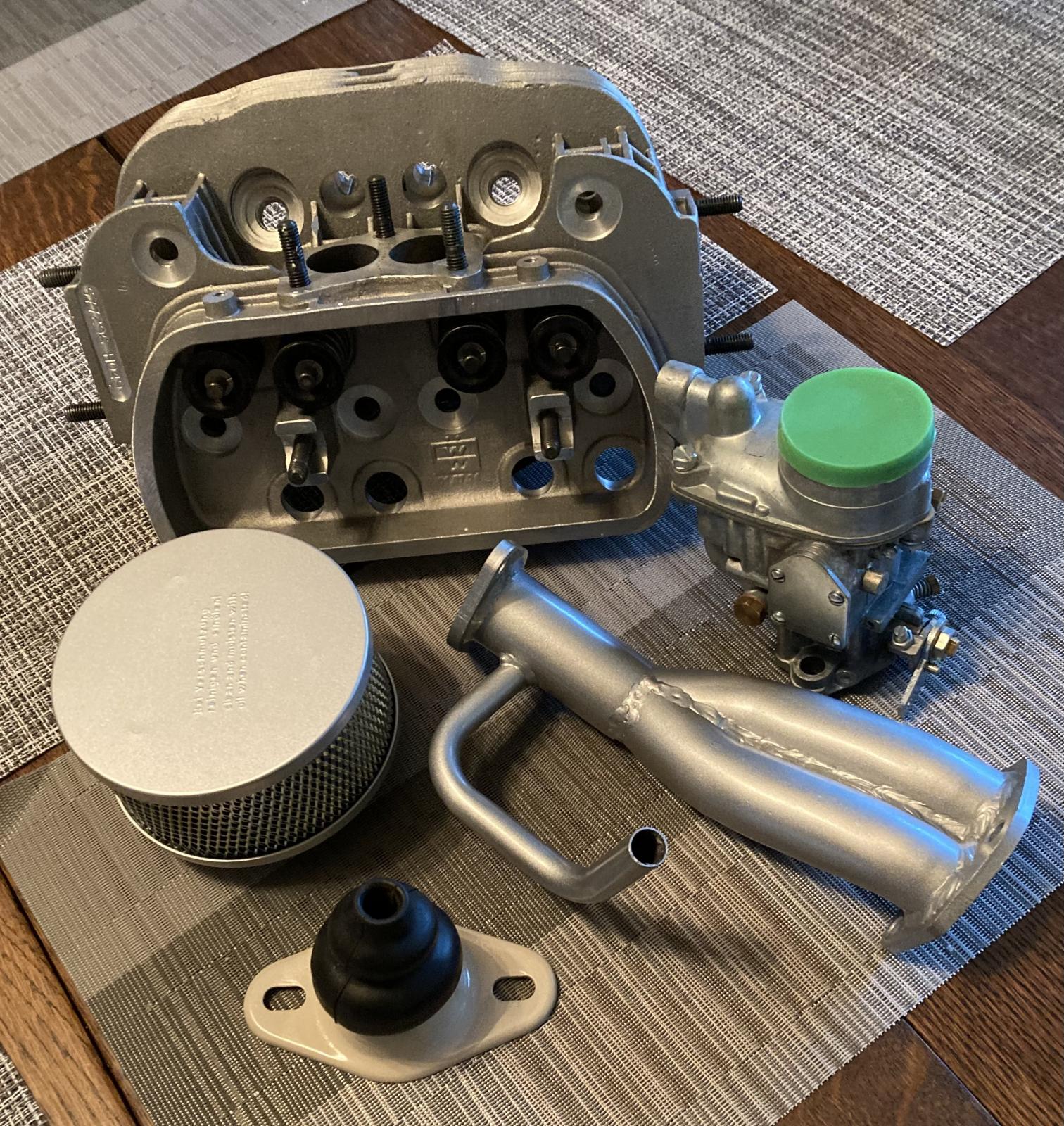

I would have had no problem putting the stock 36hp back together. But the 'Net and VW parts sales combo, has once again impacted my "budget".
Since the Wolfsburg West repro of the 'Okrasa' dual port head kit was introduced years ago I have always wanted one, so a decent price showed up....... and what could I do!! Then the additional parts that should be added to the engine build turned into another rabbit hole. Mild cam, domed pistons, balance and blue printing, etc.
So after a discussion with a few people from here, decision made in keeping it simple and putting it together "stock". Now somewhere just slightly over my budget, or way beyond my budget. Maybe it had something to do with the sale of the STI and clearing that out of my garage last week!!
My schedule for bodywork to start remains this summer/fall.

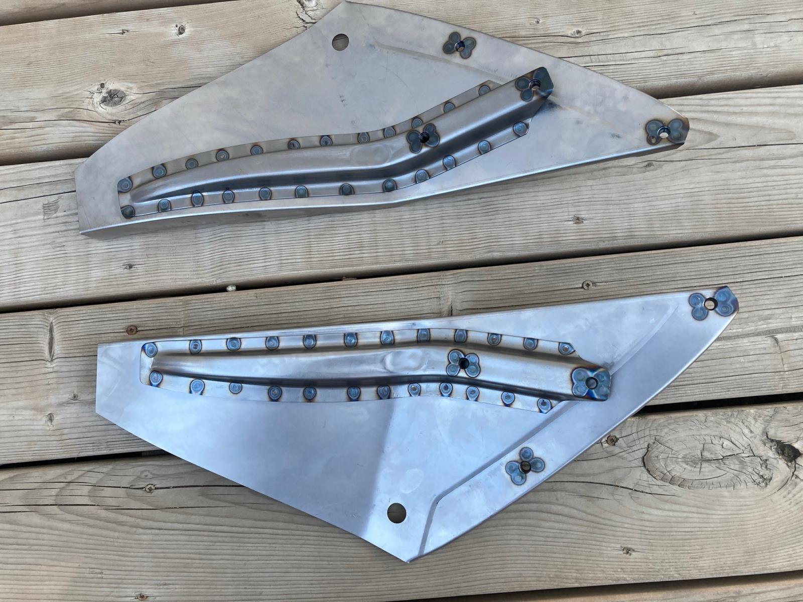

Wolfparts rear bumper mount panels arrived.
Rear window glass and passenger side glass removed. Passenger door glass removed and internal door parts Window trim next....
Body bolts being removed with no issues ... so far...

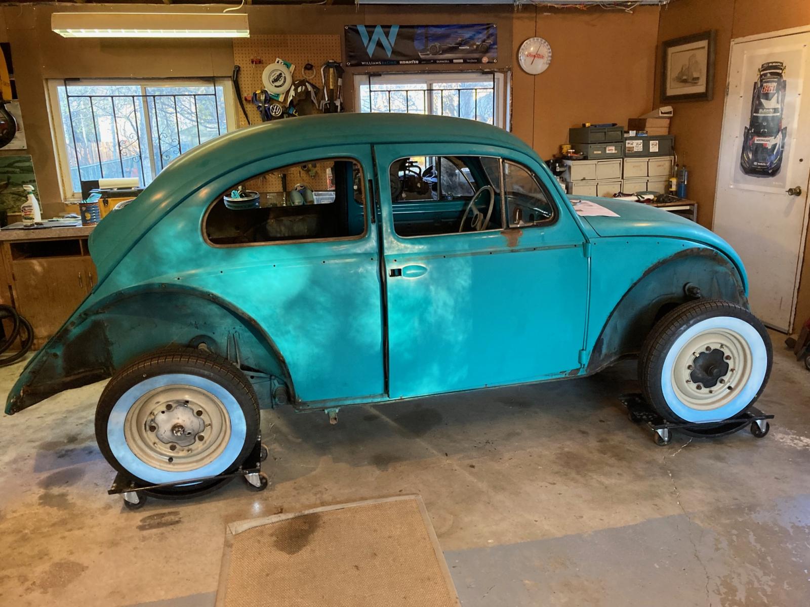

Wheels on with dollies making garage life easier!

Looking like you are set to have some fun!
Those wheel dollied are a game changer! Nice shop upgrade!

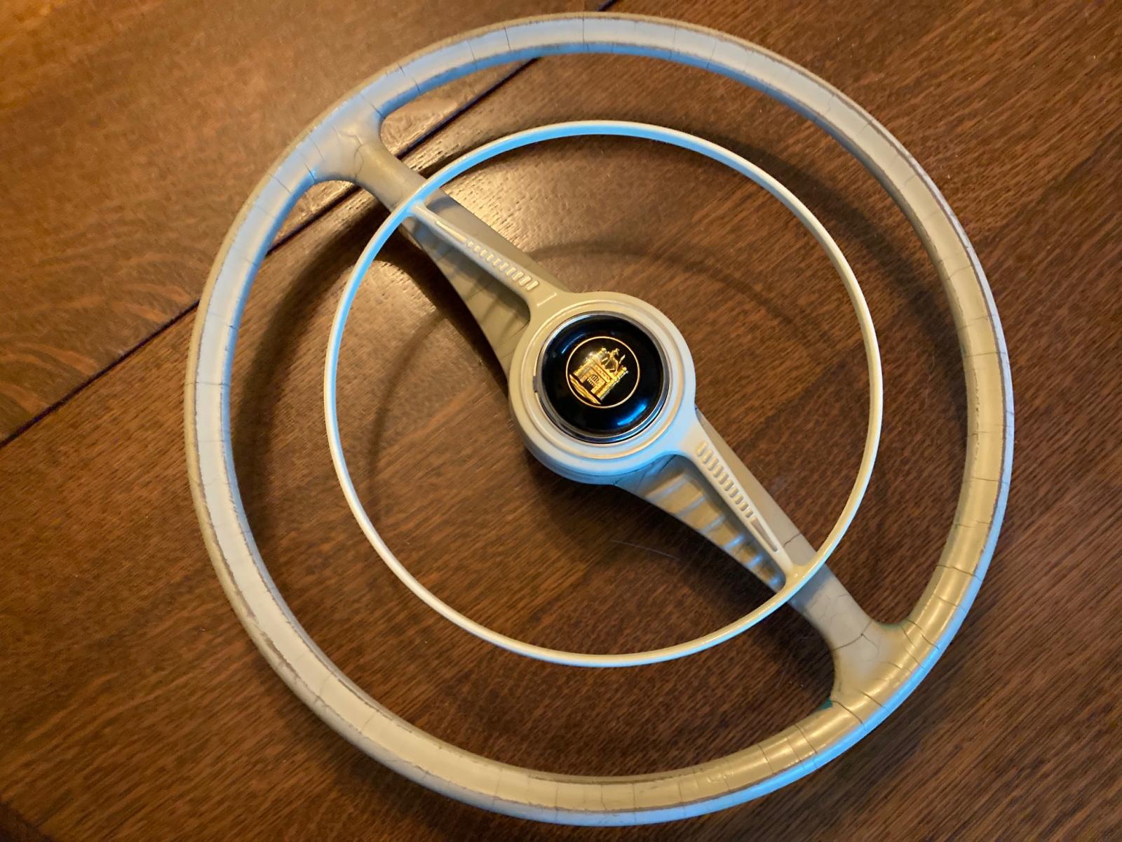

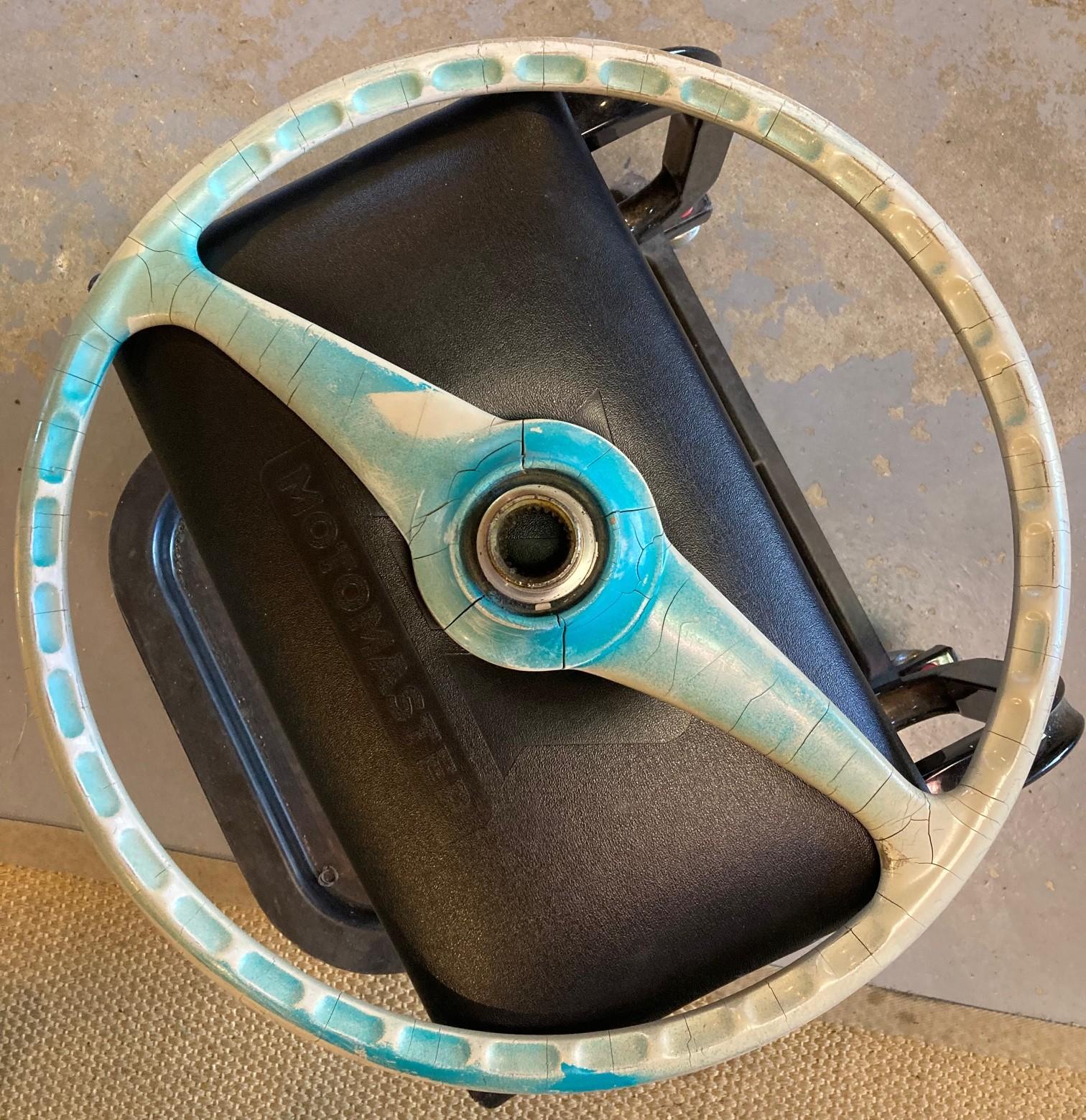

My steering wheel needed some attention so I thought I would give it a try.
After an initial sanding, I tried JB Weld 6 minute epoxy (pic 2).With the quick cure time it was hard to work the material into the cracks. Fumes and sanding dust are a problem. And it a coarser sand paper, which removes too much steering wheel material as well, imo.
So being a modeller, I am also trying an acrylic resin, Vallejo (pics 1 and 3). Full dry time is one to three days. During which time you can remove excess material and further sculpt the repair. Fills cracks easily and less material used to sand. Fumes also minimal. Still figuring out timing of application and when to sand.
No clear winner yet but liking the acrylic. Stay tuned!
