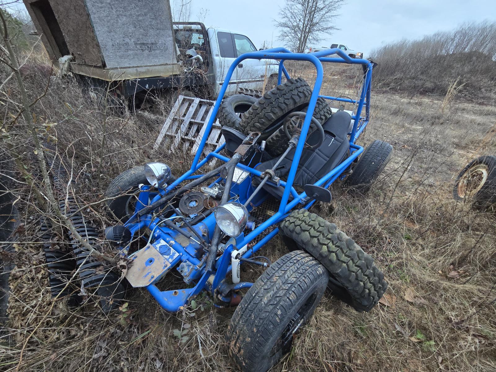

Here be what we started with
And here be it sitting at me work yard.... where it's been since I moved. Boo hoo!

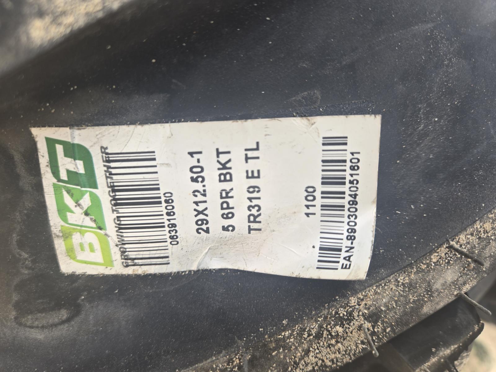

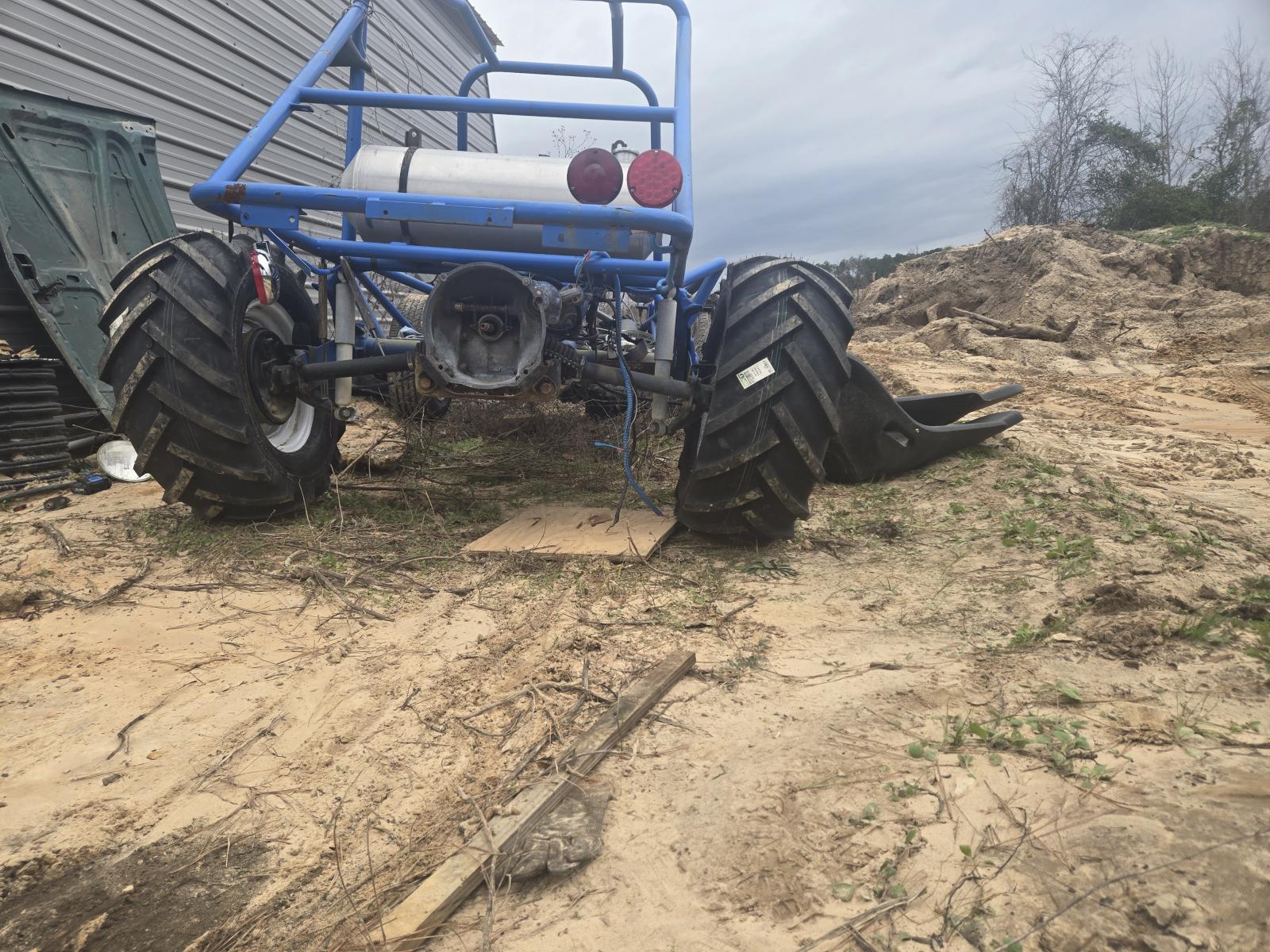

So... for motivation.... I did the most logical thing I could think of... impulse bought something that it really doesn't need yet... because I wanted to know how they would look on there. Applause
Some tractor tires, woohoo
And uh, well... that's how they would look on there.
Been wanting to try a set of those for some years now.
Measured wheel width was 9", I squished them on the 15x8's, seem to fit the dimensions of everything decently.
They advertised at 44lbs and the shipping weight actually showed 88lbs for the pair so must be accurate. For those who don't know, a 31x10.50r15 weighs in usually from 40 to 50lbs.
So... maybe I'll be working on it some more soon Very Happy

These are labeled as 6 ply. I'm really not sure wtf they are marketed for.
There was an 8 ply variant available but ofcourse it weighed more which was a turn off for me.
The more common 31x15.50-15 terra / v tread are marketed for small tractors and ditch witches (I've seen both types of machines with that size) and are unreasonably heavy. Also like you said, they are usually 10/12 ply.
Aaaand I already had the 8 wide wheels and didn't want to buy 10 wides for larger & wider tires.
Question I'm a friggin tire nerd.
Speaking of, I need to mount the engine and do some measuring to see how tall of a front tire i need. Searching around at the 7.60-15 and 9.5-15 5 ribs... trying to focus on floatation. The land out here is kind of deceptive... Will be driving along a nice patch of green forestry and start noticing water flinging off the tires... then it's too late for the pizza cutters.

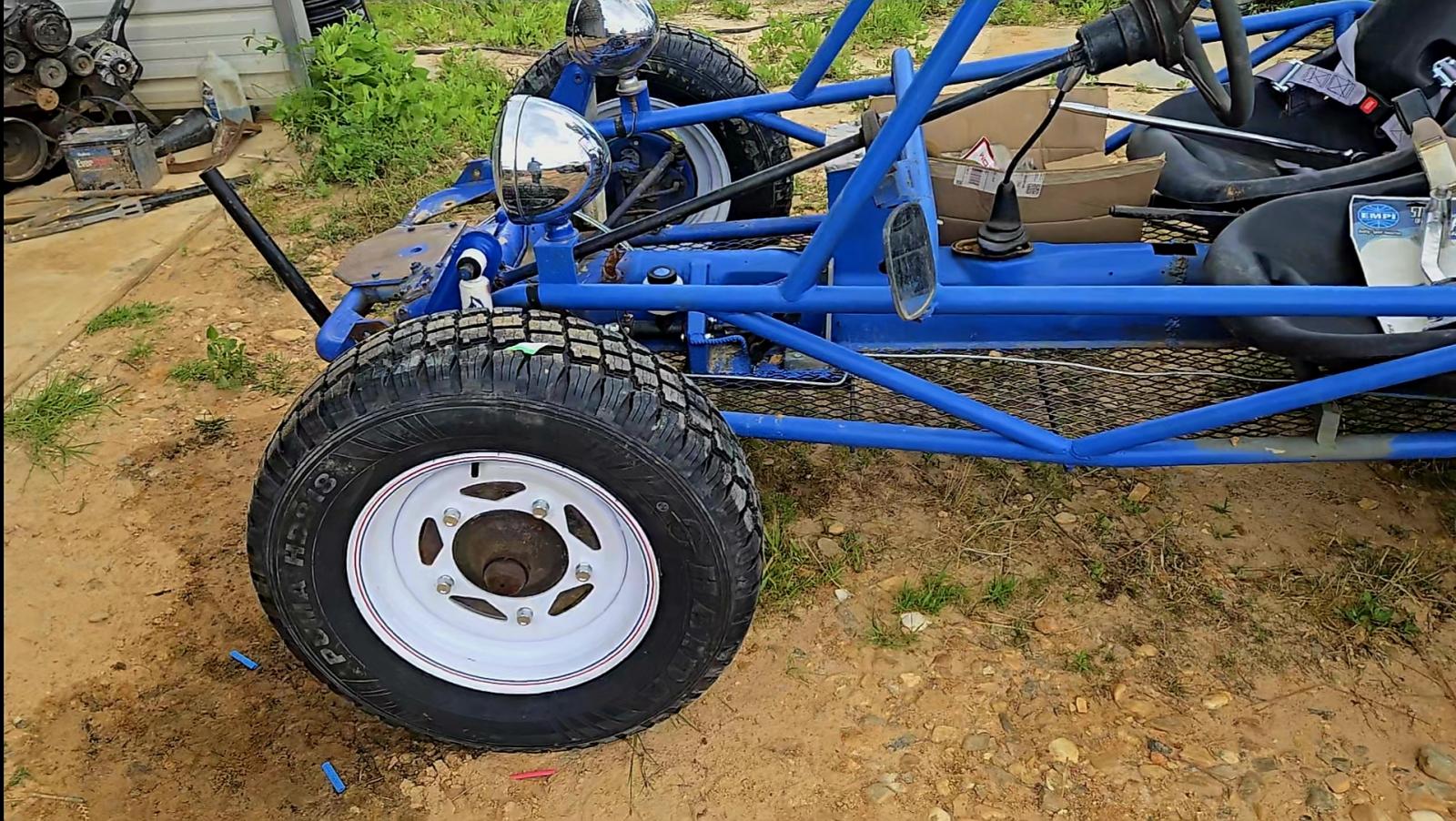

I finally bought some matching front wheels for it Arrow Arrow Arrow
Good bye to the 14's

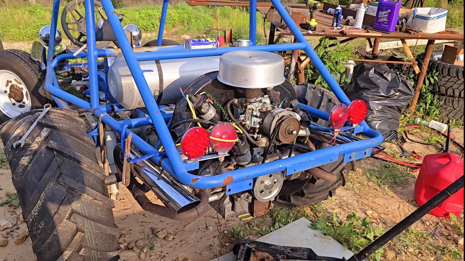

Decided to drag the engine out that I had alotted to the panbuggy. It is a 40hp that someone had built into a 1600 SP with 1300cc super small valve heads. I had an okish set of stock DP heads collecting shop dust so decided to put them on it.
So we now have a 1600DP built on a 40hp base with 180mm flywheel/clutch and a sand seal power pulley Laughing
No, I don't want to hear how crappy the power pulleys are.
Mated the engine to the tired old machine who was probably hoping to rot in peace.
Did get it running, was nice hearing the little engine pur this evening.
Still have a little ways to go before I can ride once again, but getting closer Cool

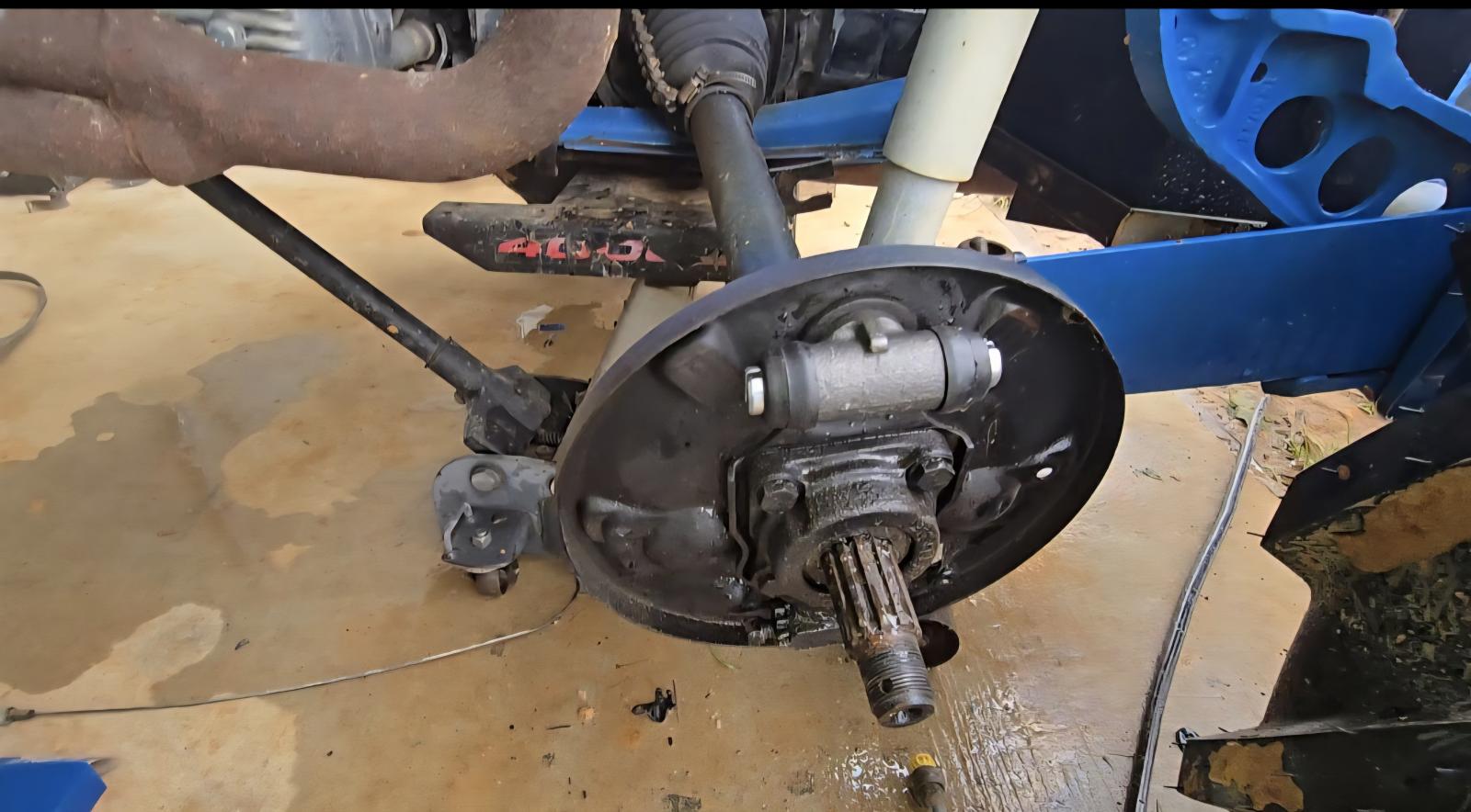

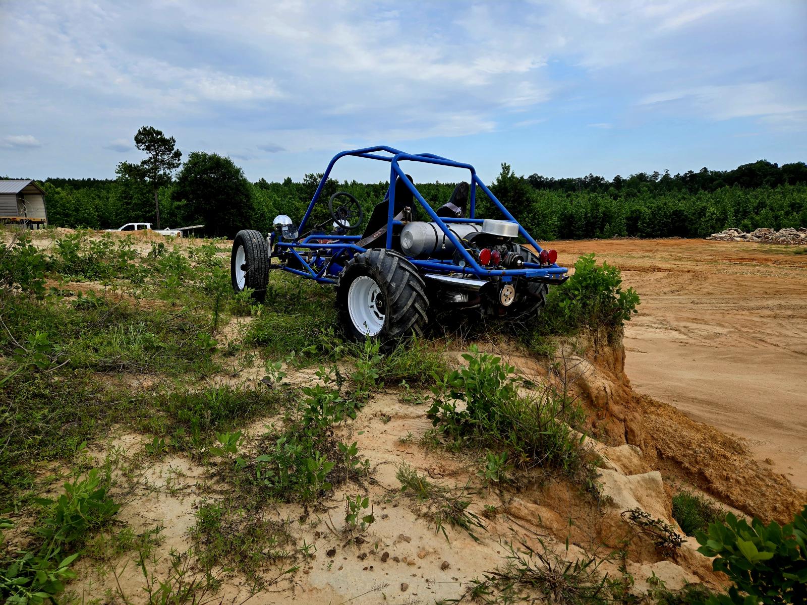

Spent about 1.5 days tweaking out on this thing over the weekend.
Loaded it up Sunday afternoon and took it to a family gathering.
Had quite the blast on it.
Now has all new brake parts & hoses (agiain... i robbed them for something else)
Topped off the trans fluid and changed engine oil.
Couple other little Knick knack things.
Going to step down to a 215/75 front tire... the 225/75 just barely rubs the chassis at full lock.
And it has been time for kingpins which will be done soon...ish.

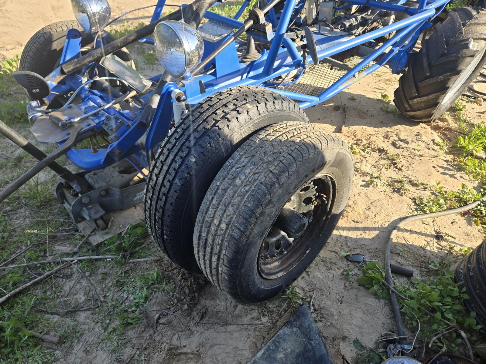

PostPosted: Sun May 25, 2025 8:14 pm    Post subject: Re: Me 1964 pan rail refresh. Reply with quote
Yeah, it's kind of shameful how little it actually needed to be ridden again. Embarassed

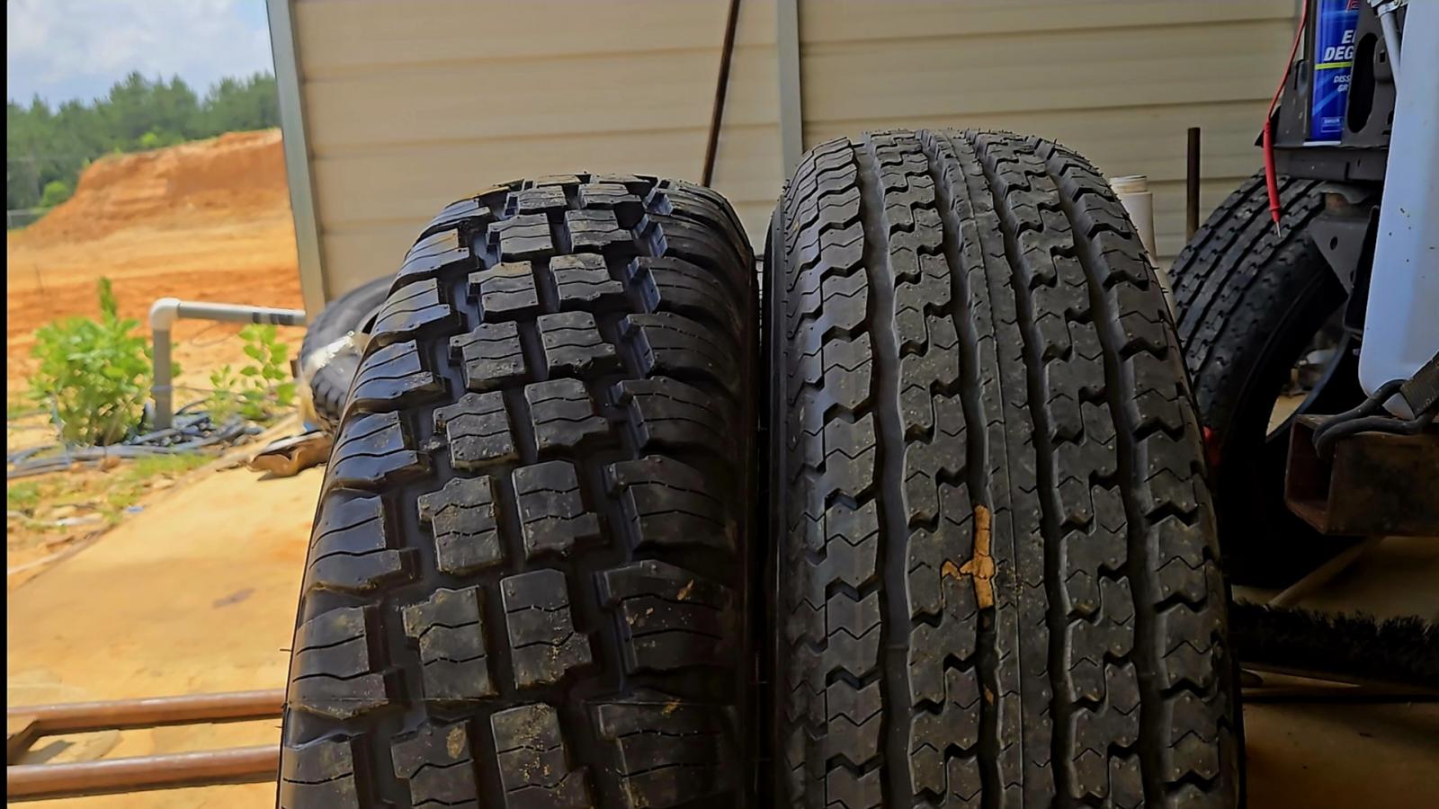

OCD'D out on the net and picked another front tire.
Downsizing from the 225/75 trailer tires to a 215/75 LT tire.
And eye like em!
Also pictured, changed out the type 3 shifter for a cheap empi t handle.
The previous shifter never worked correctly. Reverse was accessed without pushing down so when you're wanting to romp through the gears, it was a bit hard to hit 2nd correctly.
The T handle works exactly as it should... oh and it doesn't seem to pop out of gear when taking off under heavy throttle. Win!
