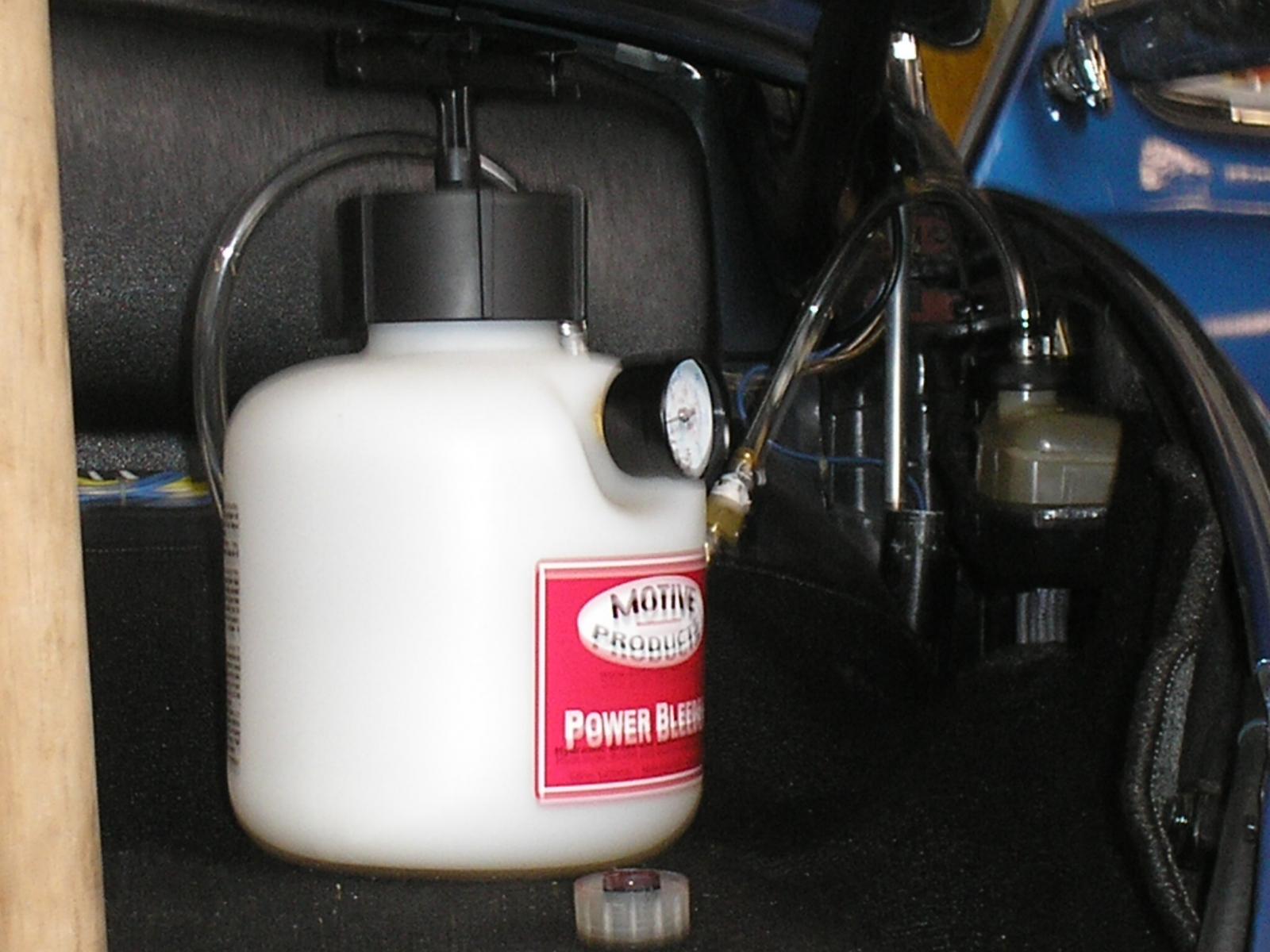

use one of these pressure bleeders. Easy to do by yourself, no need to 'pump' the brakes, and no mess of fluid squirting everywhere.

X2 on gravity bleed as the first step. If you want to preserve your marriage (or your relationship with your significant other ... or long-standing friendships) invest in a power bleeder. Motive offers one with fittings for ACVWs.
