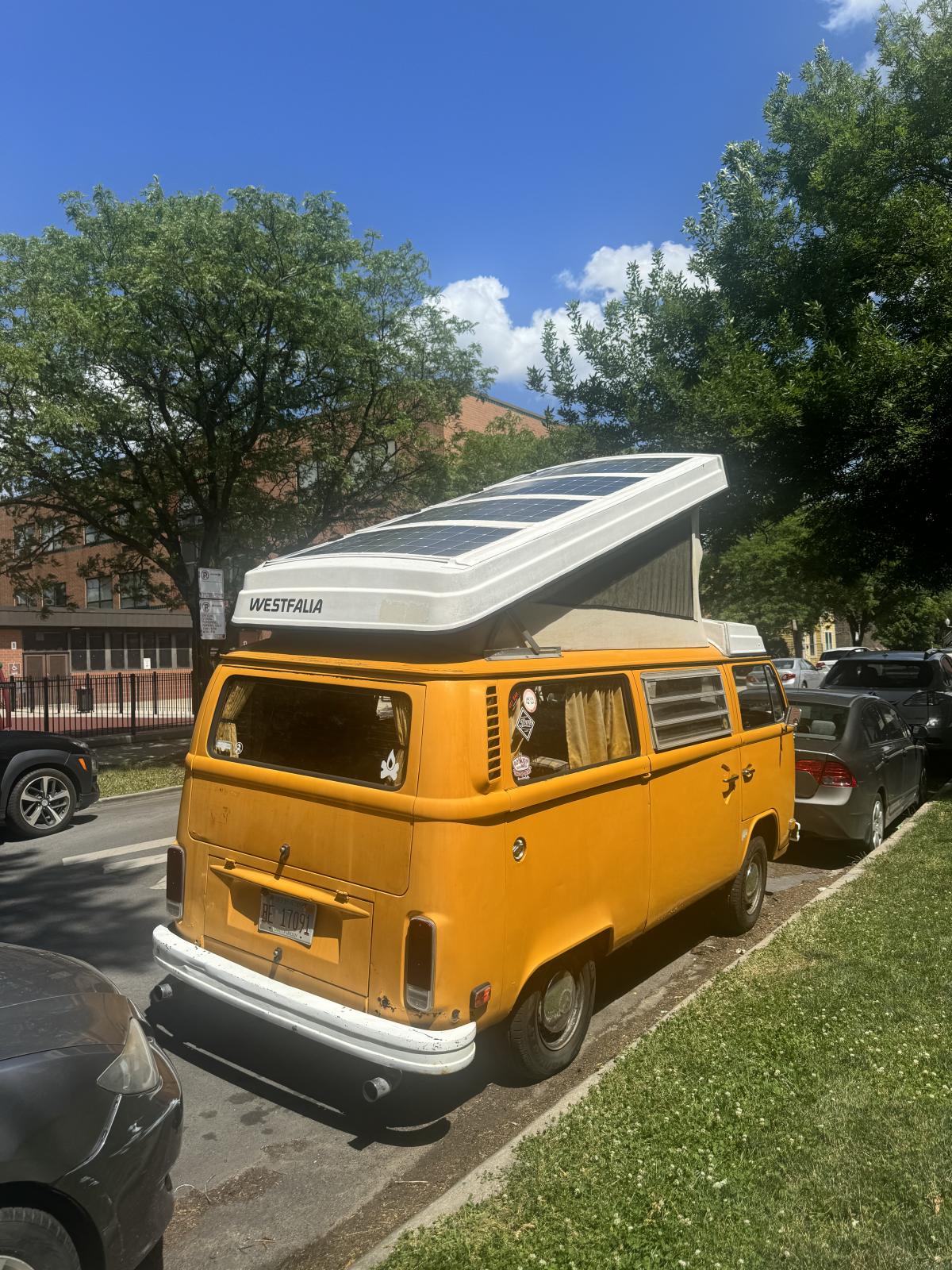

Weโ€™re about to find out if this can be done. I was not in the position to drop $1500 on the Ecoflow Wave 2 but now that the wave 3 is out, a refurb wave 2 is on eBay for $429 with a 30 day return policy. It doesnโ€™t come with a battery and that kind of kills the efficiency because it will run thru my ac inverter while Iโ€™m not on shore power but, Iโ€™m willing to try it since I already have so much invested in batteries. I can buy the newer wave 3 battery if this all blows up and doesnโ€™t work. Also if this does work I recommend just getting the Ecoflow full system and donโ€™t hack it together like I did. They have it all as a kit now and it will work much better.
My solar panels are the thin flexible kind and are taped down to the roof with this gnarly strong RV tape. Been there for 2 years with no issues. I did forget to disconnect them over the winter and cooked my solar controller but that was just a slightly expensive mistake on my part. Again, if I was starting over I would like them to be mobile. The problem with them permanently attached to the roof is I canโ€™t park in the shade to stay cool.
Anyway, here goes nothing. My hope is this isnโ€™t as disappointing as the icybreeze coolerโ€ฆ
