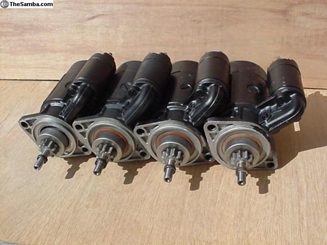

I have 12V auto, 12V std. and 6V starters.
Hybrid 6/12 and Hybrid 12/6.
6/12 is for a 12V system on a 180mm flywheel.
12/6 is for a 6V system on a 200mm flywheel.
No core charge
HYBRID STARTER 6/12 https://www.thesamba.com/vw/classifieds/search.php?username=Wayne+S.+Johnson
Additional products with Bluetooth http://www.thesamba.com/vw/classifieds/detail.php?id=2097231
