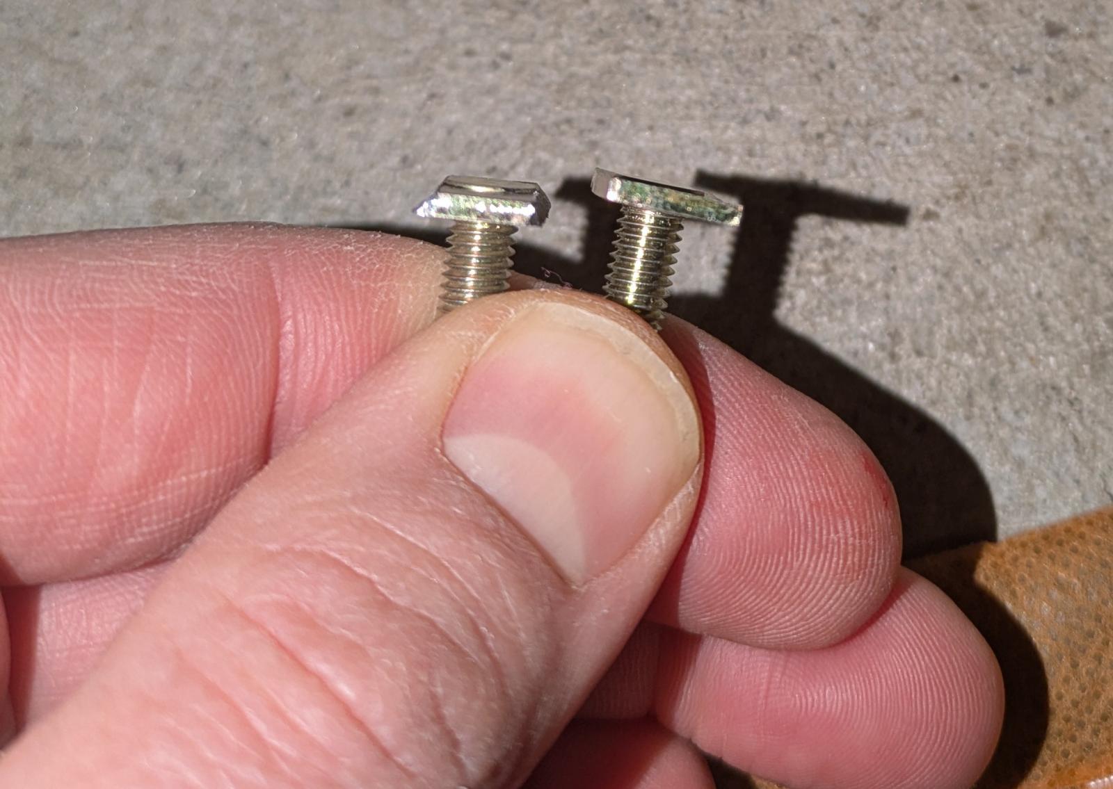

I meant to post these pics a while back of the side trim install with the MG Midget clips. They're not actually clips, but stud plates. The side trim I bought was from KGPR, and the plates were not a direct fit into the trim. I had to use a bench grinder and reduce their width slightly and add an angle profile. I'm not sure if other brands of side trim would require that as well. I admit this step was a bit fiddly and annoying having to trim so many of these.
Here you can see a modified one next to an unmodified one
I bought the stud plates from Rimmer Brothers in the UK
https://rimmerbros.com/Item--i-AHA9447?srsltid=Afm...7KSItDCgQ2
They don't actually come with the nut that's pictured, but that doesn't matter because you'll want to buy M5 locknuts anyway so they don't come loose. I also used an M5 rubber washer on the inside of the body panels as a seal.
The studs are smaller than the side trim holes, which means you need to make sure the trim pieces are straight in line with one another before you fully tighten the locknuts down. This took me quite a bit of time making sure that each trim line was straight and that the two were parallel.
