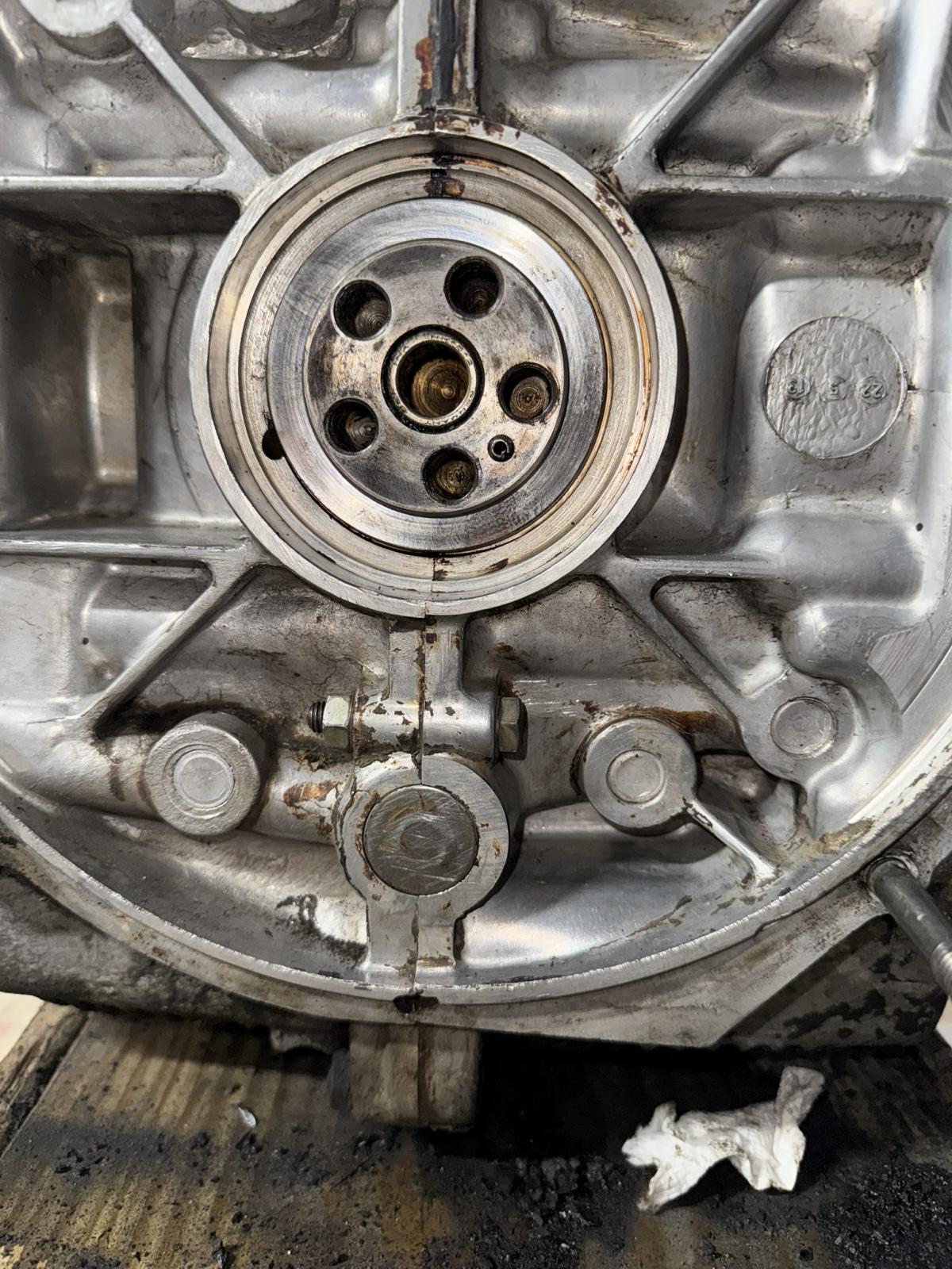

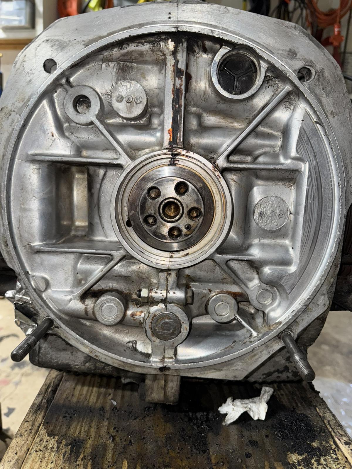

Ok, I ate my spinach and was able to get the flywheel off. Here are the pictures before cleaning and after. It appears the seal was leaking. It was very brittle. This is consistent with the leaking when split the transmission and all the oil on the bottom side of the engine and transmission. I see the o ring now. Looks like I need to order the round metal plate and some new bolts per recommendation mentioned above.
Tell me what you see. I assume the small round plugs are the ones I need to peen, not the larger one directly below the crank. What is the larger round item?

cam plug

There are three plugs the reside behind the flywheel that you need to peen around, they are all the same size. There are other galley plugs around the engine that are smaller that can also be peened around, but their smaller size means there is less pressure trying to force them out, so it's less important to peen them. The one below the cylinders (can't remember which side) can not be peened with the cylinders installed.

PostPosted: Thu May 22, 2025 6:29 am    Post subject: Re: Engine/Transmission removed where and how would you start? Reply with quote
Are these the 3 plugs in blue circle? If I remove cylinders I will look for those.

clean the plugs with a dremel wire brush, peen very carefully with a sharp punch to fold the aluminum over the plug, clean with acetone on a rag, and cover with JB Weld. They won't come out that way. It is safer than pulling and tapping.

Yes those are the ones that must need staking. There are pictures out there that show all the plugs, most are on the other end of the engine, while one or two are near where the oil filter adapter mounts and then the one below the cylinders.
