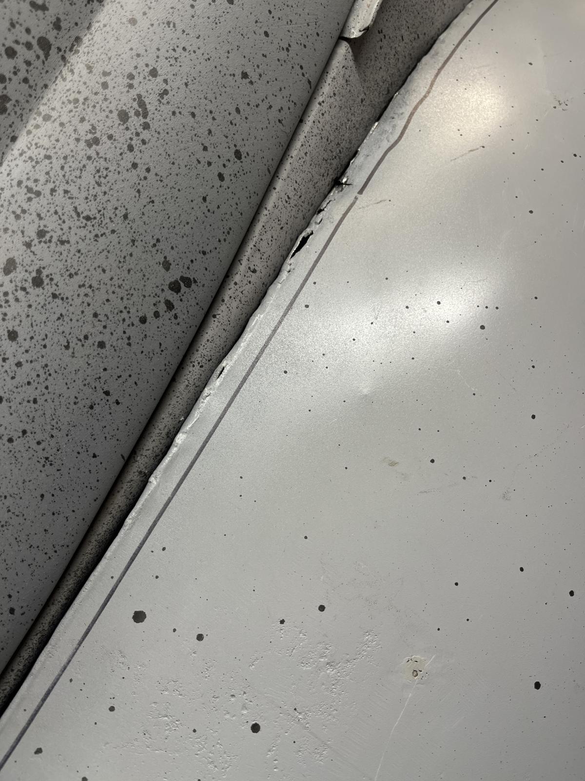

PostPosted: Mon May 19, 2025 5:23 pm    Post subject: Re: Jimmy V's 54 Oval Project Reply with quote
The hood seal line looks very respectable!

PostPosted: Mon May 19, 2025 8:22 pm    Post subject: Re: Jimmy V's 54 Oval Project Reply with quote
In total agreement! This side, after hammering on those dents, laid down really nice. I need to hammer out the other side. If that lays down just as well, my job will be done!
One more side to go!

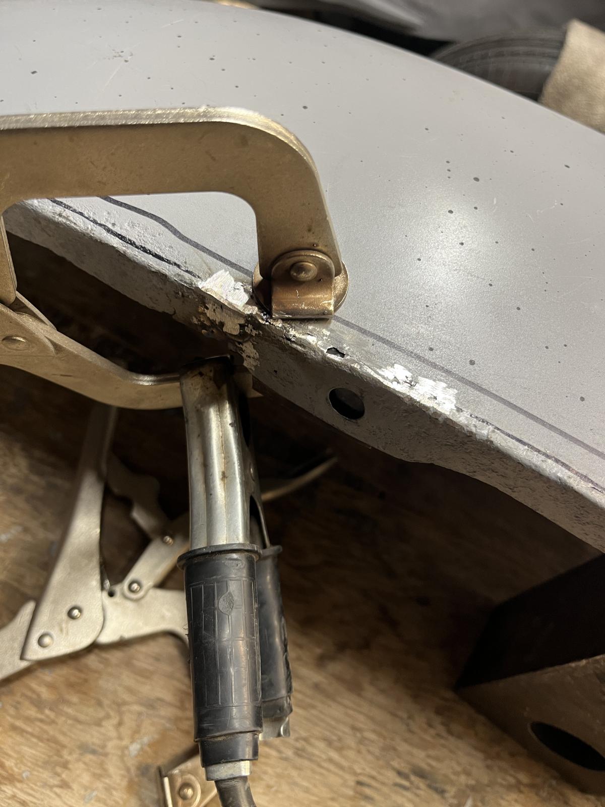

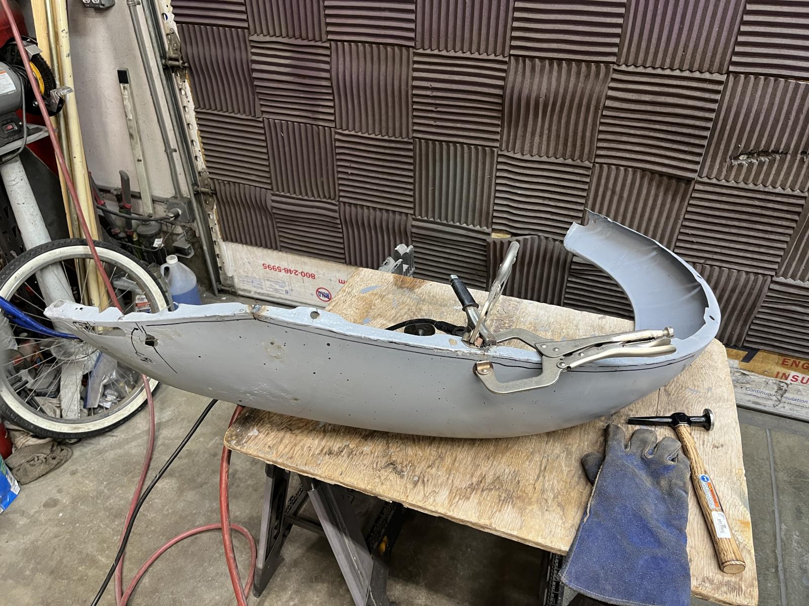

Set up the rear fender. It needs some thin metal replaced at the rolled over edge towards the bottom. Pulled out a section of old front clip steel that already had a soft 90 radiused edge.
Spent some time between the stretcher, shrinker and hammer, working the piece until I got the compound curve just right.
I clamped the piece to the fender repeatedly, checking it, but also shaping it too.
It was a bear to get it to match.
Just a bit more to go. So close!
More hammering. More clamps. Better!
Then finally, it is perfect! Now let’s mark the fender for the cut and remove the rusted steel!
I had to cut the folded edge to get the piece to relax enough to fit the shape. You can see the segmented cuts here.
Those will get formed 100% and welded up later. However, I did take the time to shape the edge a tiny bit. I bent the first tab around to fit then the next. Marking each segment overlap, so that I could cut out the portion under the top segment.
The piece was then unclamped and cut. Look at those tiny slivers!
And the resulting piece. A double compound curve with a rolled over edge!
Let’s cut the fender! Dropped the disc in after cutting the 2 short sides.
Cut it till it dropped out! Left the marker line, as that was the outline of the patch!
I then picked up the fall off piece and slipped it into the patch. Then I clamped the shit out of it. The hammer was then used to finish rolling the edge over, matching the old piece 100%!
And there it is….PERFECT!
I removed it and removed the paint from both pieces. A flap disc on the fender and the blast cabinet for the patch.
It was then clamped well and welded into its place!
Then my good friend rang the beer bell! Time for a few pints and a late lunch! Primed the exposed steel, then pushed the Bug over to its spot and checked out it’s rear section!
Not too shabby, right? Hopefully I can get a few more hours in before the wedding!

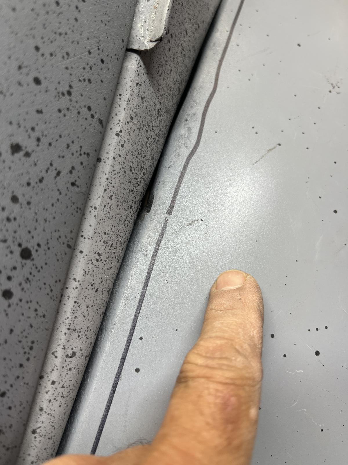

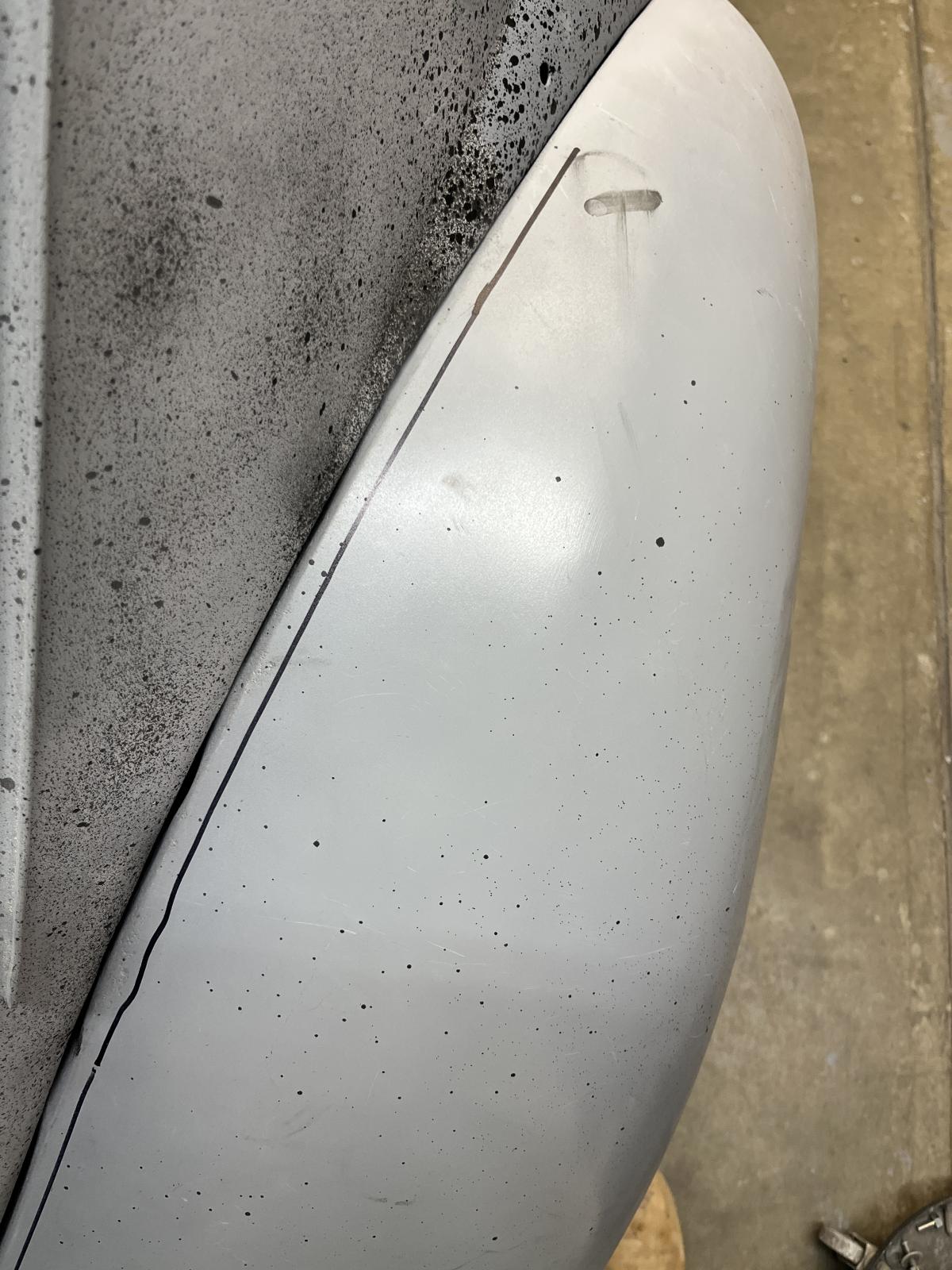

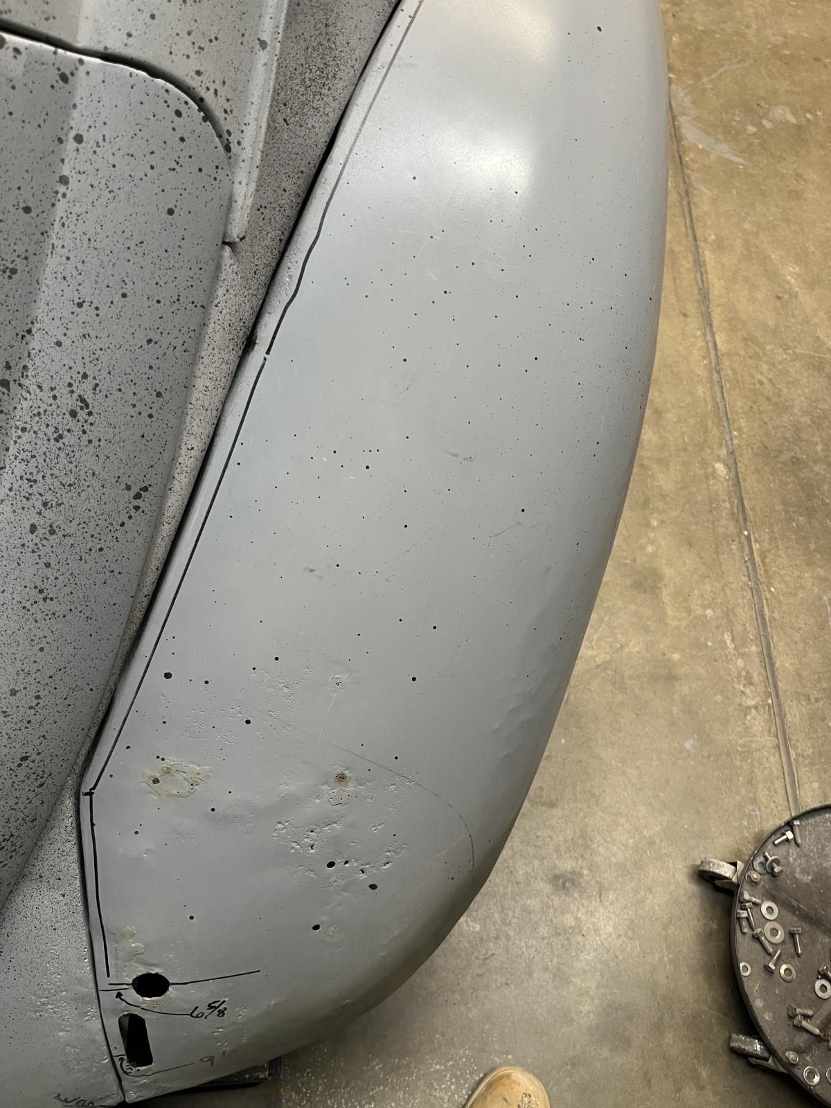

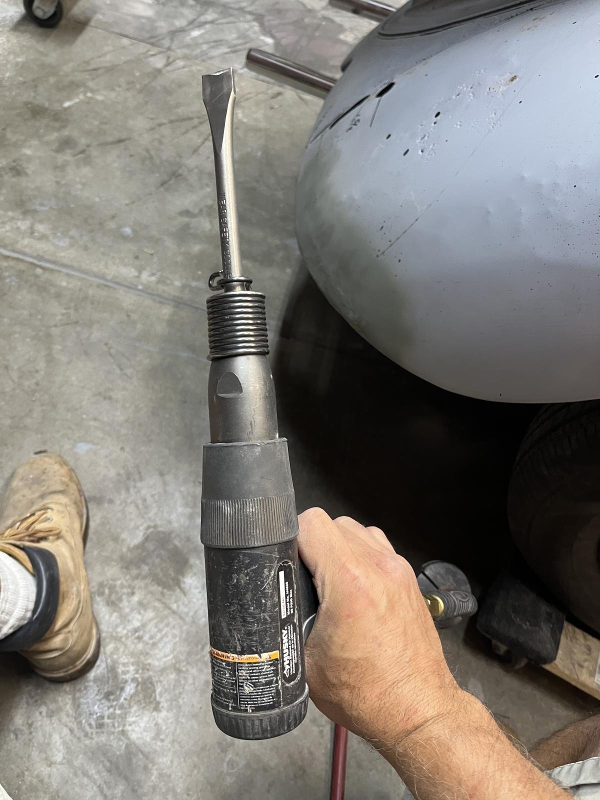

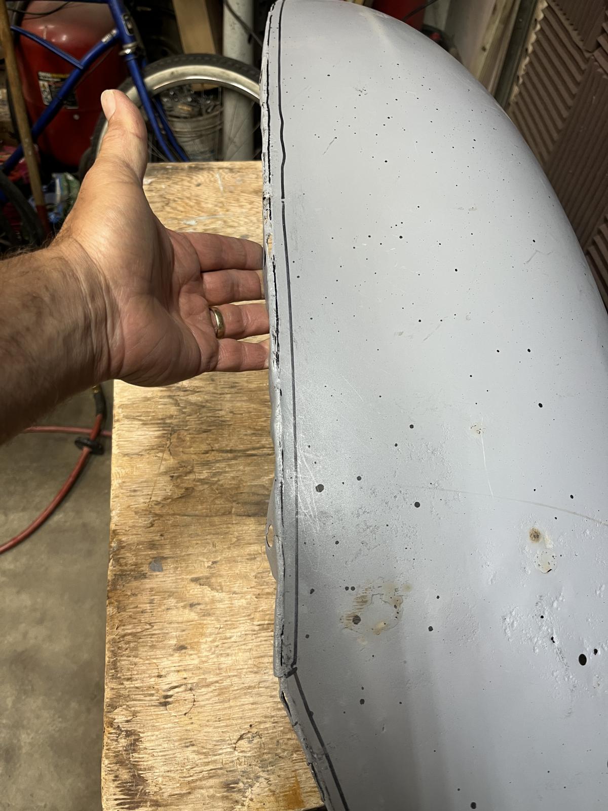

Got me in several more great hours over the last week! I managed to map out the needed adjustments to the passenger rear fender, to make it passable to my eye. You can see the huge gap between the body and the fender here. If you look really close, you can map out where the fender bolts are and how they have deformed the attachment flange to positively connect with the body! Large areas of the flange are misshaped!
It measures at just under a 1/4 inch at that 60 degree turn where the rear apron and quarter panel meet! 1/4 inch! How? And more importantly, how do I fix it? Let me explain what I did to make it better. Maybe not the best approach, but I think it will suffice. This is a cheap aftermarket fender, installed by the last custodian who repaired the rear scrunch the car received. I am certain the cheapest bidder got the job, or the most expensive one did, but used the cheapest parts they could find! It don't matter none, now. I gets to fix it, utilizing the cheap part they purchased, because, well, I still have a large chunk to spend to get this old Bug on the road. So, lets get this one more step in to the right direction!
I first laid down that black Sharpie line for a reference point. No sense and swinging a hammer, if there is no way to measure what happens after swinging it, right? Part of the issue is that this stamping is poorly stamped. No crisp edge, just rounded over edges. See here?
So, I bolted the fender to the body, as tight as the bolts would go. Then with my long prybar, I slipped it over the tire and up against the inside corner and hit the opposite end with my 32 ounce hammer, HARD! Leaving this wreckage in it's wake!
Not too much damage, but not enough movement. So, let us get a bigger hammer!
That is going to work so nice and my tennis elbow will not flare up! I ground down the chisel point to try and keep the steel from tearing too badly.
Then I slipped that in past the tire. A little bit tricky but tottally doable!
And look at the results, in just under a minute!
I then went through another round of hammering to get everything nice and lined up. That 60 degree corner, tore and slipped out of plane, from both hemispheres. So, I had to do some tweaking on it, read that as hammer and dolly, to line it back up and in line with the rest of the fender!

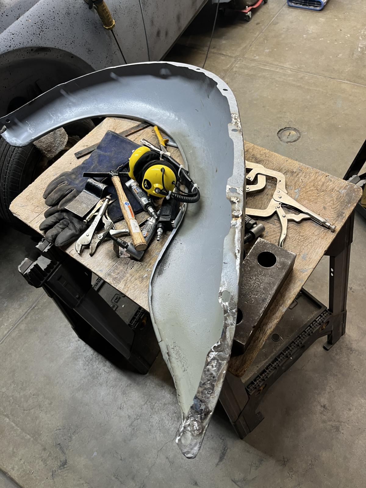

Now that everything is where it should be in relation to everything else, I removed the fender from the body to repair the roughed in shape.
I drew a new line onto the fender. It signifies the correct bend for the fender. I need to make sure this bend looks the part!
And so I did! A few hours with a hammer and dolly and I have it! Lets get it back on the body to check it.
OKAY! That looks great! Lets weld it all up, the tears, the 60 degree corner, the end, the missing steel from the flange, the rusted out steel, the worn out steel! Oh, wait, that would just mean a new fender. Lets just weld where it needs to be welded.
Slipped in the copper spoon, behind a hole that split wide open. Had to loosen the fender to get it in there, then tighten it back down. The tear was across the entire flange and up on the visible portion of the fender.
Cleaned up the are4a preparing it to be welded.
Welded that together while on the car so that the fender would retain its shape after removal. I then removed the fender for the remaining areas.
All welded up and ground down.
And back on the car to check out everything! I had to stick the tail light housings on to just remember what I was working so hard for! Looks great to me! Anything look off to anyone?
Until next time!
Jimbo

Is there a reason you are rehabbing a really beat up fender that is not correct for the car? Seems like purchasing a set of replacements that are at least built correctly would be a better use of your hard-earned time in the shop. You would have a much better set of fenders and be able to spend time on other parts of the car. WW sells a good set that are pretty well made... pricey but worth the time saving.
Other than that, carry on! It's nice to see it coming together. I struggle with my obsession with perfection and get pretty discouraged some days when things don't fit correctly (fighting the hood at the moment).
