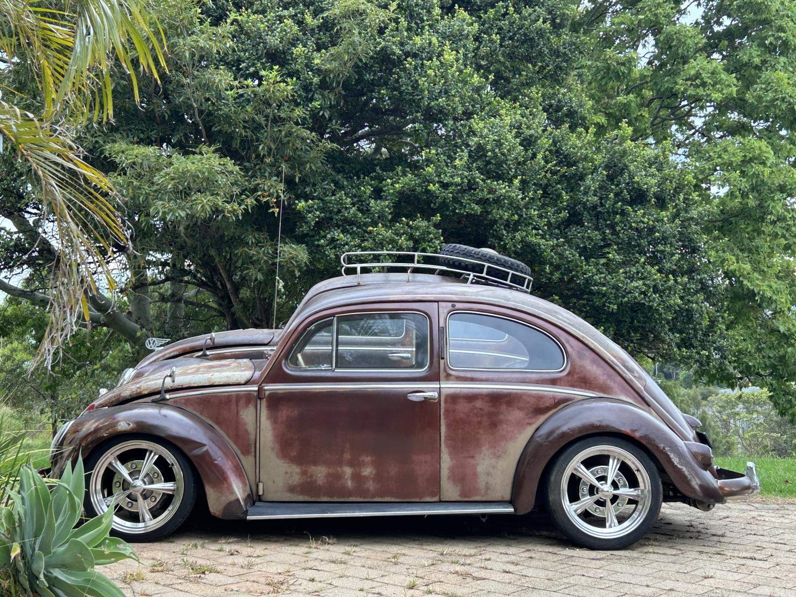

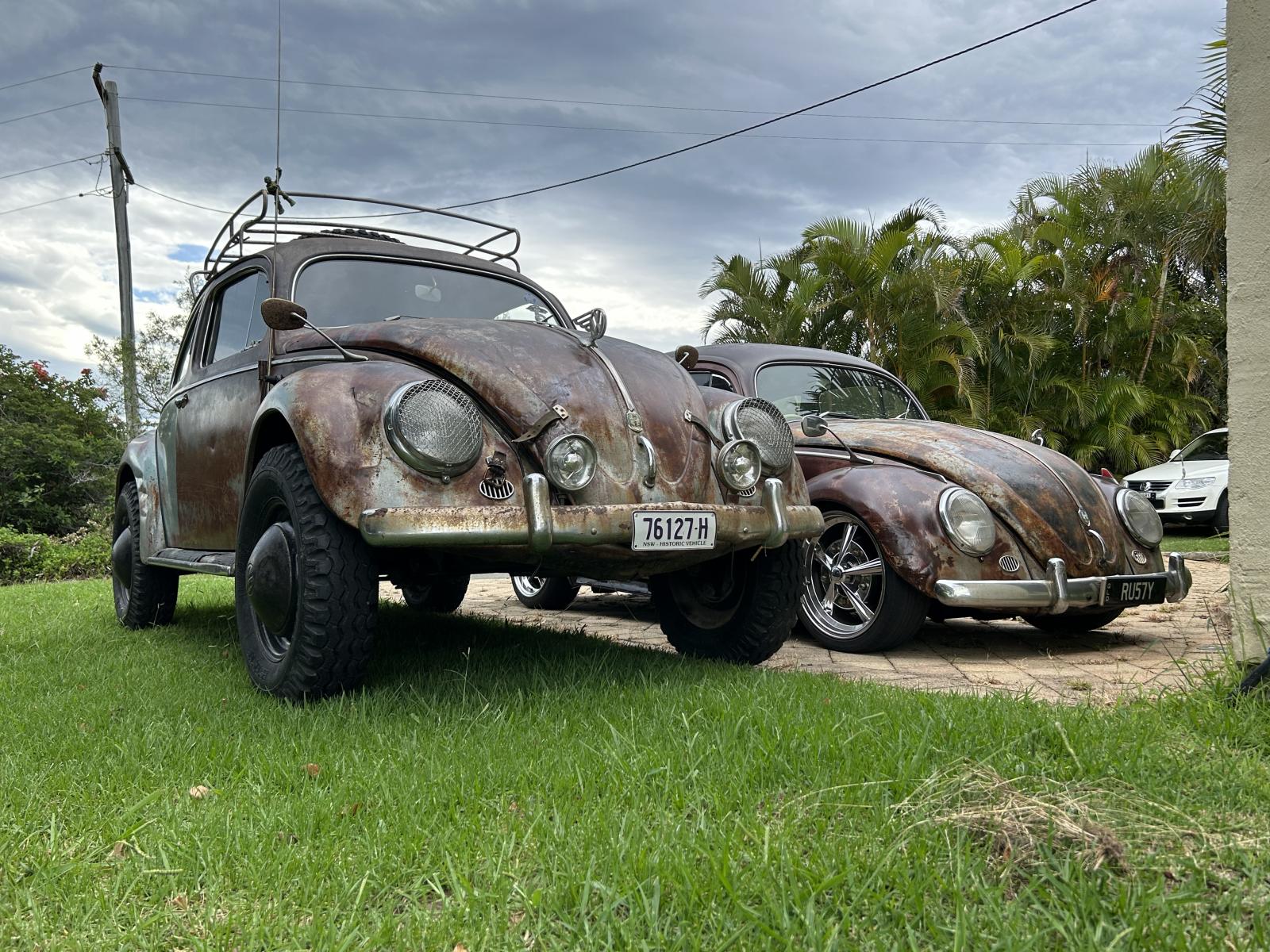

Been years since an update.
The 1200 in it wasn’t up to scratch. A random engine guy rebuilt it with twin carbs and huge valve springs and a bunch of other bits that didn’t work together. So it was working hard against itself, as well as put together with silicone, so the oil flow stopped, and bearings stopped things from spinning.
Had a SP 1600 sitting around, checked it out and was still good internally. Got a 1640 kit, had some higher comp heads rebuilt and put back together. Torquey as hell and pulls hard. Kept it simple to keep any problems to a minimal. Still stoked how it turned out!
Couple of pics.

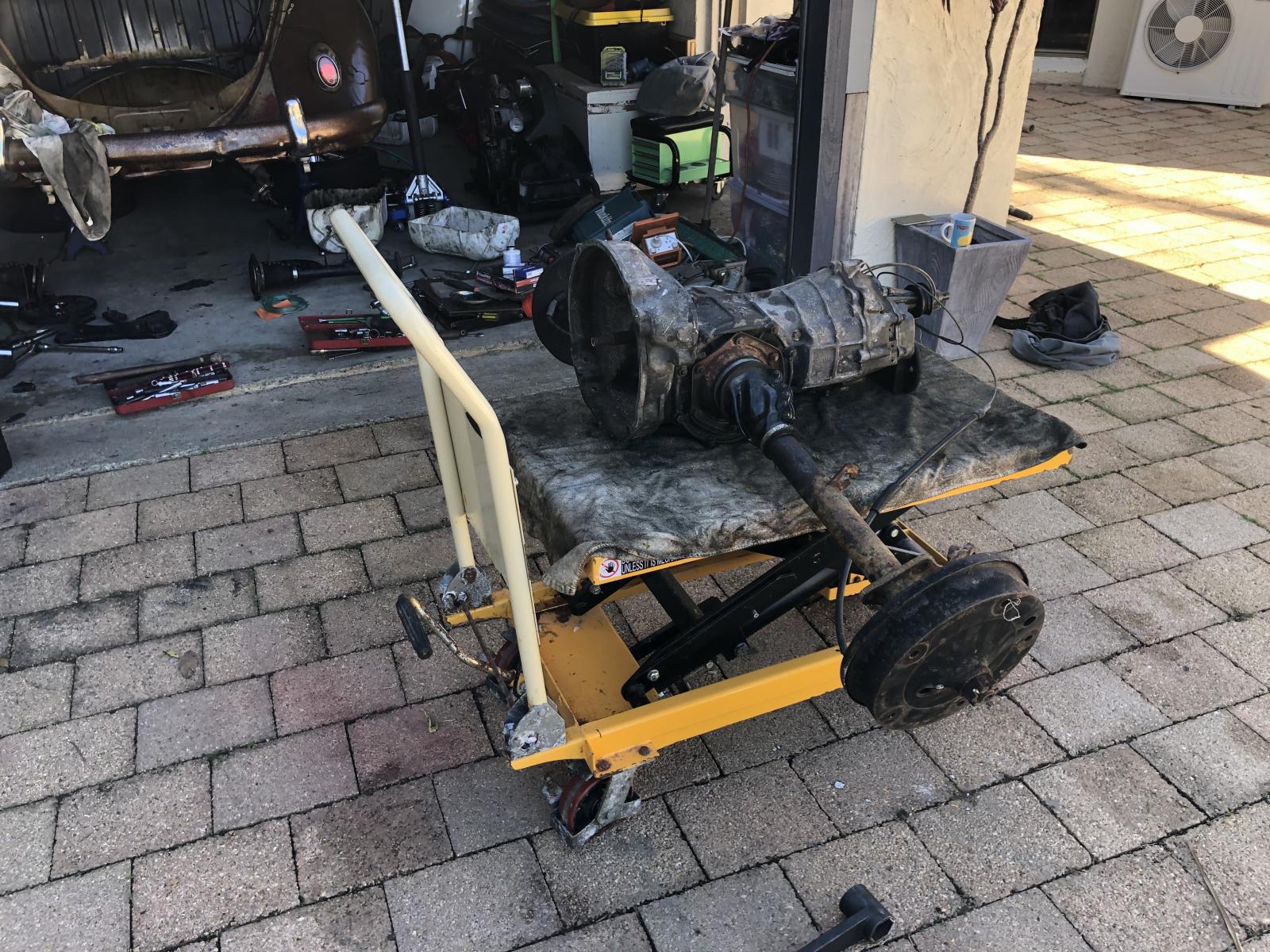

Fast forward year’s again. I get a call from him saying “I’ve done something bad, I think I broke it” so down it came and it turns out the fulcrum plates and axles were worn, and he tried to roll start in reverse, it bound up an snapped an axle..
So it all had to come out now. Dammit.. I grabbed the 1500 box that was in my oval for a while that was ok from memory, that will now be the donor box for it again…
Just waiting on new seals and bits to get it back together with.

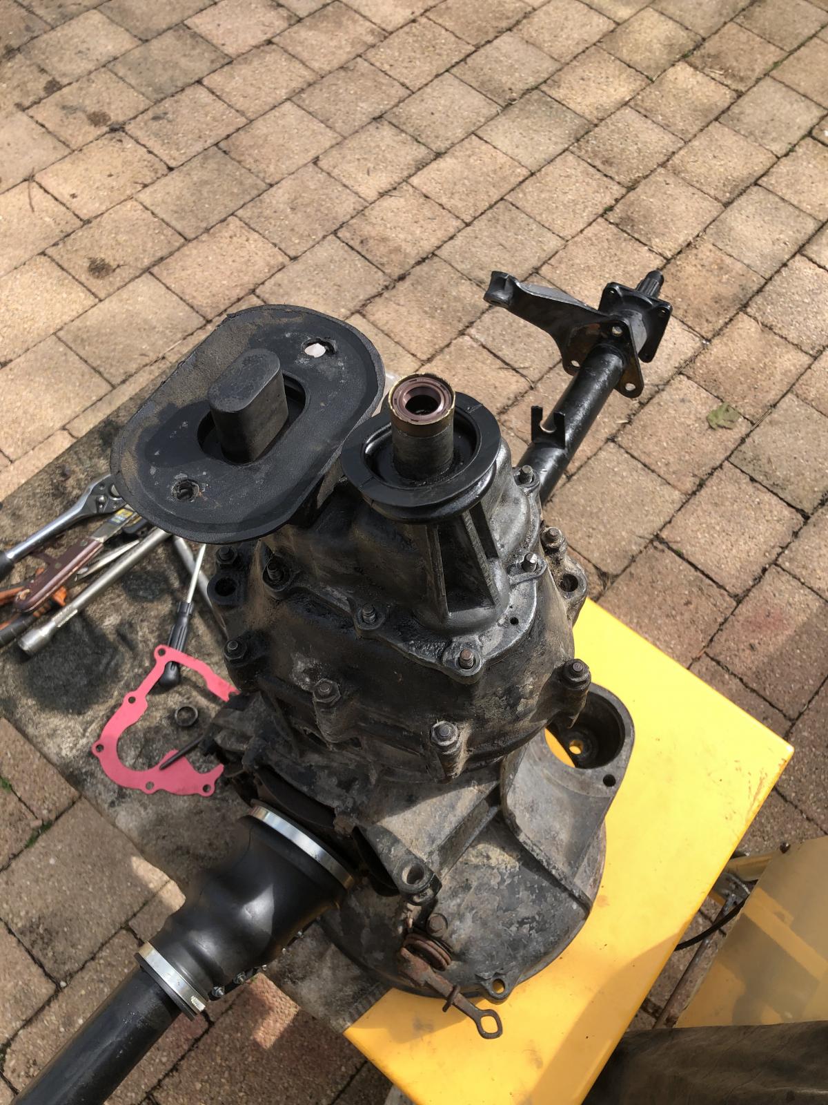

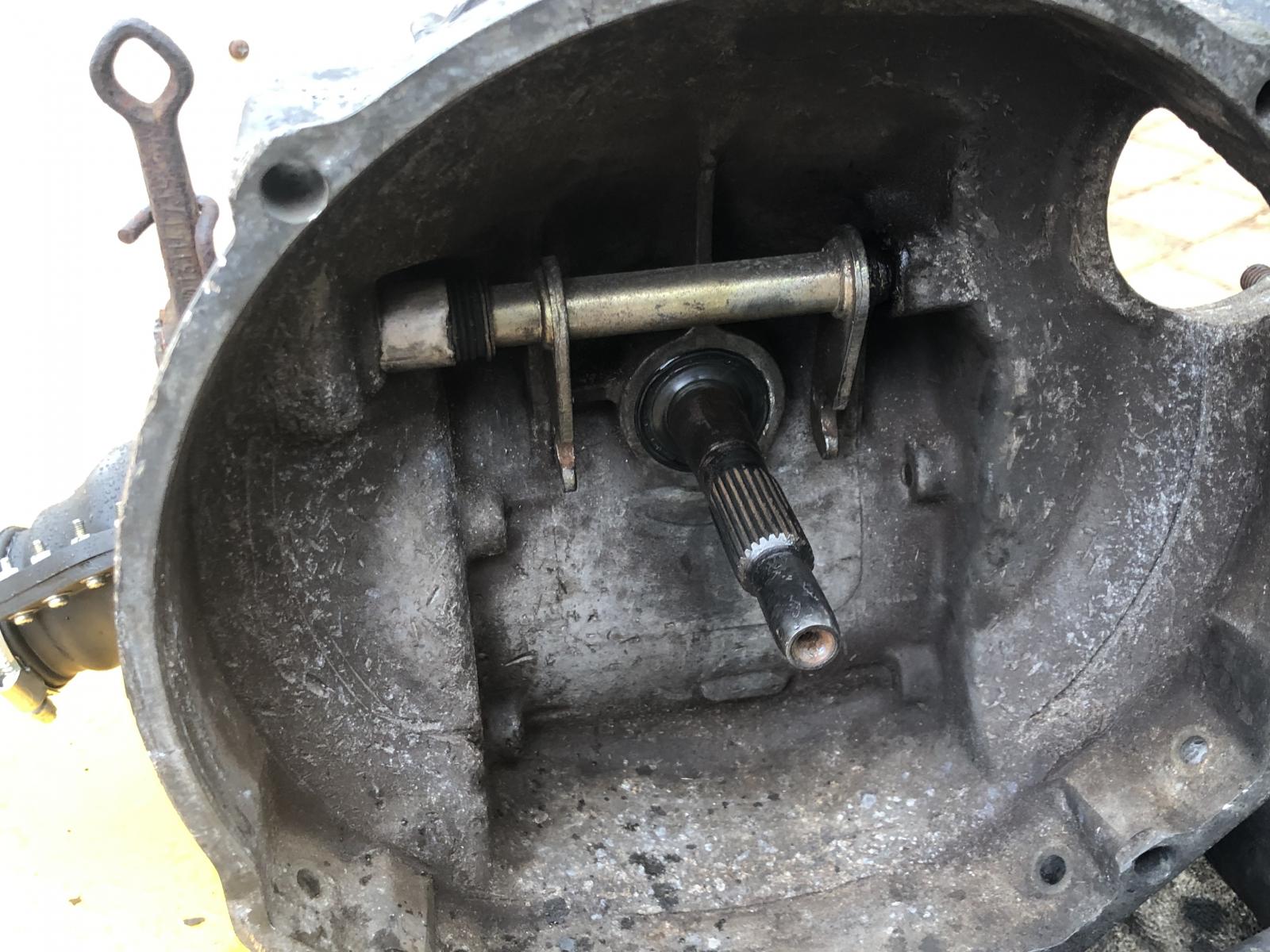

PostPosted: Mon Aug 15, 2022 11:57 pm    Post subject: Re: rhd 57 "ba baracus" Reply with quote

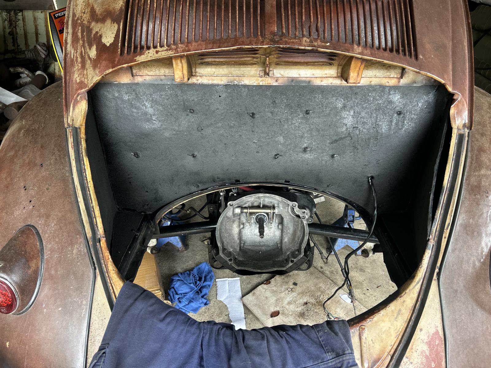

Game changer…
Work was throwing out a 500kg ram lift trolley, so I liberated it from its demise!!
What a difference that makes! No crouching and back problems anymore. So good!!
Fulcrums and axles are good, oil on them makes them look worse than they are. only a little wear and tear overall which is nice.
New seals for front and rear, new housing seal and axle plate seals, wasnt too impressed with the axle seals tho, no choice in thickness in the kit. So 2 were too many, and one is a little tight..
Bearing in and box installed, but just loosely to get it aligned up correctly.

PostPosted: Tue Aug 16, 2022 9:44 pm    Post subject: Re: rhd 57 "ba baracus" Reply with quote
Box all bolted in, brakes and hubs on so I can move the car out and start on the motor soon.
You forget how low/high cars are.. haha

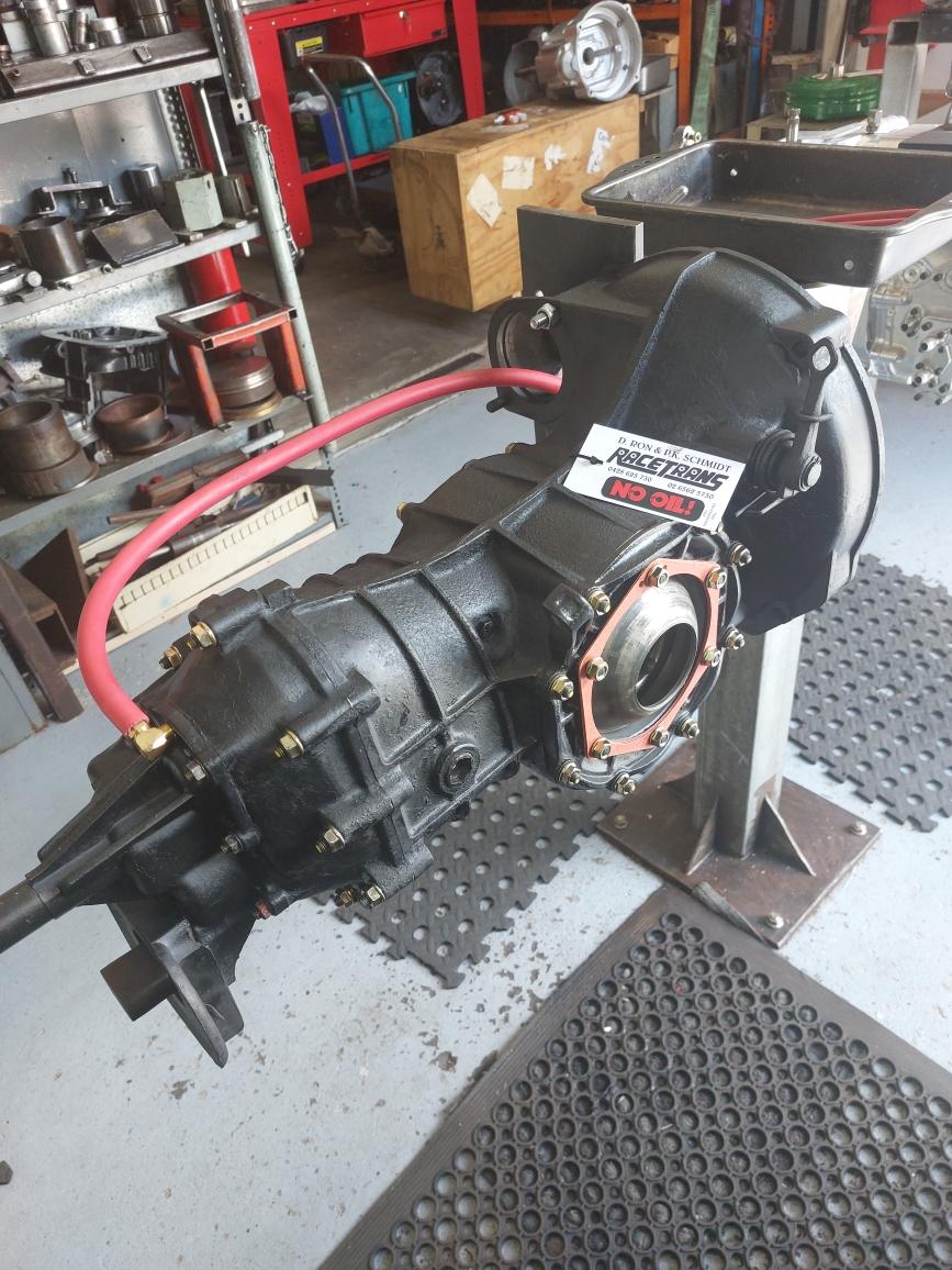

The mechanic he used up north said the box was shot an dropped all its oil. So he wanted it rebuilt, I know a wizard so we got it done!
Replaced all bearings/seals/synchros/3&4 gear, selectors and reverse selector.
One synchro was shot! Apart from that and the worn reverse selector, the box was actually ok, but he wanted upgrades so no problems!

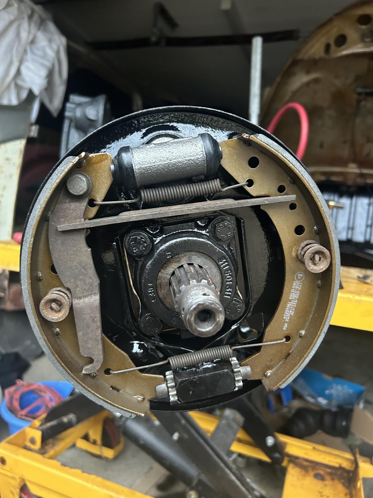

Brake upgrade also, later backing plates and bigger shoes/drums.

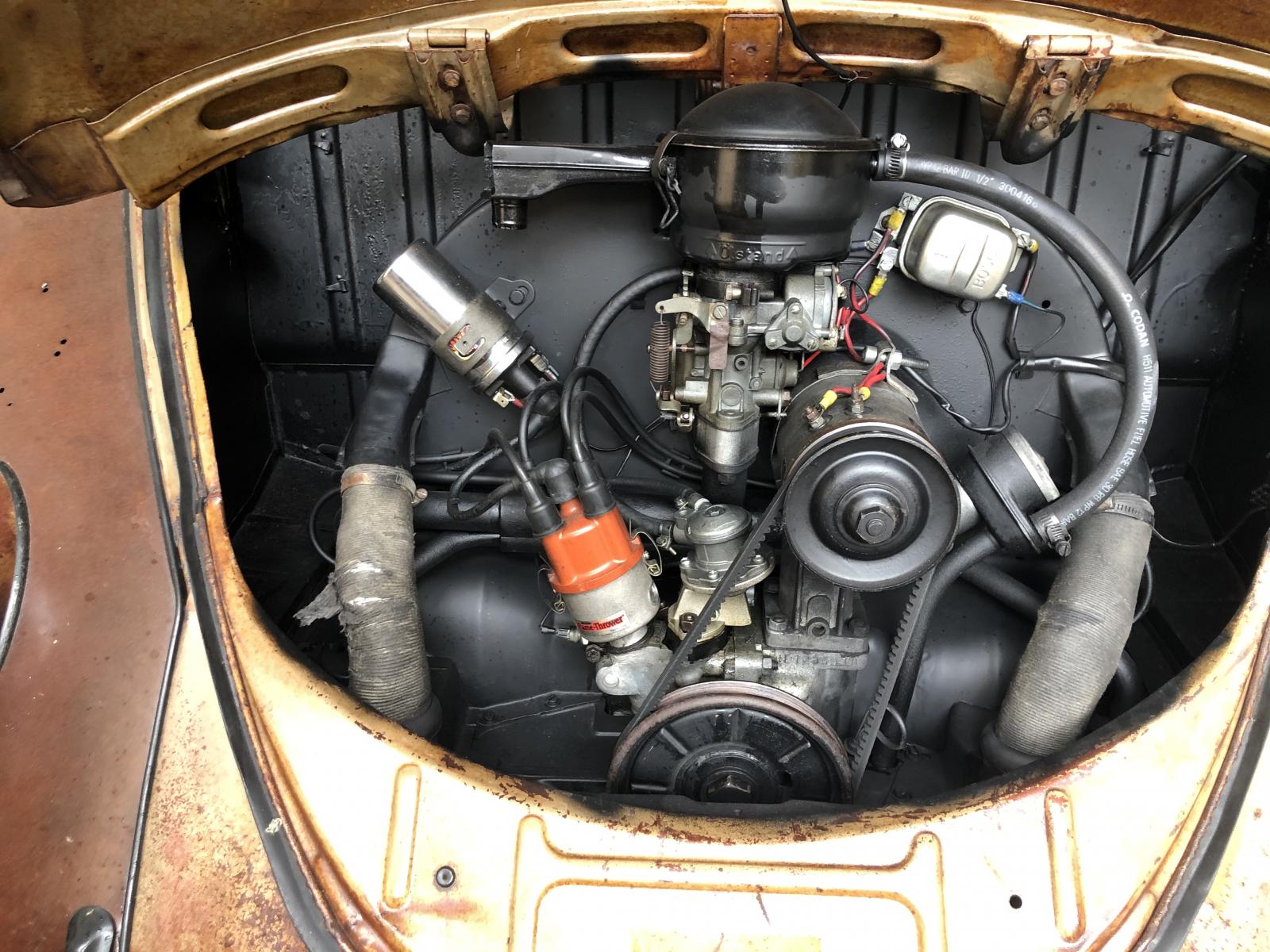

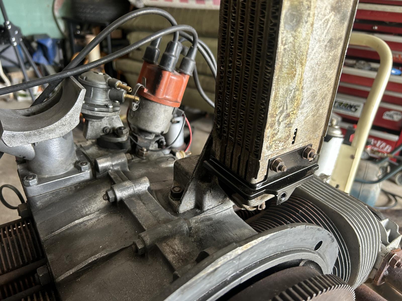

Bit of an engine bay freshing up also. Clean.

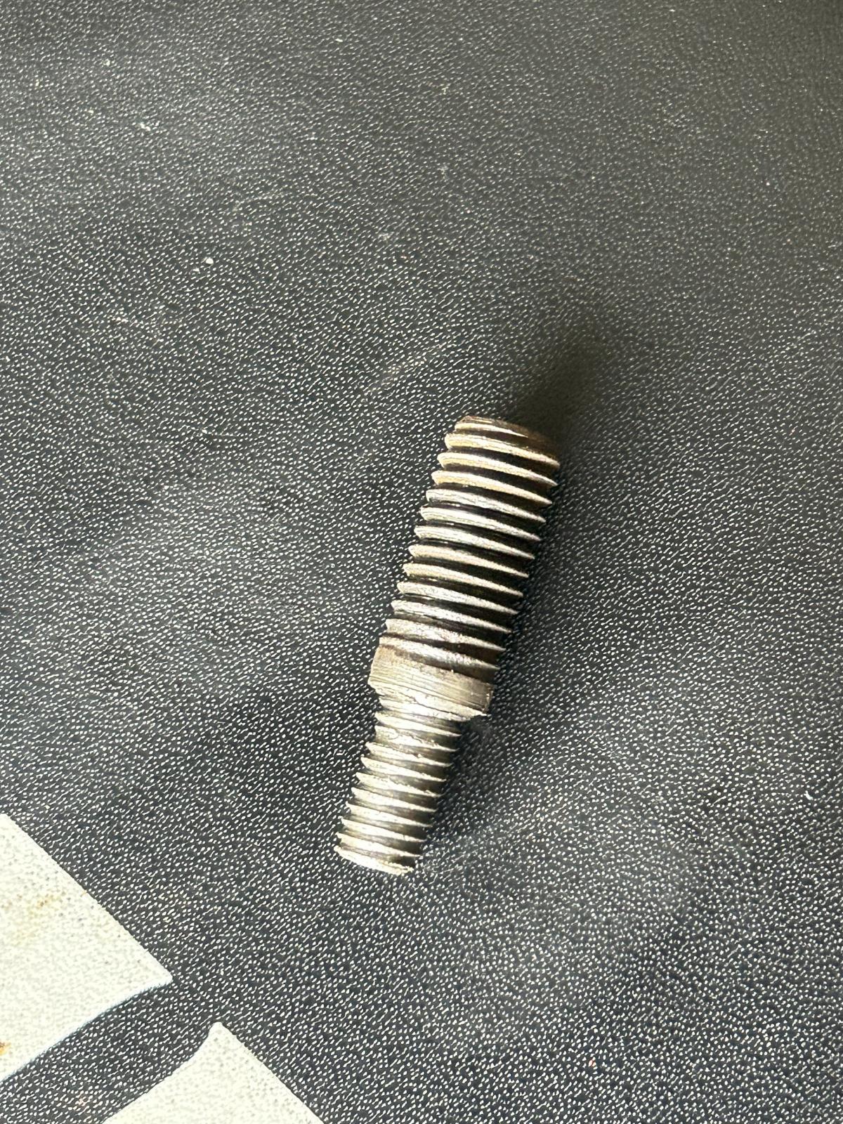

Updates the motor bits also, couldn’t find a stud to match so made one for the doghouse upgrade
Had to make a tool to tighten the intakes properly
Much better now!
