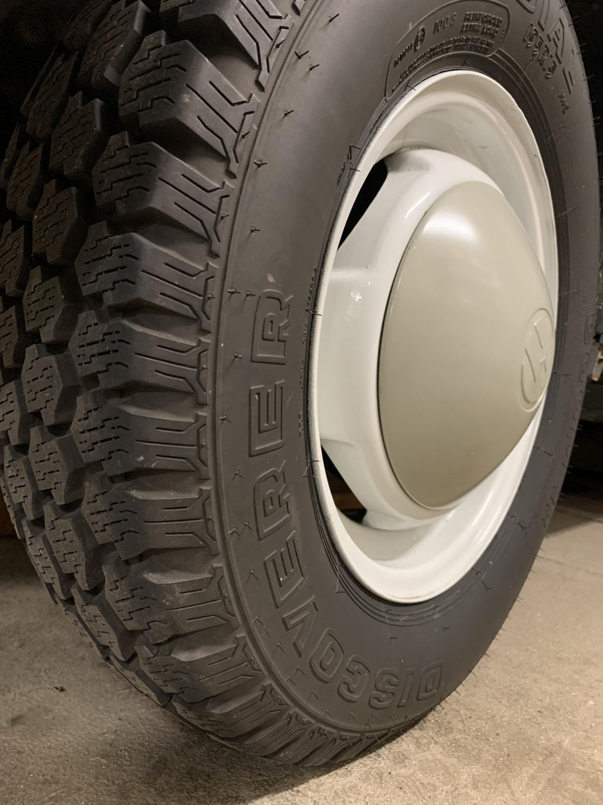

'58 Single Cab wrote:
I might as well contribute in trying to keep this thread up to date. My Cooper Discoverers in 195R15 are way past due for replacing (44th week, 2006 date code). They have been an excellent tire in that they took me everywhere and never let me down.
What is the full tire code for your Coopers? Thx
These have been NLA for many years now. Great tires, just can't get 'em anymore.

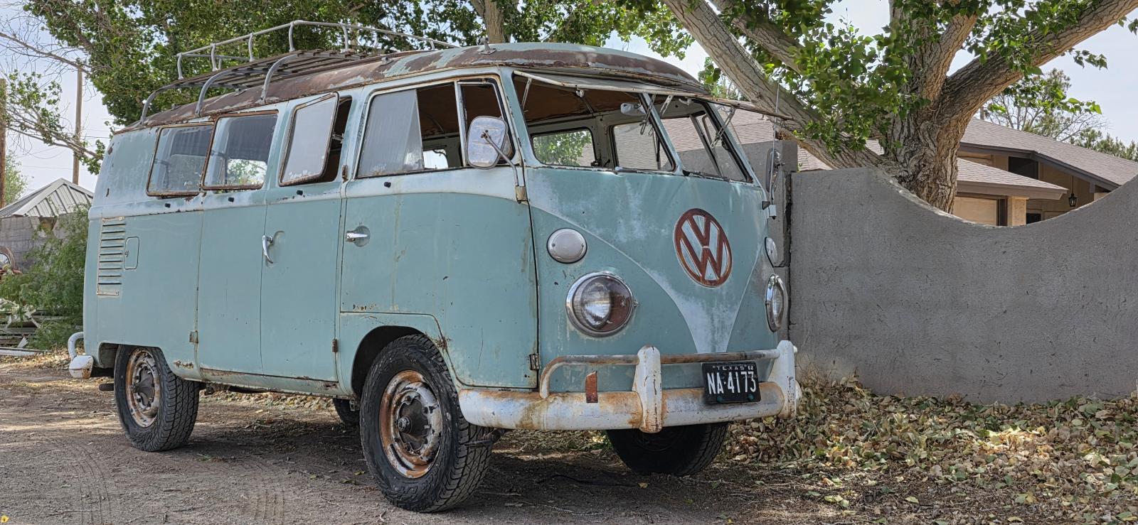

Will a 215 75 R15 fit my 62? It seems like all the 205s are trailer tires. Everything else has a low load rating. Although it seems like 1500+ is a bit much for each tire. But I do plan on towing a trailer with it and loading it up so I am aiming higher.
215 will not fit in the early flat wheel wells without a lot of fighting to get in and out.
Suggest checking out the 195R15 tire size that are both narrower and taller due to 82% aspect ratio, than the 205/75 size. Plus only about 2.5mm smaller diameter from the 215/75R15.
https://simpletire.com/tire-sizes/195r15
205/75 work well for the front axle due to being pretty darned close to the stock diameter so the speedo/odometer read as correctly as possible.
A few choices in the 205/75 that are not trailer tires here:
https://simpletire.com/tire-sizes/205-75-15

So I tried them anyways. Since they are the smallest LT tire I could find. You are correct about fighting to get the rears in. But it's still easier than my lowered bay.

ento wrote:
Love the look of your bus. It deserves its own thread.

von hansel beat me to it - in fact, I like the look w/out hubcaps even more. Bus looks up for anything. Show us some background!

von_hansel wrote:
I will start one here soon. Now that I have actually taken it out
I don't usually like the no hubcap look but you are right it looks good on this one.
What do you mean by background?
Pics when purchased, what you've done, etc. The normal 'build' stuff. But make it more interesting than my "30 pics of something well-documented by others elsewhere" posts. :)
