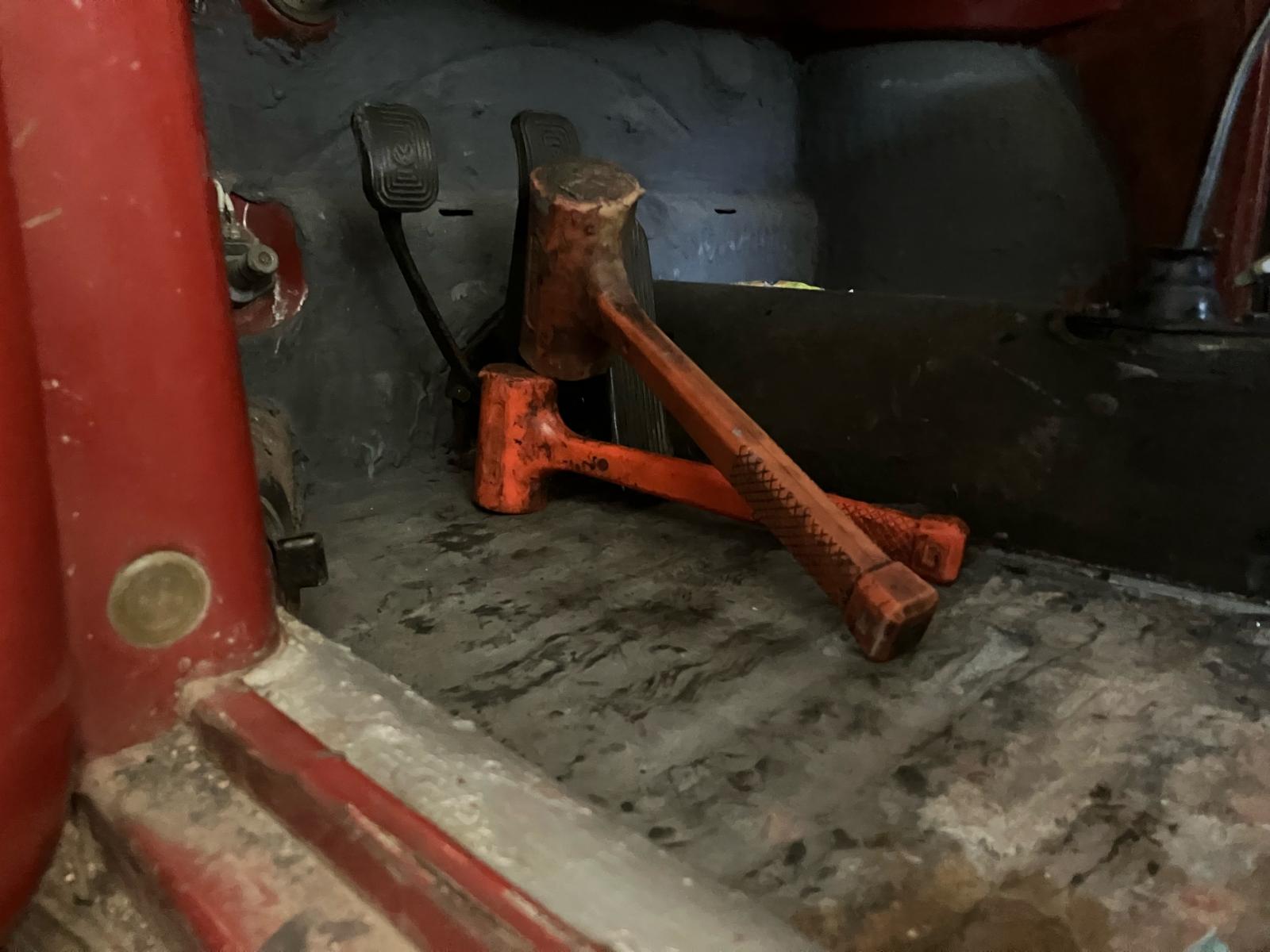

How did your floor get beat all to hell?
Worst floor I've ever seen. Shocked

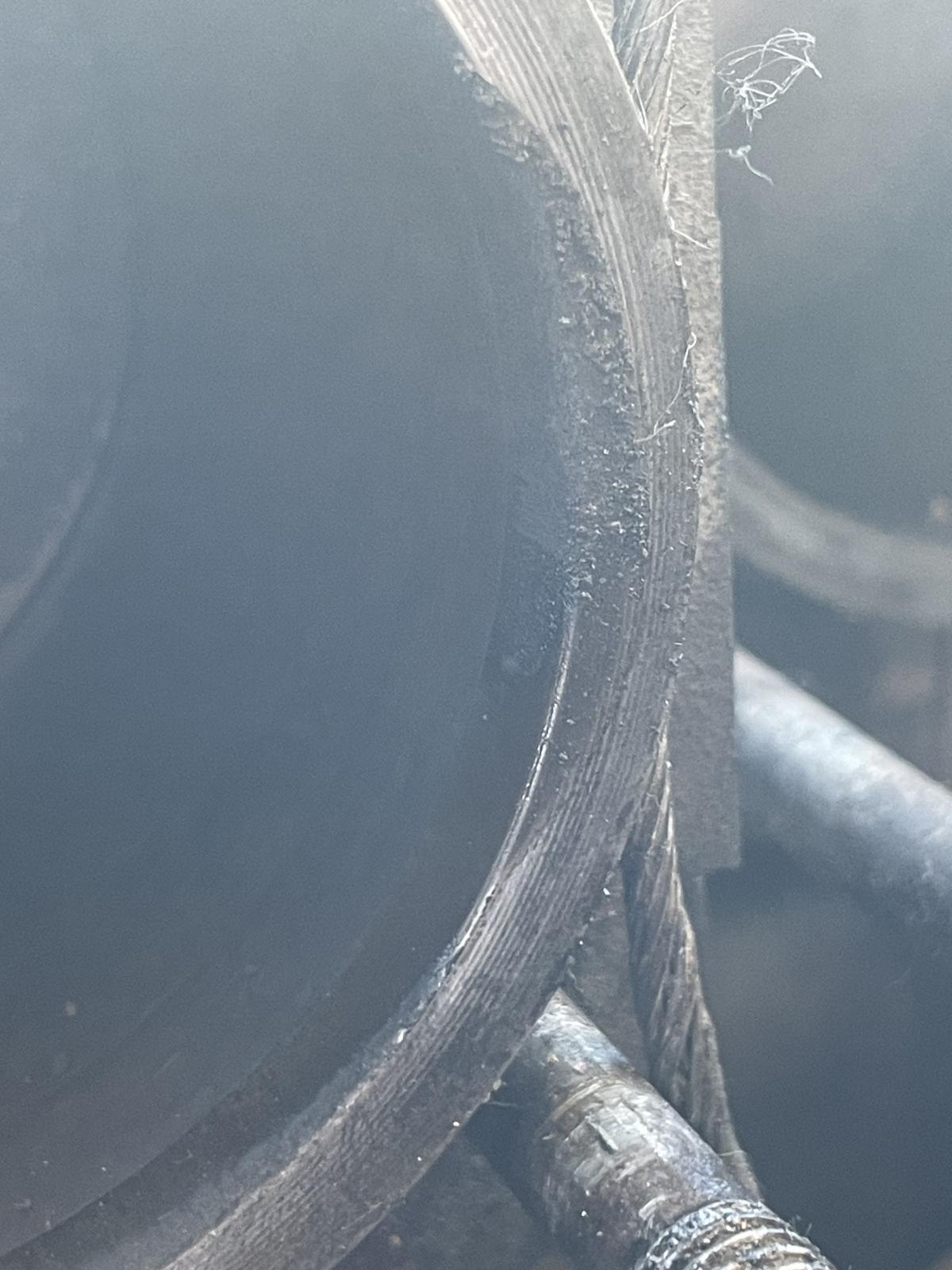

Since previous initial oil changed recorded in this short thread, I have done two additional oil changes and been adjusting valves every 100 miles, which amounts to one week. Everything is seeming fine and have absolute confidence, worse case, I have some tools, and all else fails, I have AAA Plus.
Number two cylinder was burning oil, nothing apparent in the exhaust after the 30 minute initial break in, now seems to be okay. Keep in mind these cylinders were bought as mildly used about 20 years ago and acquired shelf corrosion, requiring a lot of honing (hindsight should have bought new but was tired of the delays and warm garage). Will keep an eye on the spark plugs of course.
What you are seeing is a floor painted with a radiant barrier paint, which refuses to go on smooth especially with the rust prevention paint below brushed on; once the layer of sound deadening is applied and sisal over top, no one will know. Fantastic product, does a great job, and somewhere in this thread actual data is provided.

The floor is 'small potatoes' in comparison to the fact that you have a running/driving car again! Cool
Exactly why done nothing with the exterior or interior, just need Ruby to be drivable and safe. Funny is several folks not sure what color to call her, one decided multi colored. Laughing

2) I tried doing a compression test, the gauge was leaking on the forward cylinders, ignored my Service Dog alerting, and had a small Autistic meltdown (not been taking care of myself) resulting in loss of the gauge. However, got a logical reading on number two of 120PSI, so seems avoided a situation and compression has significantly increased.
3) There is a rod knock on number two cylinder. Figure run it until doesn't run anymore, hopefully after have a spare engine built. I am of course open to changing my mind.

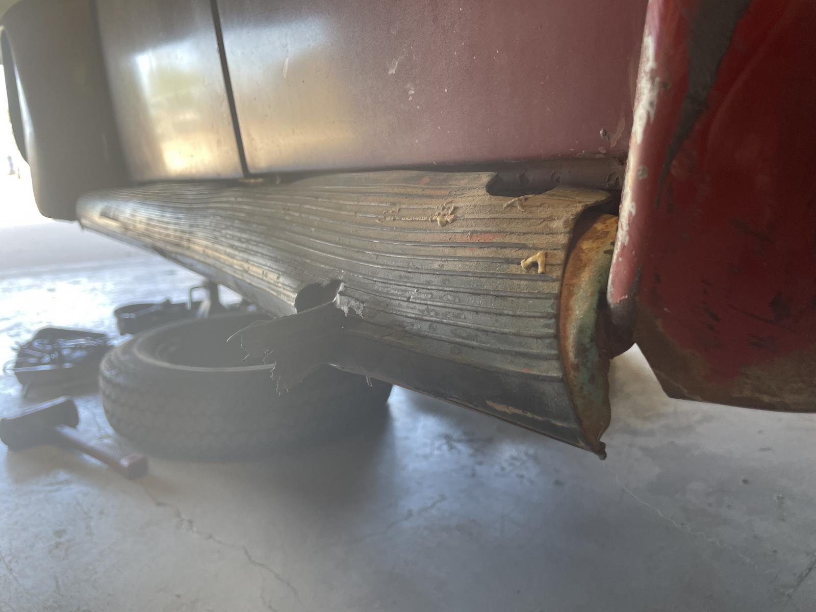

Early April, coming home from a local classic vehicle meet, I was involved in a road rage situation and now looking for a a passenger door, running board, and rear left fender; as for the bumper just twisted it back up enough so not dragging when pull into even shallow driveways.
Apparently don't have a useful picture of the door, oops.

Engine put up a bit of a fight getting out, the top nuts and bolts are real fun to get out especially with the dog house setup.
Found the source of the noise.
Confirmed this by pulling all the jugs off and checking for play in the connecting rods. Amused that all were tight, spent a morning rebuilding a set of connecting rods. Oh well, probably good to have a spare set on hand.
I also had a local come an hour drive and help set end play, due to a language barrier easier for him to come out and do it himself rather then explain.
Since the jugs were off, decided to lower the compression as had wanted to do for a while. With finances tight, got a Costco membership for dog food and found the fuel to be significantly less. However, don't have 89 octane so that meant buying 92 octane, and with 21MPG, that was taking a big bite out of my income (do about 300 to 400 miles in a month). Measured the deck height while waiting for the spacers to arrive, with 0,04", give 7,3:1 compression, 0,3 more than stock though still Volkswagen's recommendation for low octane (located in "Without Guesswork").
