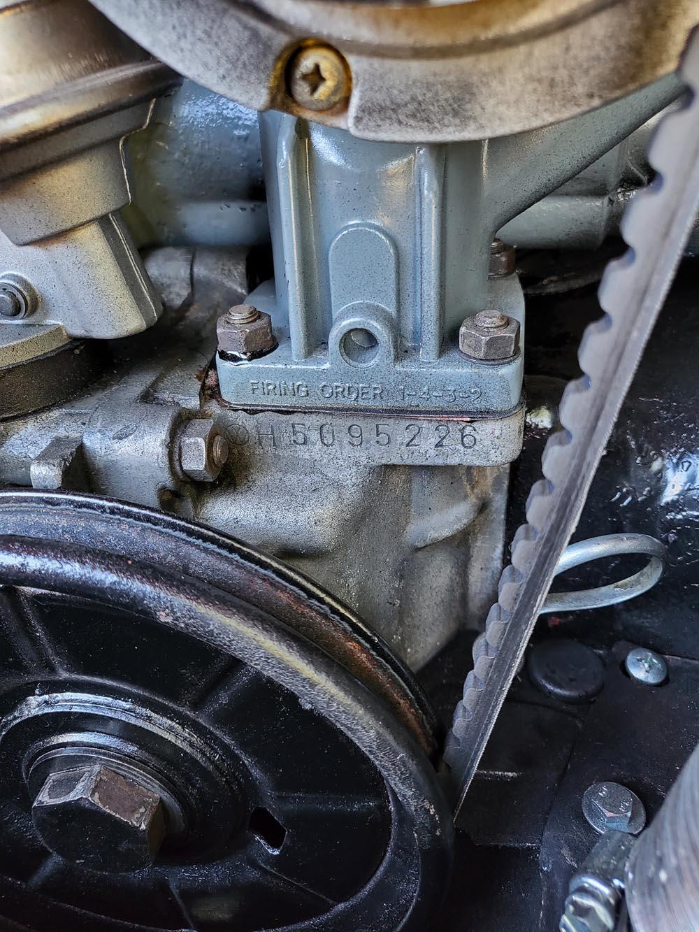

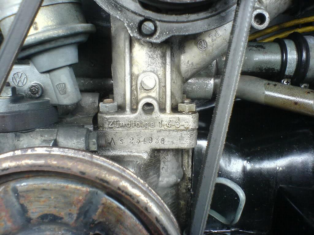

since this is a type 1 engine it should be easy to find TDC. The crankshaft rotates twice for every time the cam rotates once. If you are on TDC of #1, going backwards 180 degrees will put you on #2, going backwards another 180 degrees will put you on #3, and another 180 will put you on #4. Another 180 will take you back to #1. Thus the crank will have rotated twice and the cam once. If you go in the same direction the engine spins when it runs then the TDC at compression firing order every 180 degrees will be 1 - 4 - 3 - 2, which should be stamped on the original generator stand in German, or if a replacement alternator stand probably in English. Photos from gallery.
