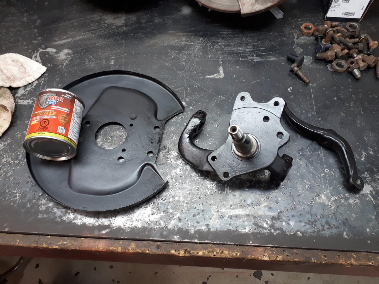

I just love the finish I get with POR15. Super hard, just the right gloss and easy to apply.

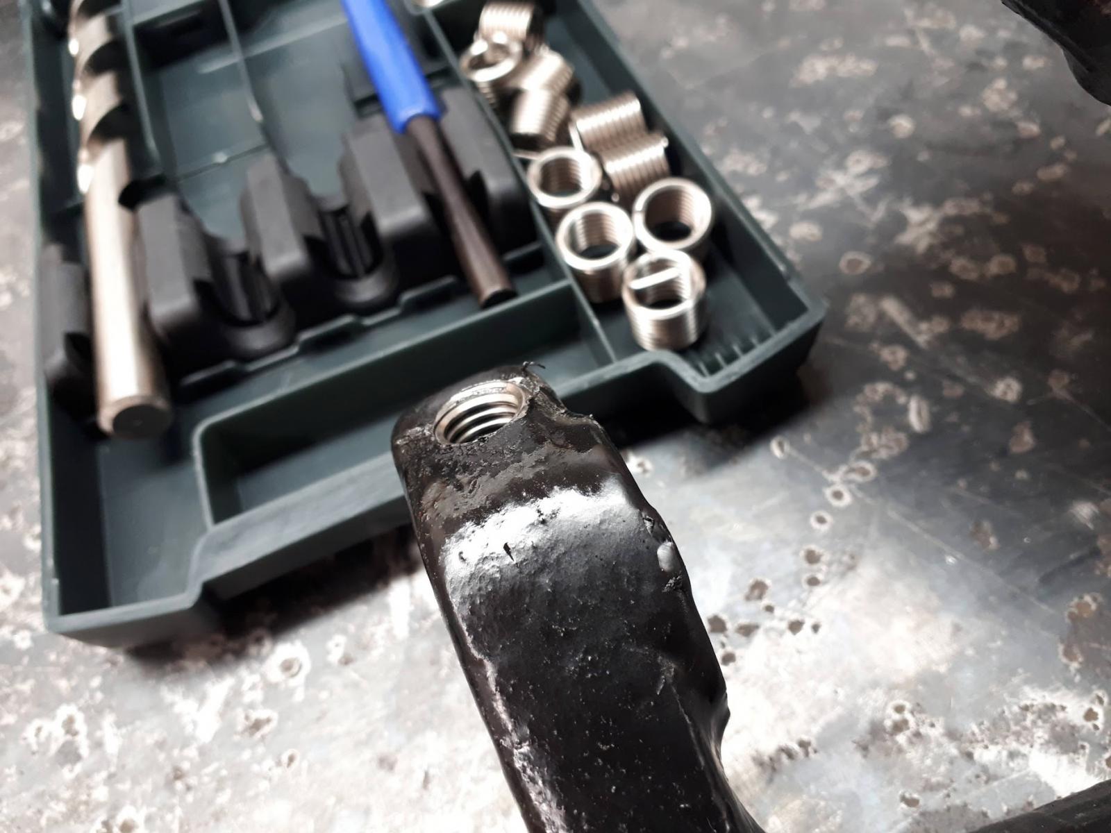

I bought a heli-coil repair kit and repaired the threads on the bolt I had to drill out.
And now unexpected difficulties installing the steering knuckles. It turns out to be not easy like king and link pin.
I will invite one of my girlfriends over to lean on the pry bar while I bolt things together. Hopefully she can do this without killing herself.

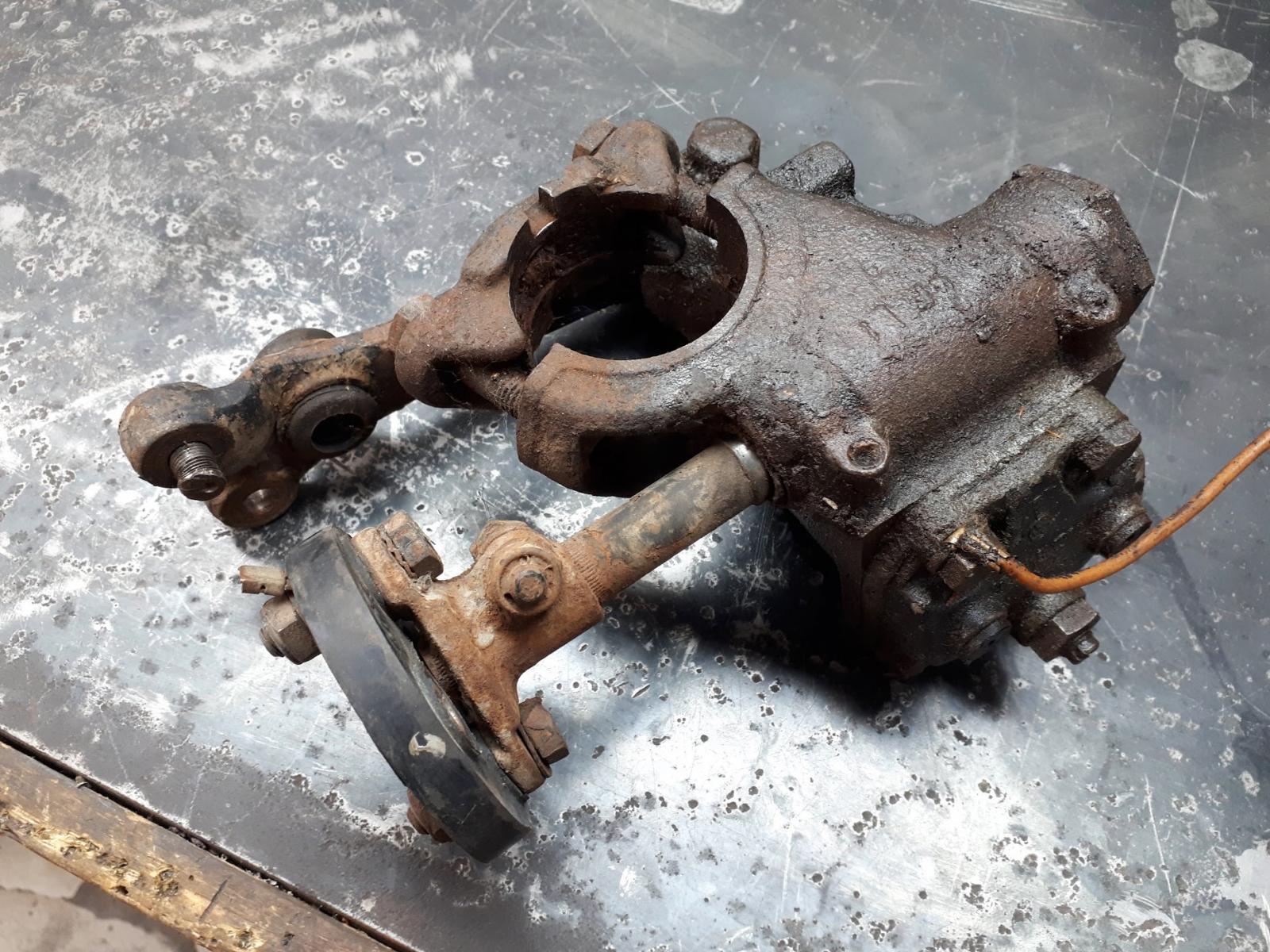

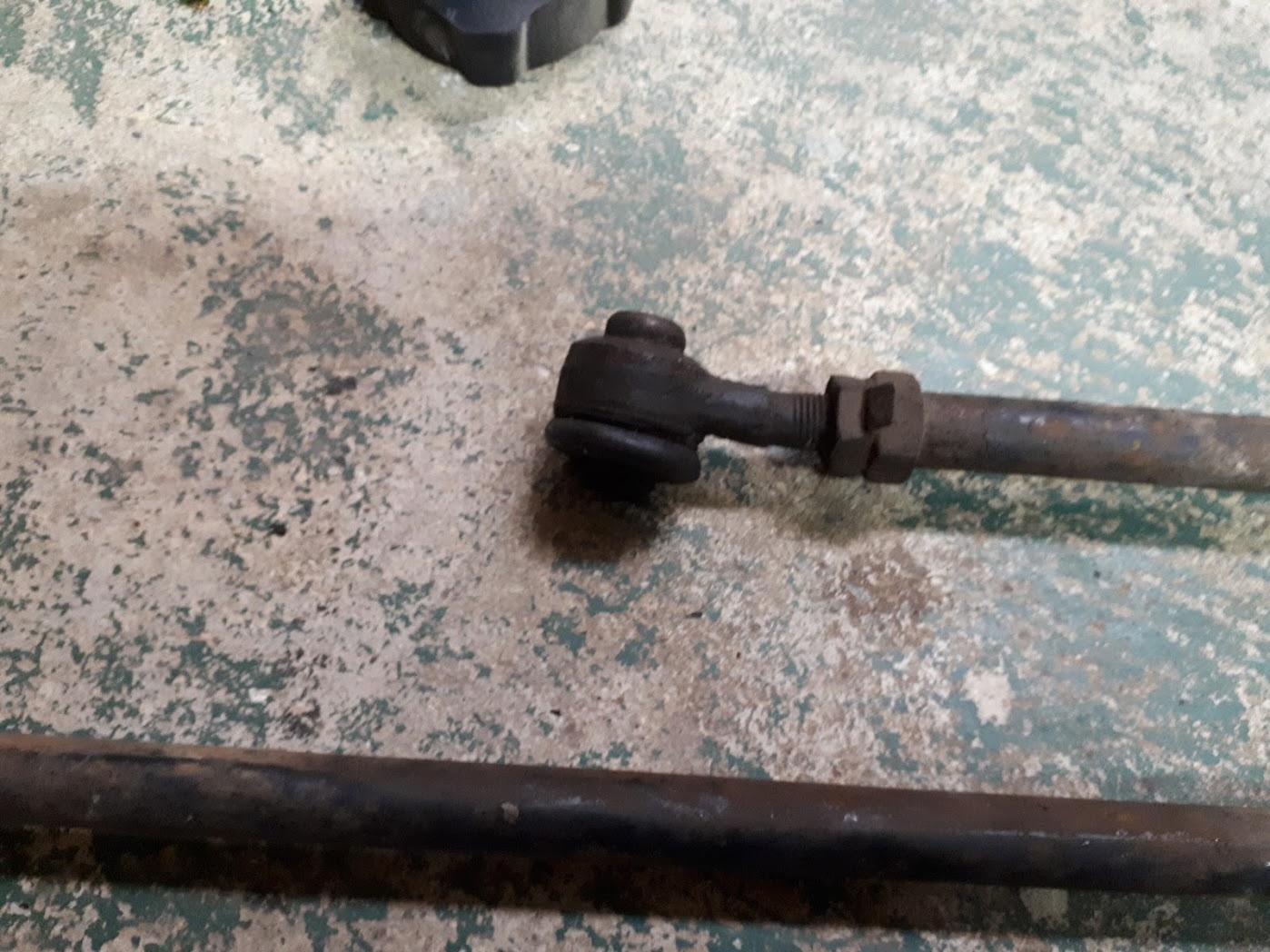

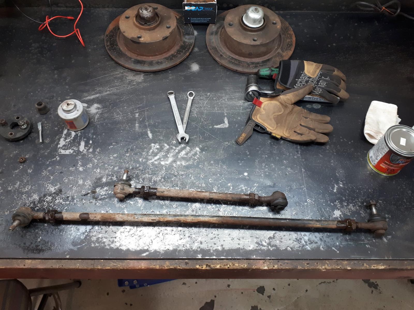

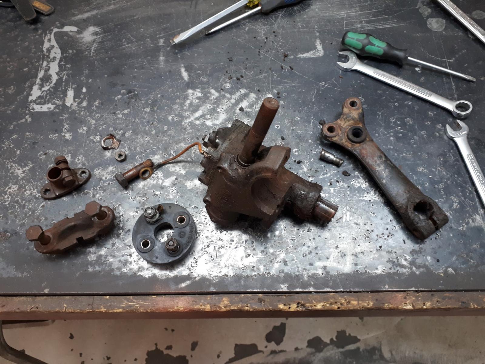

I'll start digging into this:
DPO strikes again
So now I have to buy new tie rod ends.
All dismantled waiting to go into the solvent bath.
Then media blasting and POR 15 to make it pretty
Don
Better and better mistakes!

That's the special 9* bent left inner tie rod end. I can't remember if it's left hand thread into the rod or not, as it's been a while since I've done tie rod ends on my own cars. That one can be hard to find sometimes. The rest are the same as a bug.
Bob 65 Notch S with Sunroof
The one I took out was right hand thread. I ordered 2 rights and 2 lefts. This better work.

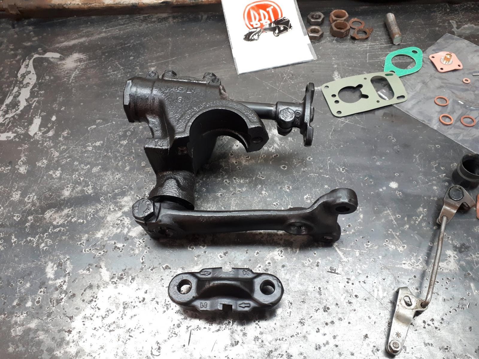

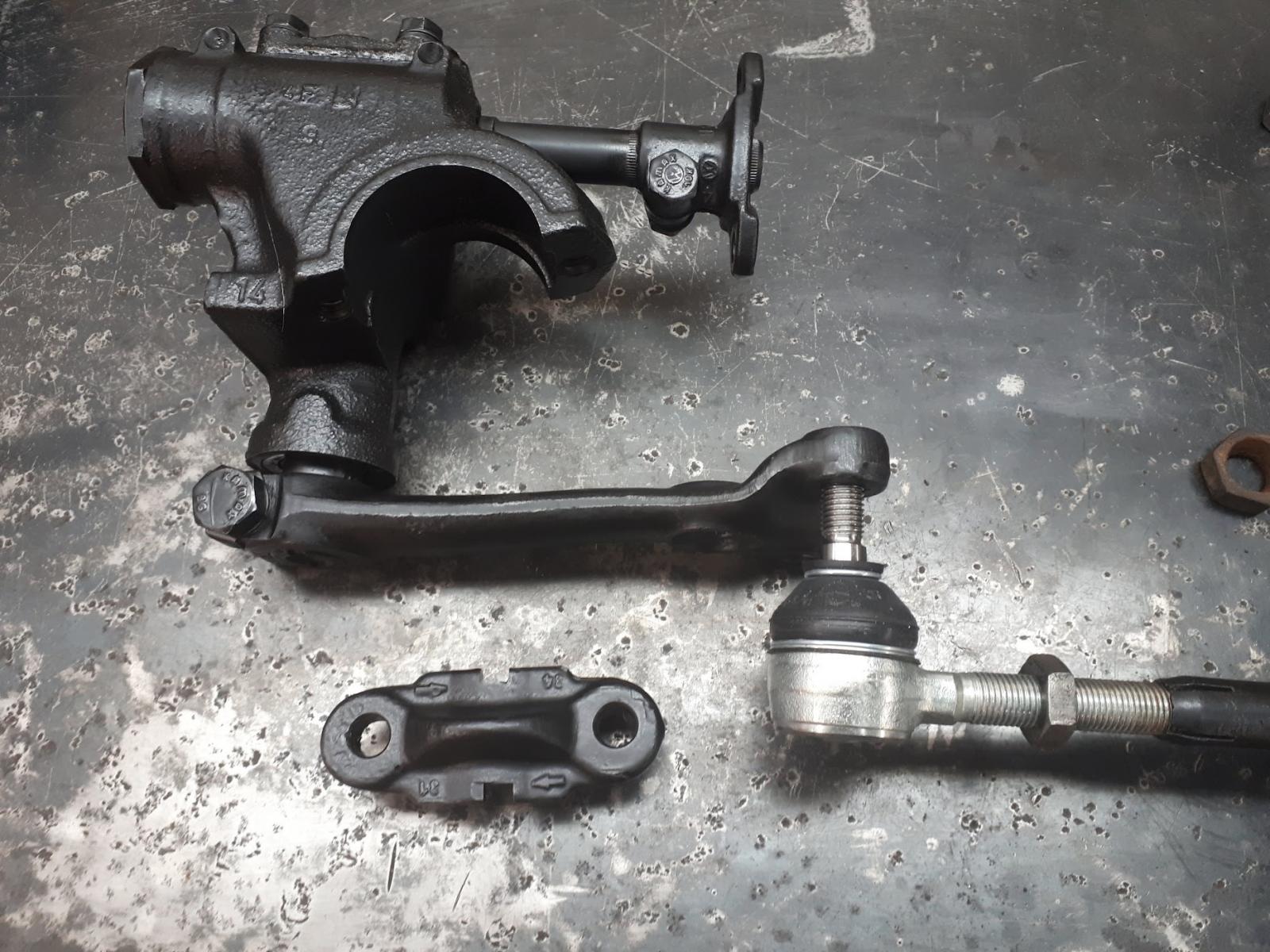

Wow, that turned out nice
Now just have to wait for the tie rod ends

I bought tie rod ends from CIP1 and they don't even nearly fit
Of course now that I have the wrong ones I look more closely at their website and the ones I ordered don't even mention type 3 even though they are in the type 3 front suspension section. If I go over to the beetle from suspension there are the correct tie rod ends for my car listed under beetle front suspension. I've run into this sort of thing with CIP1 before, they are sloppy in their descriptions and website in general. I spoke to Chris at CIP1 and he agreed the website was confusing and misleading. They will get back to me on Monday with a plan. I actually have confidence it will work out, they have been very accommodating in the past when there have been problems.
