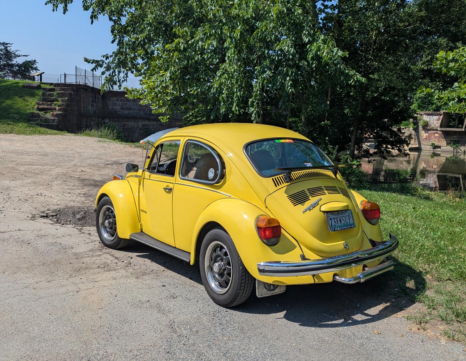

Not quite like I stole it, but it was a nice day for a late afternoon cruise on the GW Parkway. Took Spout Run to the GW, to the Memorial Bridge. I didn't cross over just because the traffic in DC during rush hour would've had me stuck trying to get back into VA. A little long at 4 minutes, but car feels great now that the distributor issue is "resolved."

PostPosted: Sat Jul 05, 2025 10:41 am    Post subject: Re: '73 Super Salvage Project Reply with quote
Finally exorcised the electrical gremlins, great suggestions from many, and Ashman for the game winner. I'd forgotten that I'd removed the diagnostic plug back when I was assembling the car 2019-20 but had left the wires. I'd taped the ends, bundled them together and shoved them behind the oil cooler. Over the time, the tape had corroded and lost its hold on most of the ends.
Ashman suggested checking this when he noticed the diagnostic bundle in the background of one of my picks of the engine bay wiring. BINGO. The black/green stripe and gray wires of the bundle where touching and these are live wires that split off the light junctions in the engine bay. When I'd power the right turn signal or flashers the black/green diag and gray diag wires were touching and powering each other and (my guess) messing w/the relays so they would stay activated instead of clicking on and off. I cut the ends off, dipped them all in liquid electrical tape and bundled them out of the way.
Anyway, I have some mileage and drive time to make up! Started yesterday w/a 60 miile cruise, today 65 into southern MD. Good times again!
