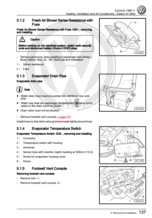

The blower fan is attached to the blender box on the passenger side of the van and can be exchanged pretty easily with some knee bolster disassembly.
The evaporator that might be freezing is the heat exchanger inside the cabin, on the passenger side of the blender box.
The frozen/not frozen condition of the evaporator is monitored by the E33 Evaporator Temperature Switch (VW part number 357 820 295 B, here's one on eBay that I bought recently) as seen in the Erwin diagram below. I think the diagram below is for the pre 1998 vans, but they all used the same evaporator temp switch located in the same place. Both Climatronic and manual air conditioning systems use this switch.
If this mechanical switch is disconnected or fails, the AC compressor will run 100% duty cycle and freeze up the evaporator. Note: the SD7V16 compressor in the 2001-2003 Eurovan is a variable displacement compressor, that runs continuously and varies the displacement from 8.1cc to 161.3cc via an internal pressure valve. [source]
Evaporator freezing will cause a loss of cooling. Normal function of the switch will interrupt the compressor function if the switch probe detects temperatures of 30F or colder in the evaporator probe tube.
The switch is designed with a probe that inserts 13" into the evaporator. It will be extremely hard to see, but with a cell phone camera you may be able to see into the probe hole in the evaporator and discern the plastic tube that accepts the probe and keeps it in the center of the evaporator.
You can remove the switch by disconnecting its electrical leads, unscrewing it form the evaporator housing base, and pulling the probe out of the evaporator, and test it by sticking the probe in a freezer and put a multitester on it set for continuity. The continuity state will change from complete to incomplete as the probe detects anything below freezing. Give it time. It will audibly click when the probe is in a freezing state and open the circuit.
This switch is just another in the series of switches (temp and pressure) in the AC system that can open the circuit for the compressor.
What I would do in your case is test the evaporator temperature switch first.
