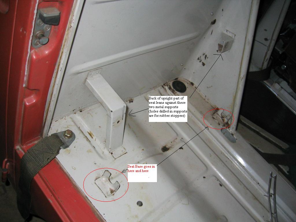

Can someone post a Pic of the seat mounts for a '65 walk thru for the Passenger seat?
I have nothing there for now, PO had mounted '68 hardware and matching seats.
What is on the base? Where are they located? And,
What is on the back area for the back support. Pictures if you can.
TIA, B
Yeah I did just search again and found
I'm getting closer.. thanks.
Here's a pic, I would like to know the measurements.

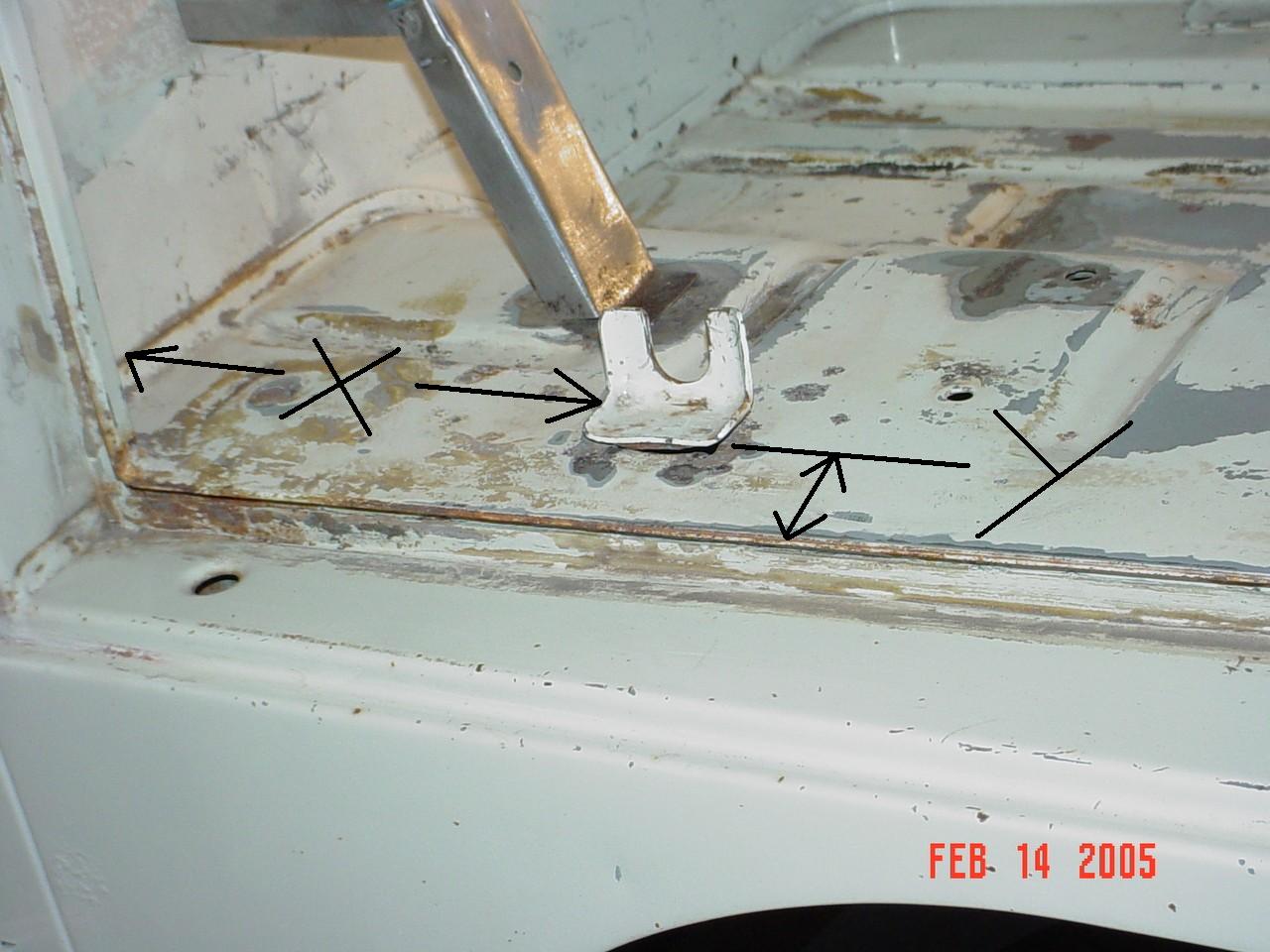

In the photo, X=6-5/8", Y= 1-1/4"
The X measurement is made from the very bottom of the bulkhead wall, so it's from the lip/seam along the bottom.

Buskraut, Thank you very much, just what I needed tytyty
