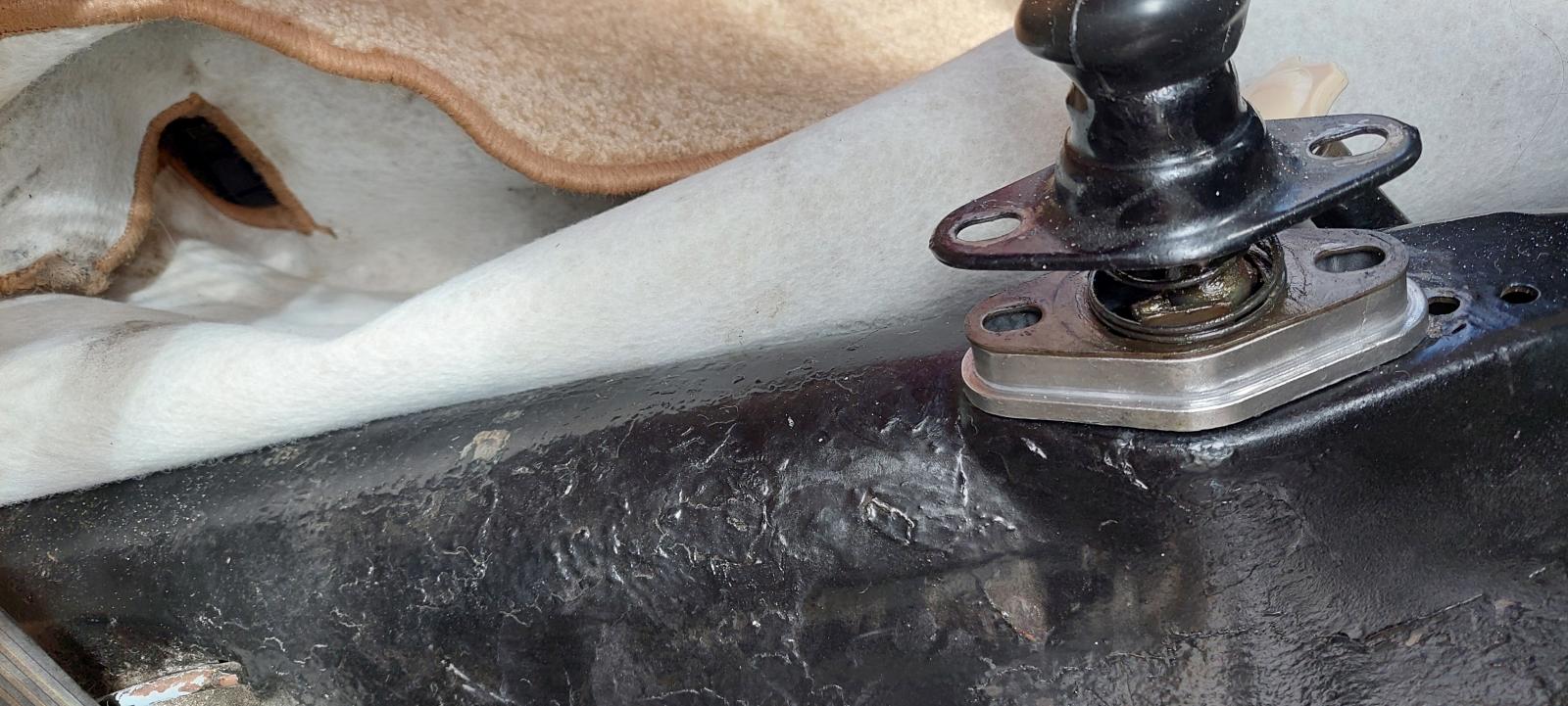

Another issue I have is the shifter, especially first gear. I also installed a quick shifter, because my wife is not so tall. But I can not get it to shift well no matter how much I tried to adjust the plate position. I checked 3 times that the plate has the correct orientation. Also, it gets to reverse whithout pushing down. It was working better without quick shift, at least the reverse. I found this thread to explain the best.

Yeah, well, remember the shifter issue? Look at this pics and tell me what is wrong...
I was just reviewing in my head how I assembled it, and why the reverse does not lock and it struck me. I was always looking at the plate orientation, and never at the position related to the spacer. Yes, it had to be under it. Changed places and yes, it shifts perfect now.
