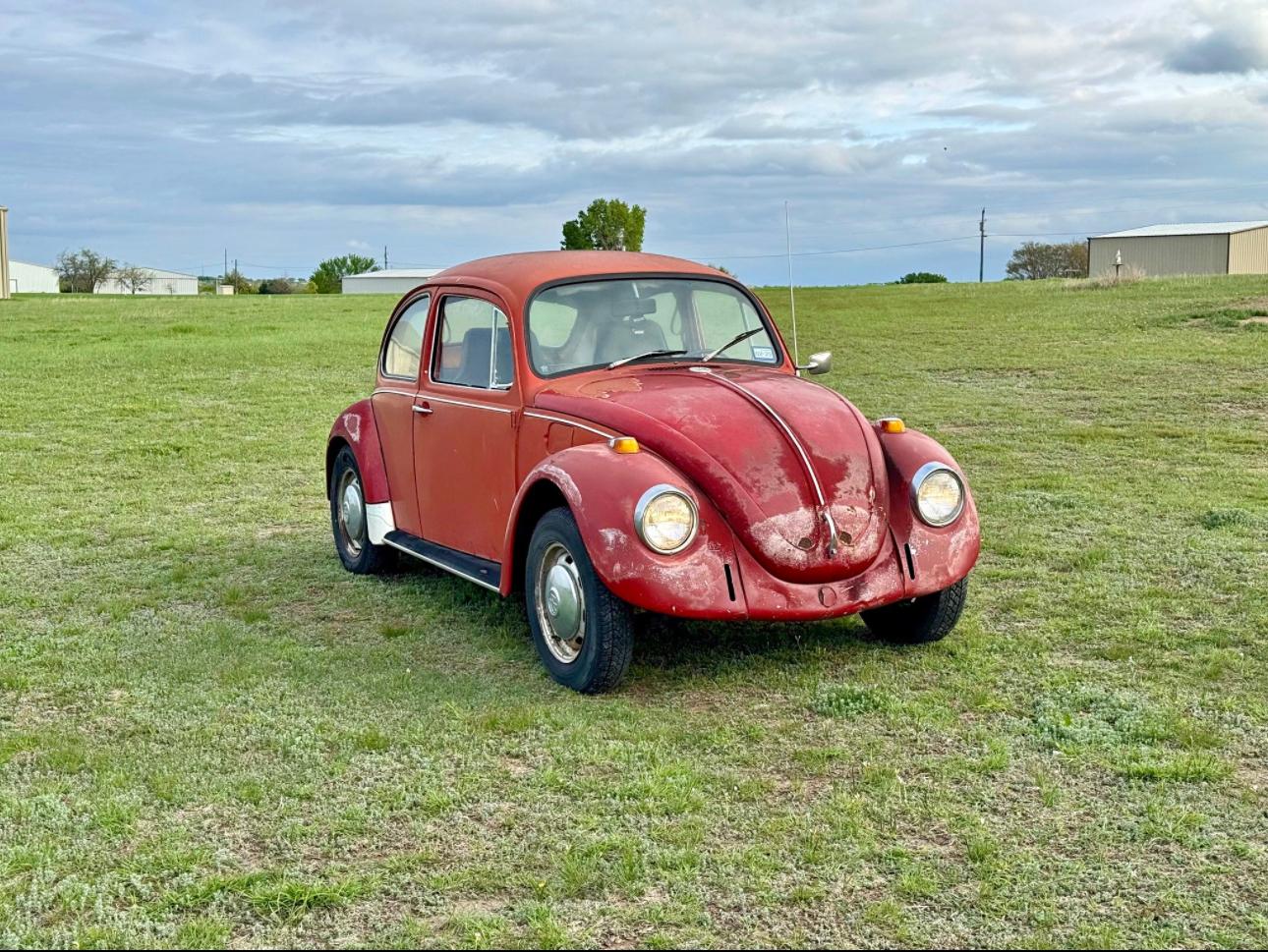

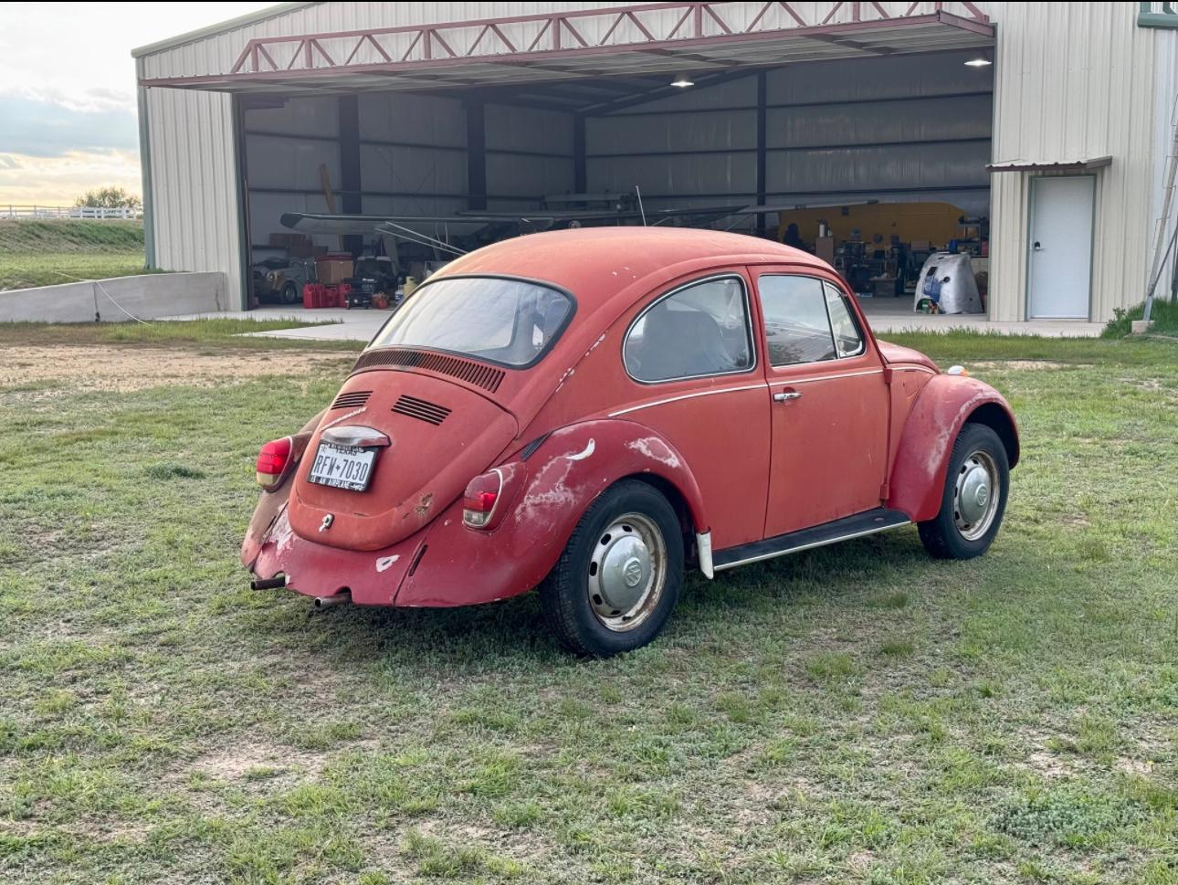

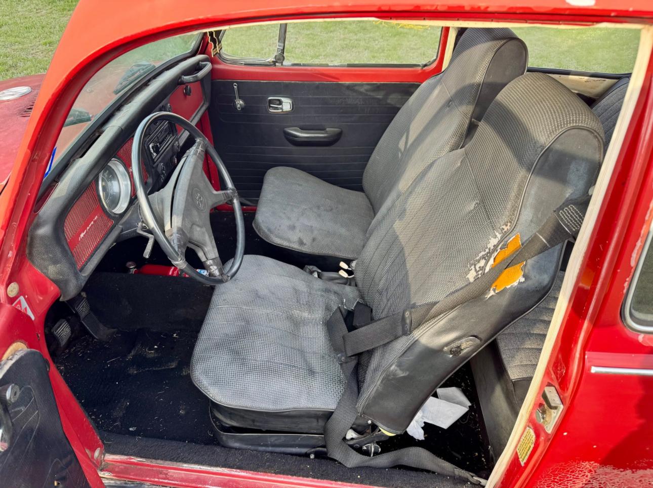

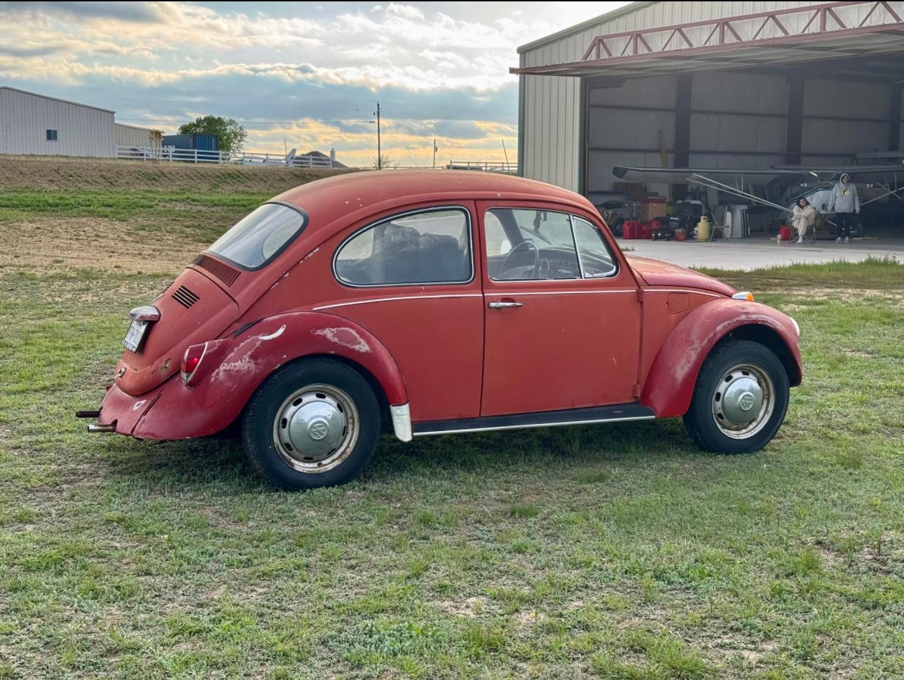

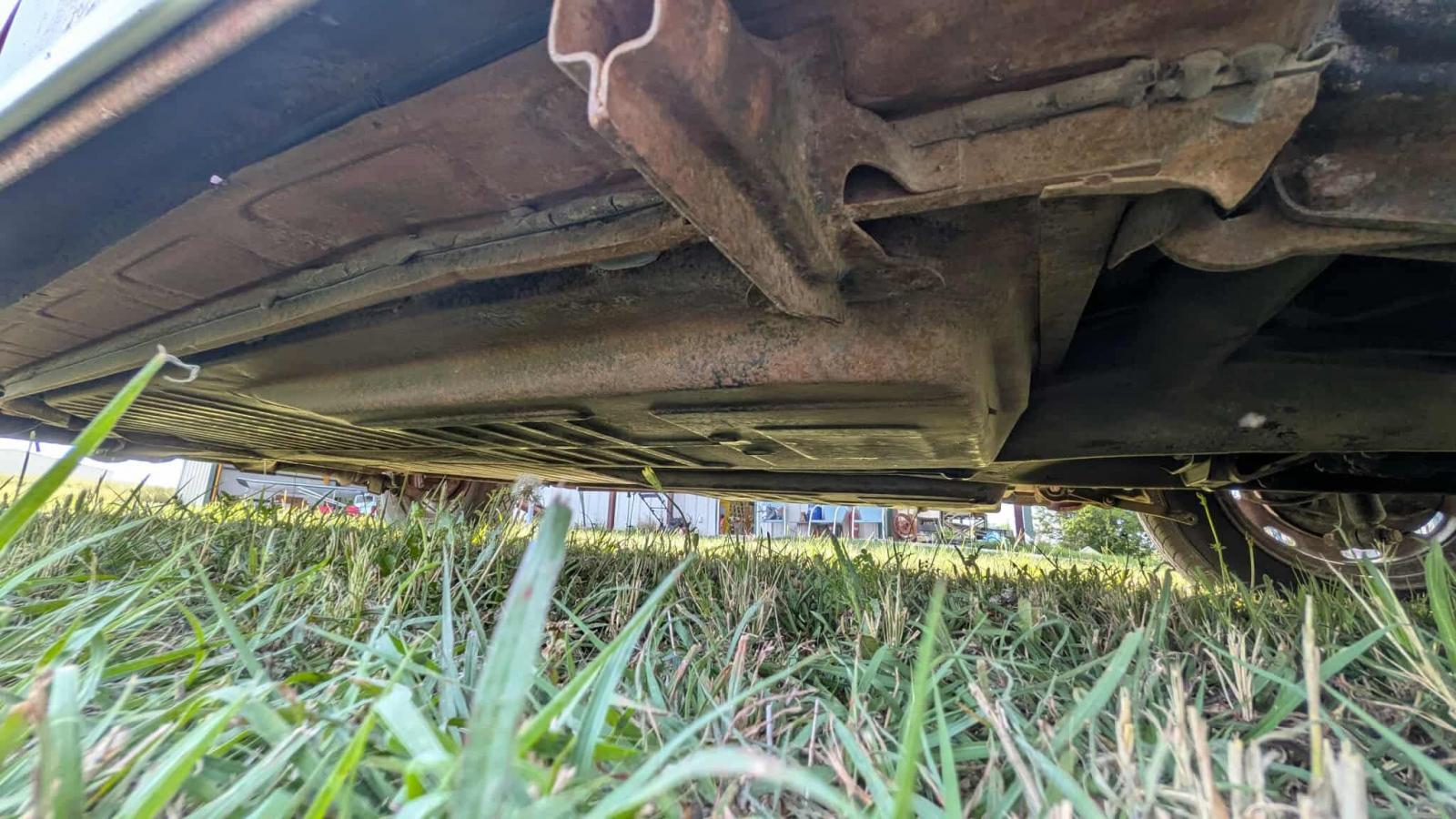

Here are more photos from the listing. The rust on the drivers side rear was from a small engine fire. It’s surface rust only. The only other place of concern is a silver dollar sized hole in the battery compartment.

Just for your general knowledge here are some changes that have been made to that 68 bug
1) the steering wheel is from a later bug probably 72 or newer
2) the decklid is from a later bug, 68 had no vents on the lid
3) the air cleaner looks different to me
I am pointing this out to you in case you are looking for a stock original car. The body looks good from the outside. Prepping, priming, and painting should be done to the fire damage soon. That stuff will rust deeply quickly. I would want to know about the condition of the heater channels and floor pan, and the support panel below and behind the front suspension beam. These are all common rust areas on these cars. Hope this helps Bob
Thanks Bob. I knew a few things weren’t original, like the steering wheel. I did not know about the others. Here is what the underside looks like.

PostPosted: Mon Jun 16, 2025 3:05 pm    Post subject: Re: What's worse? Engine work or body work? Reply with quote
Looks really solid and complete, except the missing bumpers !

PostPosted: Mon Jun 16, 2025 4:21 pm    Post subject: Re: What's worse? Engine work or body work? Reply with quote
The pan looks pretty good as does the underside of the heater channels. Heater channels are hard to ascertain without being at the car and going inside and tapping the channels from front to rear. They are covered in carpet so you can not really see any hidden rust. If the owner is willing ask to photo the area behind and below the front suspension beam. Another common rust area is the package shelf behind the rear seat. This also is hard to examine as it's covered in carpet. It looks to be a pretty solid car. Hope this helps.
The deck lid is from a '70 ... probably to replace the fire damaged one. The air cleaner looks like a sawed off '67 ... again, probably to replace the fire damaged one. The steering wheel bothers me though. The '71 - earlier steering wheels were not interchangeable with the '72 - later ones. That suggests that the steering column was replaced. Why? Possible accident? Might be worth giving it a pretty close look for evidence of front end damage. Have a look at the VIN plate behind the spare tire and compare the number to the one stamped on the tunnel under the back seat. If different numbers, that car has probably had fairly significant front end damage and multiple parts replaced. Just something to be aware of.
