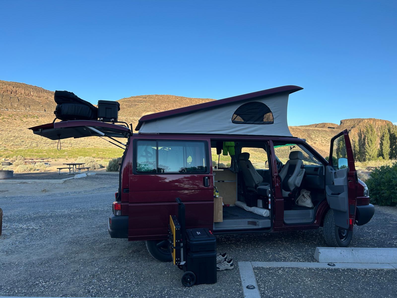

Another van upgrade!
We got out camping recently to test out the addition, traveling to central OR and WA. These wheat fields sure have a nice view!

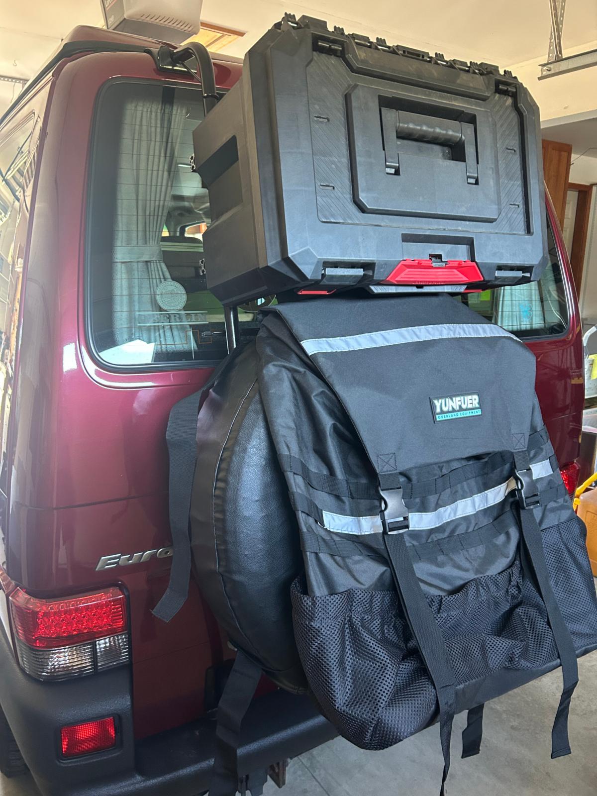

I added a Gary Lee rear hatch spare tire rack from evrack.com. I had a few reasons to do this.
- One, I wanted to have the spare more easily accessible instead of dropping it from below. Think about changing the spare while on rutted muddy forest service road.
- Two, and this came from an off-roading 4x4 van buddy. Imagine being way out off-grid enjoying life when you get a flat. Fine, I have a spare. Well as soon as you put that spare on you no longer have a spare. Best to head straight home and keep your fingers crossed. TBH, I don't find myself in those kind of camping locations very often, but at least now I have options available.

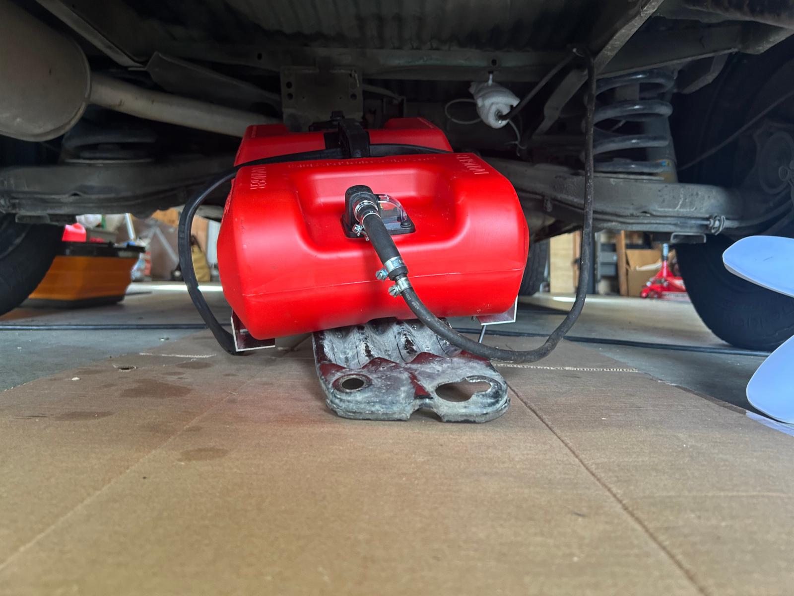

-Three, I now have space under the van for a larger diesel tank and more room available for a water tank, should the need arise. The diesel tank under the hood actually got warped, probably from the heat and the cap would leak ever so slightly. So, that needed a fix.
In this next photo I forgot how to van camp and brought too much stuff. I added a place to hold my tables to the kitchen cart and had 2 boxes full of stuff. When I got home I removed the table holders and everything fits into 1 box now.
The diesel tank sits in a custom holder bolted to the spare tire carrier. The white object up behind the tank is the new location for the heater pump. It is super quiet in this new location.
The tank slips out easily for refill and it has a quick release for the fuel line. Based on past experience, I will fill this tank once maybe twice a season.
Here are some rack close ups. First is how I travel around town, when not camping.
A look under the cover.
Here is camping mode. This most recent trip we stayed at multiple pack it in pack it out places so the 'trasharoo' knock off was very useful.

@bigfoot -- Great rack setup. Just curious ... does that rack & tire setup obscure your license plate at all?
I've been noticing lately around where I live (NC) just how many Tow Hitch bike racks completely obscure license plates. The various European racks made for the Eurovan are all designed to hold bikes above the plate - something I think is required and enforced over The Pond.
I would assume that in states like North Carolina where only a rear plate is issued, that the plate should either be visible in its regular position or relocated to an aft position of the bikes & rack when used, but I never see anyone doing that.
Thanks! I suppose it could obscure the license plate somewhat. The tire carrier clamps onto the 2 vertical supports, so it's infinitely adjustable up and down along the supports. In fact, I first had my spare up high covering the rear window. It made it very easy to raise the rear hatch with my old struts. But, my rear view camera is located up on the third brake light housing and it got blocked by the spare, so I moved it down and got new struts.

I might ditch the storage box and move the spare up as high as I can stand. My rear view mirror is actually a live rear view camera so I can't block the camera too much.
