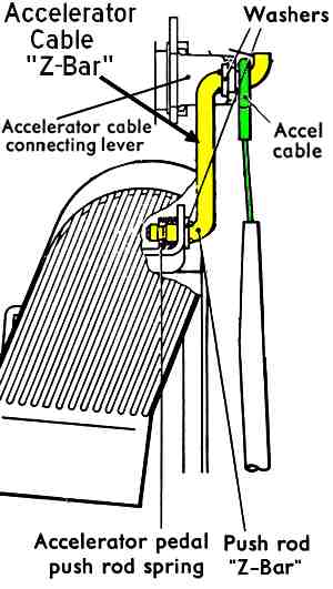

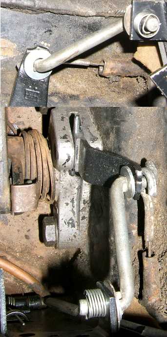

Here is a photo looking down on my gas pedal assembly. Can anyone tell me what this kluge supposed to look like? The threaded post welded right angle to the first, with a cable connector and a nut, drilled through and pinned with a nail can’t be right. I never noticed it until the body shop disassembled it to paint. When I got it back that nut/nail combo is rubbing against the tunnel. Pictures or exploded view to order the correct parts would be appreciated. Thanks.

PostPosted: Sat Jun 07, 2025 10:19 am    Post subject: Re: My 66 gas pedal mess Reply with quote
I've posted a bit about this over the years.

sfizio wrote:
Yes, no roller here but the welded nut with the hole through the shaft was definitely not original. I ordered the Z bar and it came yesterday. Any idea if I have to remove the pedal cluster to install it?
If you look at my photo of the correct setup, there is a connecting lever that the Z-bar passes through. (Mine has been replaced, you can see the Wolfsburg West logo on it) Well, whomever hacked your pedal setup, they reversed yours. The pin it pivots on, the head of it is up against the tunnel, so the cluster has to be unbolted to get to it.
Andy T.
