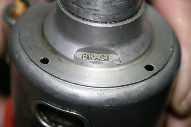

How do you tell a German 009 distributor from a Brazilian one?

AI answer probably close but take it for what its worth. Its a artificial opinion.. Rolling Eyes Rolling Eyes Rolling Eyes
To differentiate between German and Brazilian Bosch 009 distributors, focus on visual cues and internal construction. German versions are generally smoother in appearance and have a single spring on the advance mechanism, while Brazilian versions may have a rougher surface and often feature two springs, though this isn't always a definitive indicator on eBay. Additionally, German-made distributors are stamped with "BOSCH" and often have a three-number date code, while Brazilian versions may be unmarked or have "BRAZIL" stamped on them according to the 912 BBS forum

PostPosted: Thu Jun 19, 2025 9:22 am    Post subject: Re: 009 Question Reply with quote
One made in Germany will say BOSCH and GERMANY on the bottom.
Ones made in Brazil will say BOSCH and might say BRAZIL or nothing. Aftermarket ones say nothing.

PostPosted: Thu Jun 19, 2025 2:24 pm    Post subject: Re: 009 Question Reply with quote
Glenn is - as usual - correct.
Both of mine state Germany on the underside.

PostPosted: Sat Jun 21, 2025 8:17 am    Post subject: Re: 009 Question Reply with quote
The German one will say Germany. The Brazilian one will say Brazil or nothing. Many of the Brazilian ones are not marked with any country of origin but you will find the standard Bosch markings on them along with the Bosch logo.
There's not much if any difference in the quality between the two especially if they are used. Once they are used and rebuilt there is no discernable difference other than the Germany stamp on the bottom.

PostPosted: Sat Jun 21, 2025 8:38 am    Post subject: Re: 009 Question Reply with quote
Look at 3rd post.
