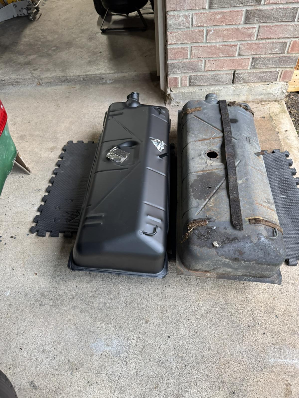

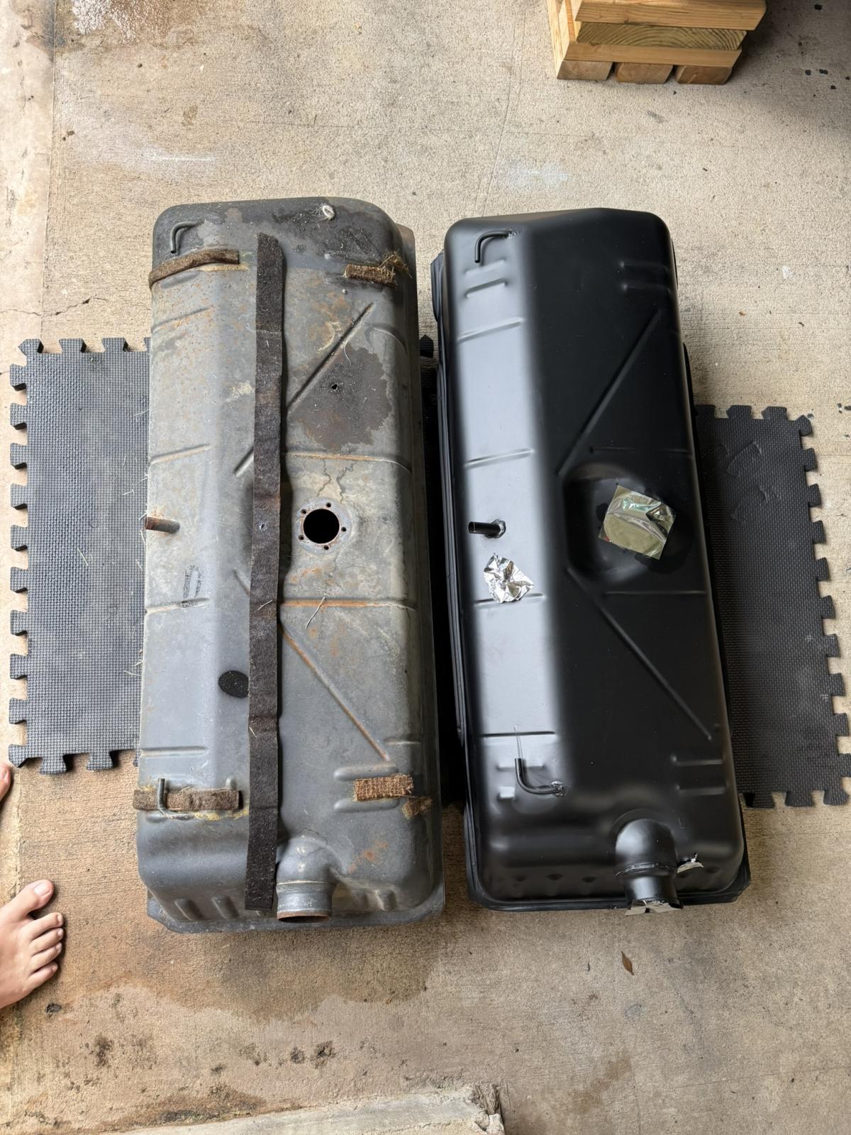

PostPosted: Thu Jul 10, 2025 7:49 am    Post subject: Re: Questions about Fuel tank options for 1972 Reply with quote
I finally order a used tank from Bustedbus. CIP1 would never send me pictures to confirm if there part was correct, even though I told them description and part number did not match.

I thought it was a good decision but I am starting to thing otherwise. I ordered from bustedbus on July 9th but no word of status on shipping. I have tried email, calling, text with no response. If I don't hear something by tomorrow I will ask for refund or call credit card for dispute. I can give people grace if they are on vacation or family emergency, but no response for over 10 days is not good.
I tried for another used one on classifieds but no news, he could not access in storage. Only 1 other option on classifieds but it is pickup only.
I might have to get the closest thing I can and have it modified to work with the 3 vents needed.

Well I never received the busted bus used tank, they finally refunded my money. I did find a new tank that will work from JBUG. It is labeled as 211 201 075 D but it is actual a hybrid that works for 1968-73.5 years. It has the 3 vents on top, and the barrel style sender.
https://www.jbugs.com/product/211201075D.html
Here is comparison. All measurements are good, vent ODs the same, I am sure the metal gauge is not as good as original. It appears to have internal baffle. I will try the test fit tomorrow.
I will buy the felt pads but for the bottom I was thinking about using something like this leftover matting from a jet ski. Any thoughts on that?
Tomorrow is big trash pickup and I just put out the old tank for trash and 2 minutes later a scrapper came thru at took it. At least it will be recycled.
And who makes the best sender? I was thinking of ordering from WW.
