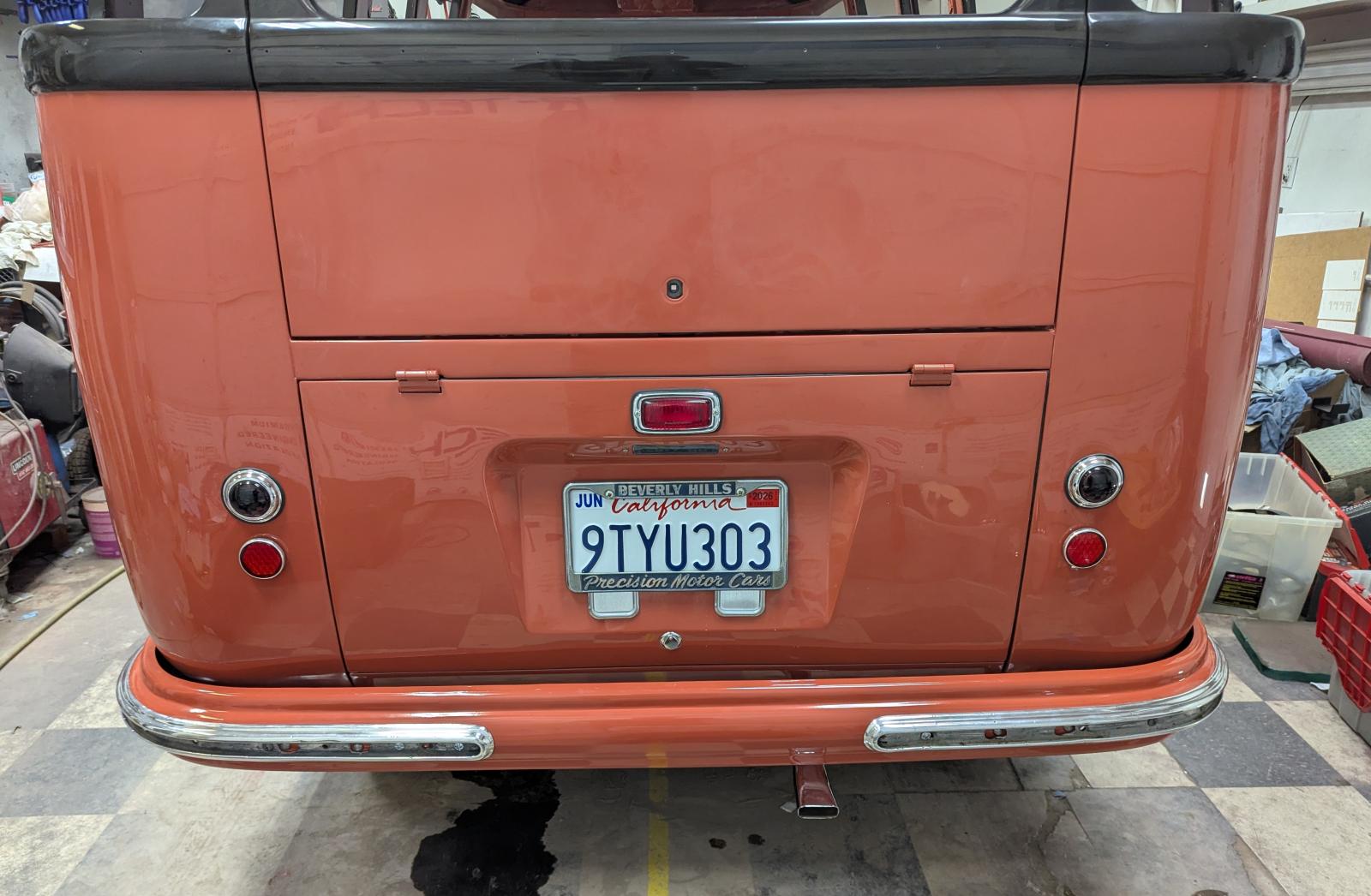

Nice Work, did that vintage speed muffler fit with the pressed bumper, or did you cut the tip?
I punted and installed a repro stock muffler for now

Did you at least clean the one 'complying-with-the-law!' safari you had installed?
I am curious, as i considered buying a stainless exhaust from those folks - is it something about your bus that made getting the thing to fit properly impossible, or did they just screw up? Lot of money for a part that doesn't fit w/out modification$.
I'm not sure. I think it might be the part itself, since it's a very significant dimensional issue. I've emailed them and sent pix, but haven't heard back yet. If you look closely at one of the pix of the other guy who used one of these mufflers on a bus, you can see the support is interfering with the apron.

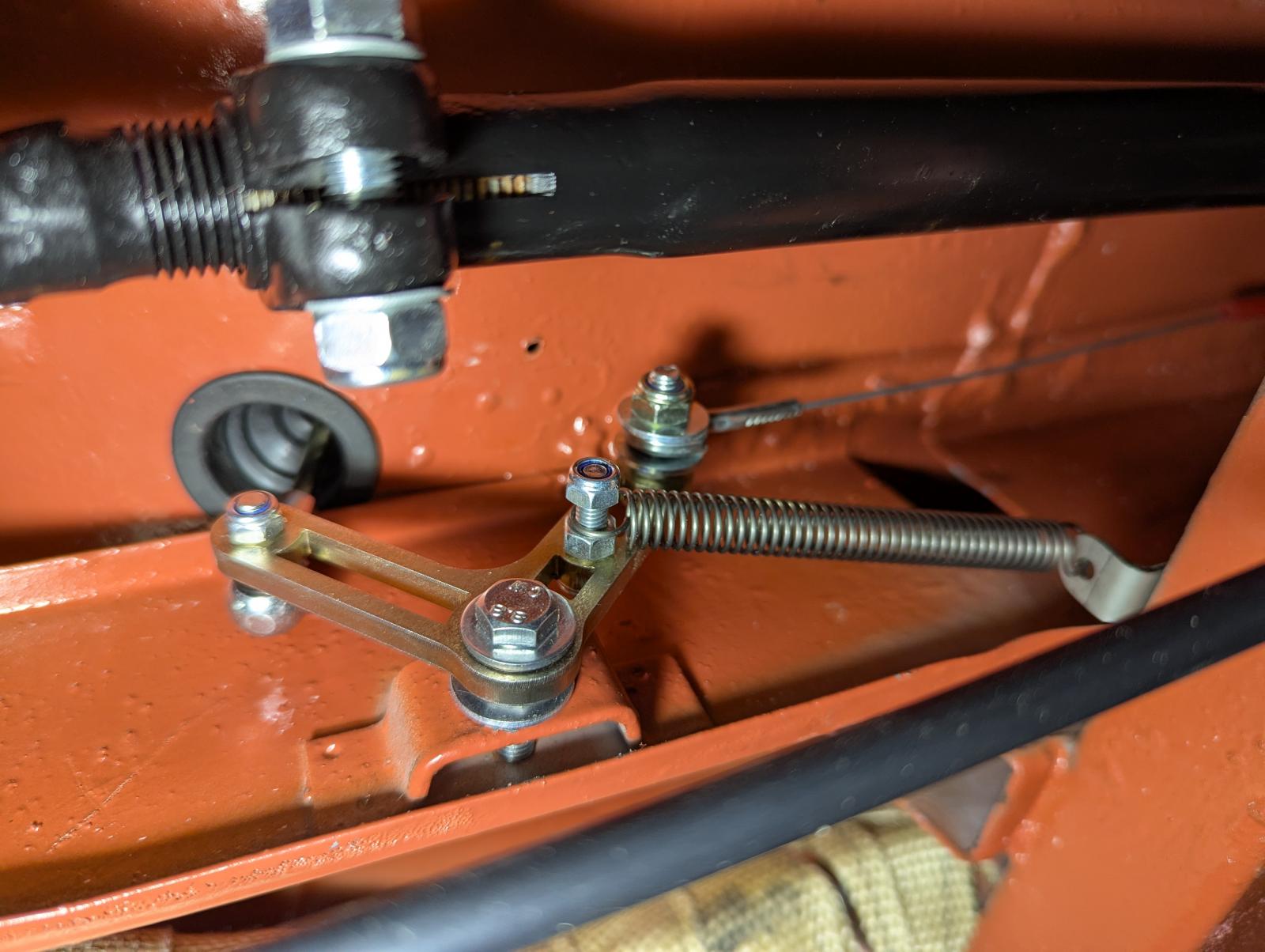

I installed a ]Butty's Bits accelerator pedal linkage, and it made a huge difference. I might retrofit one to my single cab, too.

Fantastic results! Well worth the effort.
I'm interested to hear how the pedal linkage works. There are a bunch of items I'm thinking of buying, and this is definitely on the list.
The fundamental principle and geometry is the same, but instead of the pivot points being holes in the pedal and the frame that have been there for 50+ years, it incorporates ball ends and bearings for the pivots, which takes out all of the slop. The icing on the cake is the add-on spring, which takes over some of the effort from the spring on the carb. A common problem I've had is the carb spring didn't always close the throttle, so you'd have to do a quick blip to get it to close.

I fitted the Butty’s Bits throttle linkage to my Bus a couple of weeks back, and it is Night and Day better, would recommend Thumbs Up

Is the force your foot has to press down and vary the hold-down increased?
I didn't notice any extra force being necessary when I fitted one. I think the bulk of the improvement is the return spring that holds to the cross member. Maybe try fitting a spring first. If it works for you, but the kit and get the excuse improvement of the joints.
