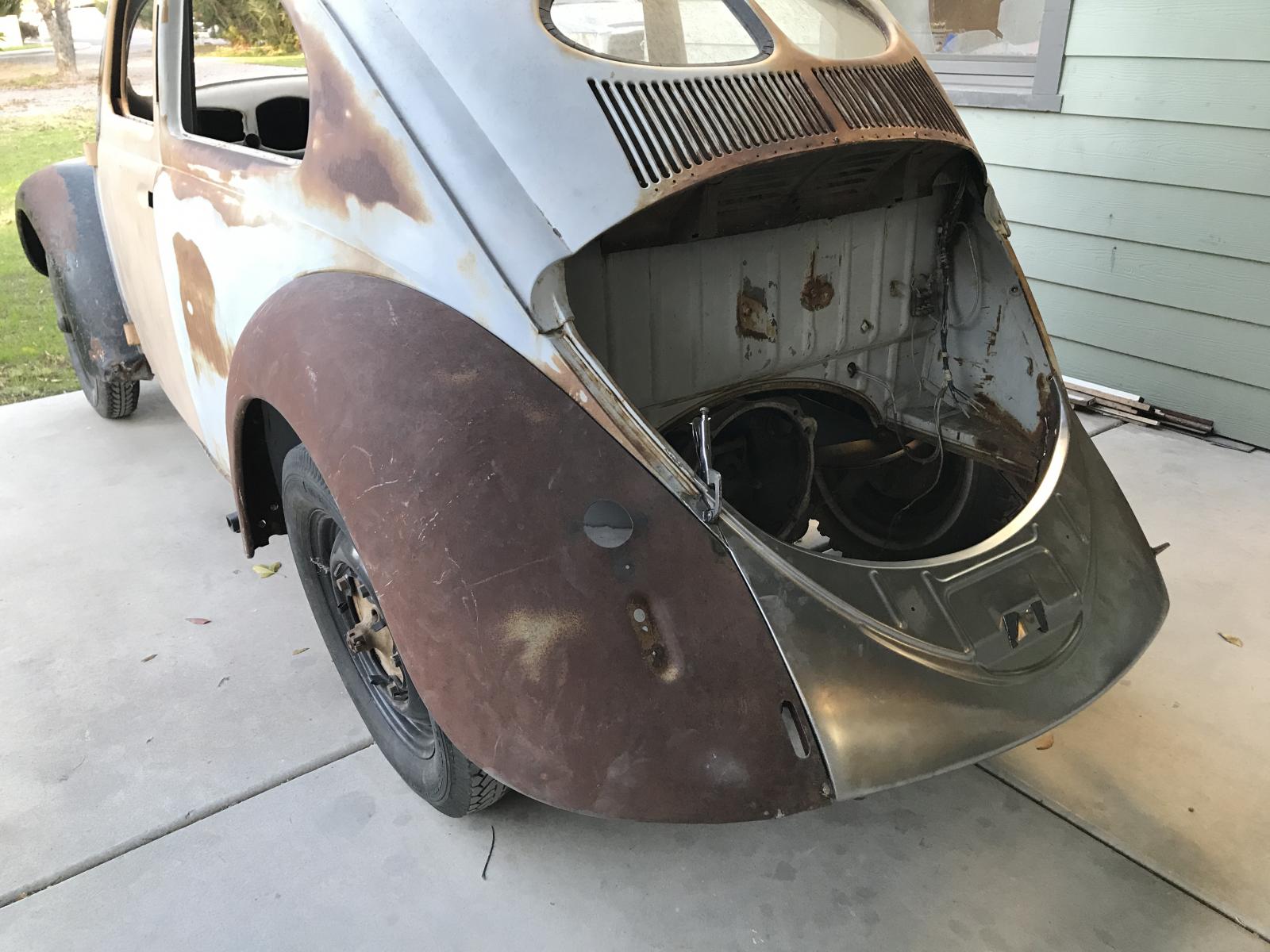

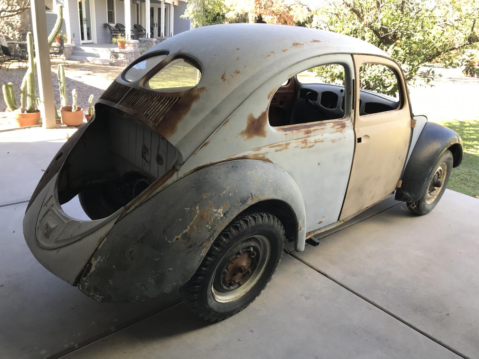

So when I got the car it was just a body with the doors and hood on a rolling pan. I actually helped Dick pull the pan out of storage, spent a day straightening out some things and had it powdercoated. Then we just grabbed a front and rear end to make it roll. It was while doing this work to help him sell it that I thought maybe I should buy it. So we made a deal and that's how it sat for a while.
Here's some of the paperwork I got with the car... The birth certificate, an old title and bill of sale. The BC doesn't state the color but it's a Pearl Grey car.
Who knows what the car looked like in '78 when it sold for $500 but I remember it looking pretty rough sitting out at the back property of my friends house. Dick said the fenders were brazed on and it had soup cans for taillights. It's a pretty good body though, not really any rust but it's had clip work done front and rear.
I've started work on the car a couple times but always seems to stall out. Collected up some fenders and grabbed a decklid from Dick at some point. I did some front clip work on it back in the mid 2000's. It had been clipped already. It was cut through the heater channel and A-pillar on the right side, and the right quarter,apron and spare tire well were replaced. The left quarter was original. This replacement clip was bad though and the work was rough. I'm not sure if they put a bad clip on it or it got tapped again? I had found a '58 front clip back to the dash with a bad left quarter, so that was perfect. The doors fit fine so I didn't want to get into the heater channel and A-pillar. I replaced the right quarter, front apron and spare tire panels in one chunk. The original left quarter was still good. I know I still need to finish modifying some of those pieces but at least it's solid and straight now. Unfortunately I can't seem to find any pictures of that work. Below is the only picture I can find that must be of that time. This is my son Mason. He's 22 now and just graduated college.

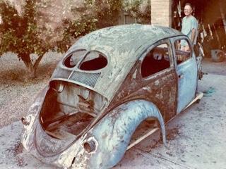

Here's a pic of the car Dick and Hans sent me. This would have been about 1989 right after they got it. They were stripping paint and made a dolly to push it in and out of the garage. Note the soup can taillights!

PostPosted: Mon Jun 16, 2025 5:08 pm    Post subject: Re: Another 1951 Hoffman Standard, Dick Christensen's First Splt Reply with quote
He bought out collections like Bob Everett's here in Phoenix which included three split convertibles
I flew out to CA in the early '90's and attended one of the Golden Gate VW Club of America meets at Solvang. I remember when Dr. Christensen presented his black with white-coved split-era Cabrio; he had several people as his support crew cleaning the car. It was so well done as to work quality and detail correctness. Then in '99 I spoke with him, and his son Hans a little bit when they participated in the "Return to the Fatherland" tour, me joining the team starting in Michigan to upstate New York in my '64 Ghia Cabrio.
David, I also spoke to you when you were showing your in-progress Hebmueller tribute at the VW Classic in Irvine, CA; likely that was '96. It was near the end of a line of many other genuine Hebs at that show. IIRC you mentioned it was based on an oval-window Beetle. Even then you were known as an advanced metal fabricator with VWs.

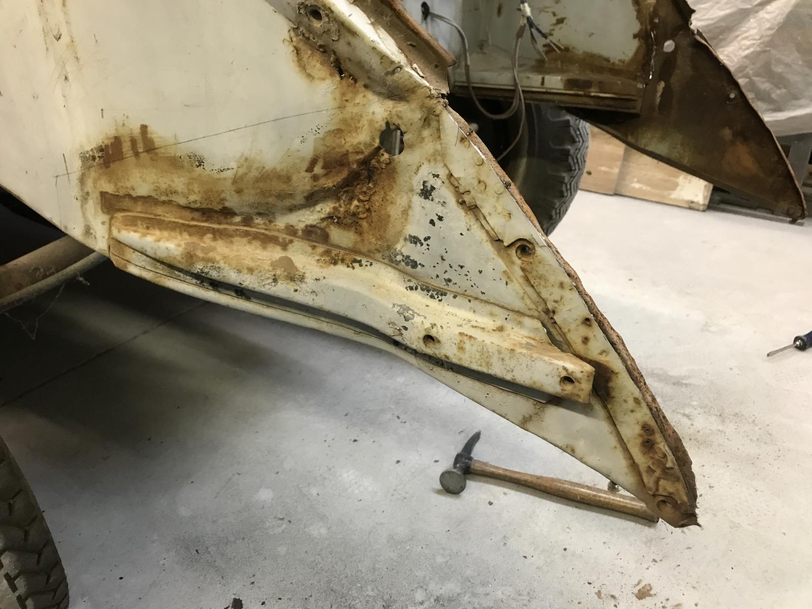

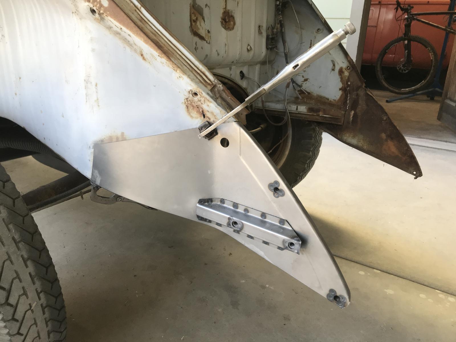

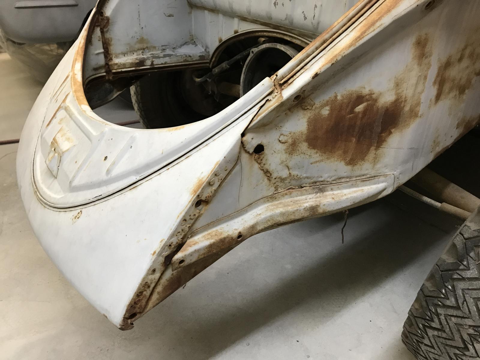

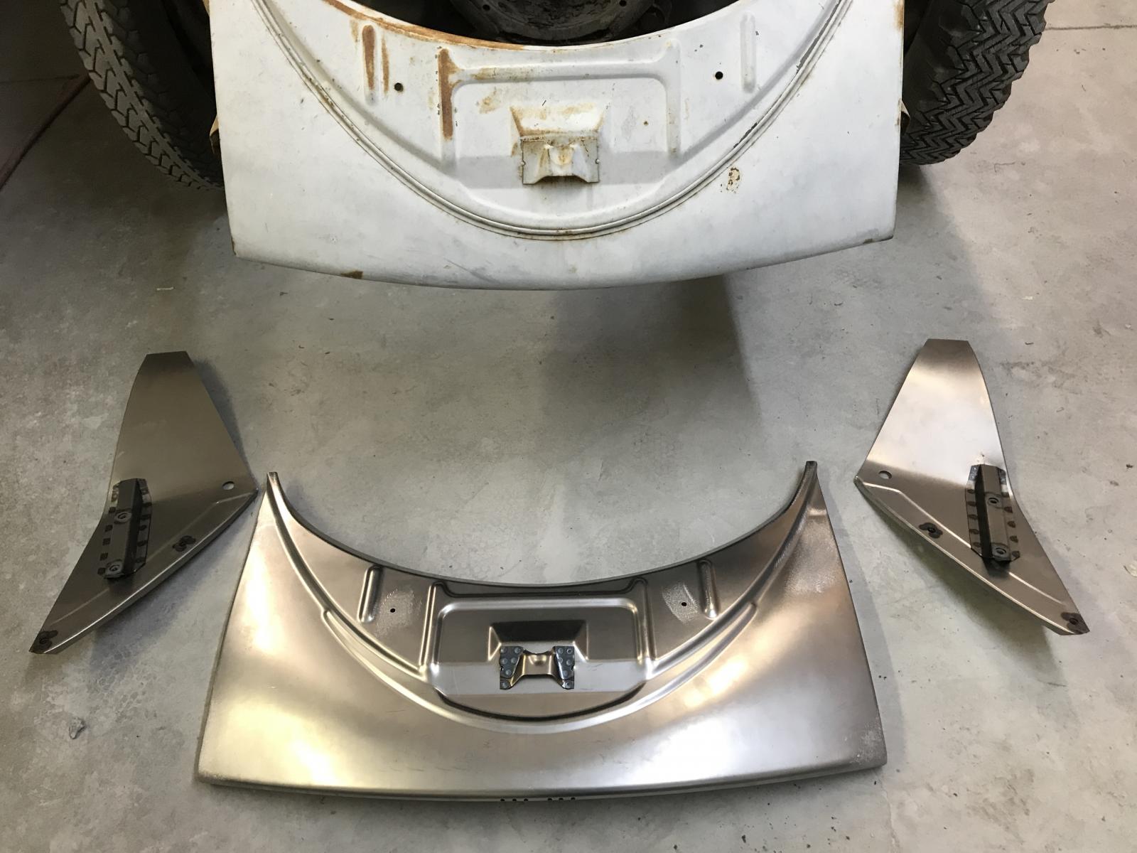

Starting on some rear clip work. It had been done before but needs to be corrected...
The new apron and quarter panel repair parts from Wolf Parts...

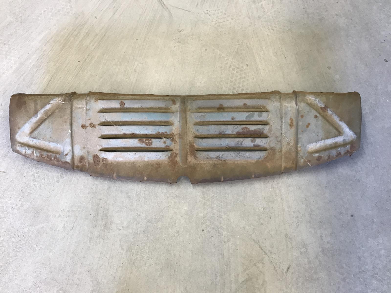

Somebody thought it would be a good idea to remove the decklid hinge carrier to get a better paint finish behind it. But it made it awfully hard to fit a decklid so I temporarily installed it with sheet metal screws...

[/quote]Here's a pic of the car Dick and Hans sent me. This would have been about 1989 right after they got it. Note the soup can taillights!
[/quote]
Another Split Beetle with "soup can" taillamps was this '46 in northwest Connecticut, seen in 2008 (WM971252 gallery)-

This picture is so amazing as I have a couple of pictures during my build phase with my kids that are now teenagers.
Awesome metal work! Applause Applause Applause Applause
Between Wolf and Mika they do a badass job on those aftermarket parts they almost should be considered NOS because they are that good.

Did you MIG or TIG the rear bumper mount panel in?
