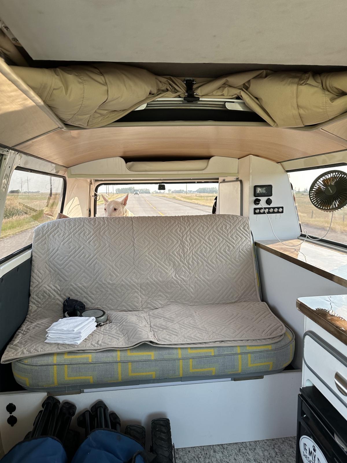

I made mine. I used paneling from Home Depot and put polyurethane on them. 6 years later, they are still in excellent shape.
This photo is from 2019, during my build.

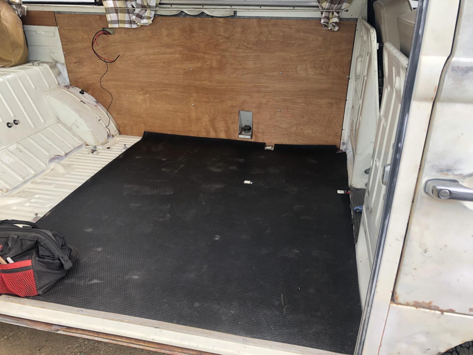

Early Original panels are 1/8” birch plywood, no laminate
My set came with a finish on one side, but was missing a couple piece's. I bought the same birch plywood from the local Windsor plywood and applied a couple coats of general finishes flat varnish on both sides to seal it up.
I covered some of the side/ door panels in 1/8” closed cell foam and vinyl so it is a little more quiet.
Cabinets are all custom, so I used white laminate so it’s nice and bright
