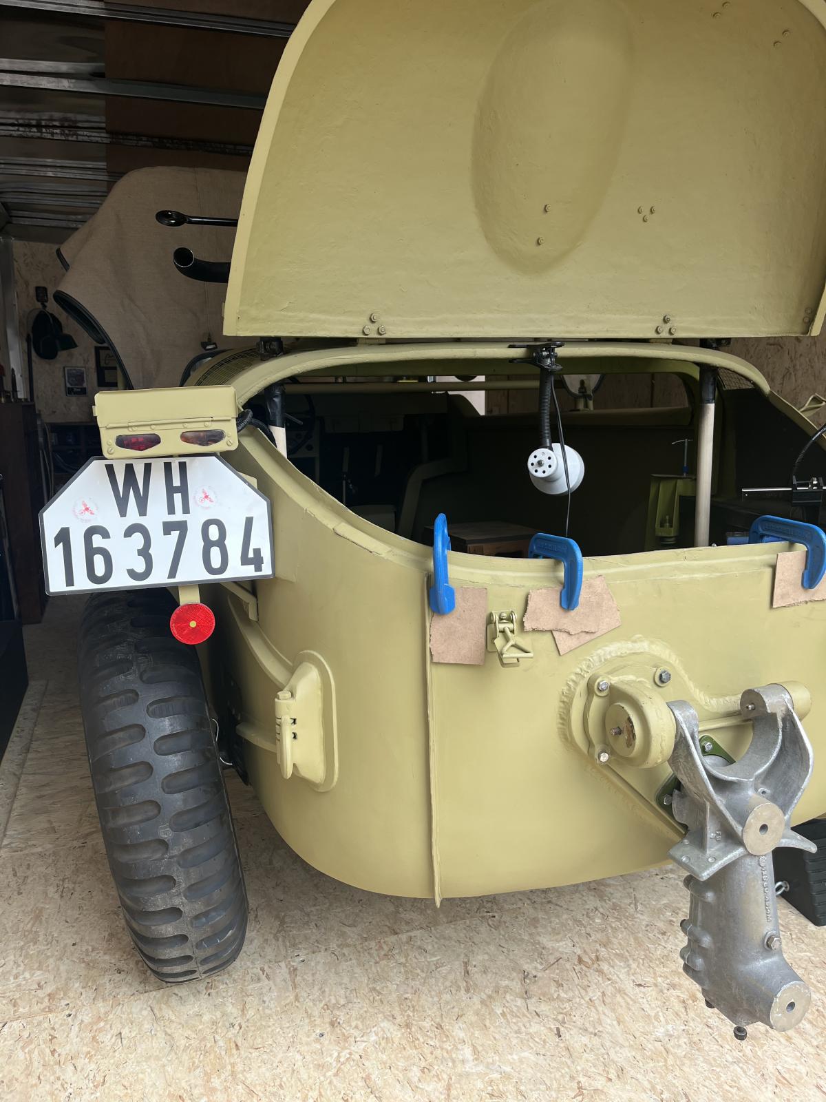

Hey guys thanks for all the comments love to hear back. Moving to a new location these past two weeks, out of the storage now but made almost no progress unfortunately.
I say almost. I did spend a few dollars and bought myself exact copies of the original WH licence plates that were on the schwimmwagen I am basing my build on.
If you look closely at the wartime photo you can read the licence number and these will go on for shows. Anyone have an idea how to make my actual plates and these quick disconnect? Appreciate the input.
Try to get more updates next time.

VW_Jimbo and Who.Me? thanks for the replies. I decided to try some what are supposed to be very strong magnets that I found on Amazon that have attachment hardware to the car.
Looks like this. I will post pictures later to show how it works out .

Hey folks, been pretty busy with home stuff, but managed to get the new magnets for the new licence plates mounted and the plates magnetically installed.
Hope to get started back on the welding soon.

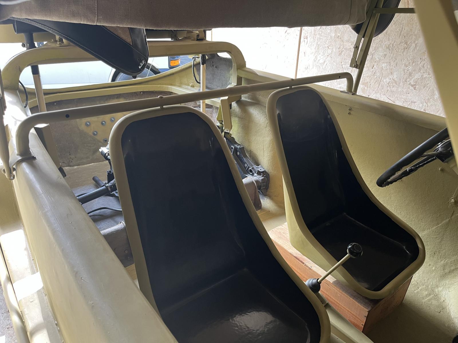

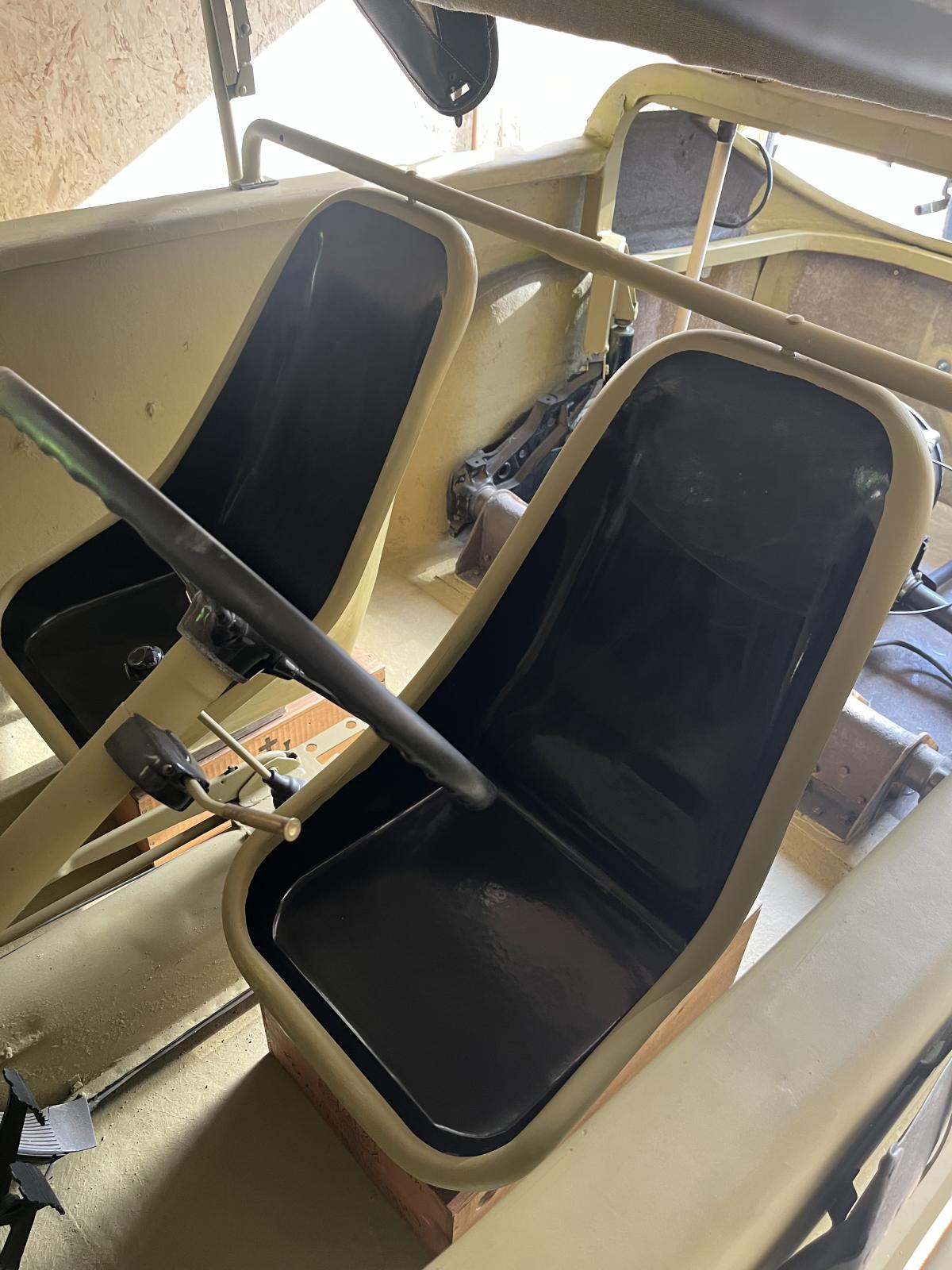

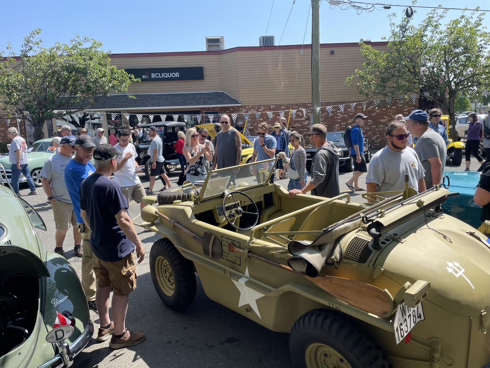

Thanks for all the comments. I attended a big local vintage car show this past Sunday. I spent some time putting together the car visually so people could get a better idea what it looks like.
I installed the propeller temporarily with an attachment strap as it would have worked:
Next I painted and temporarily installed the seats and rear temporary cover:
In place at the show next to my friends 53 twitter:
Was busy all day talking about the car and history etc:
After the show, the seats are all back removed and the propeller removed, ready to continue building.

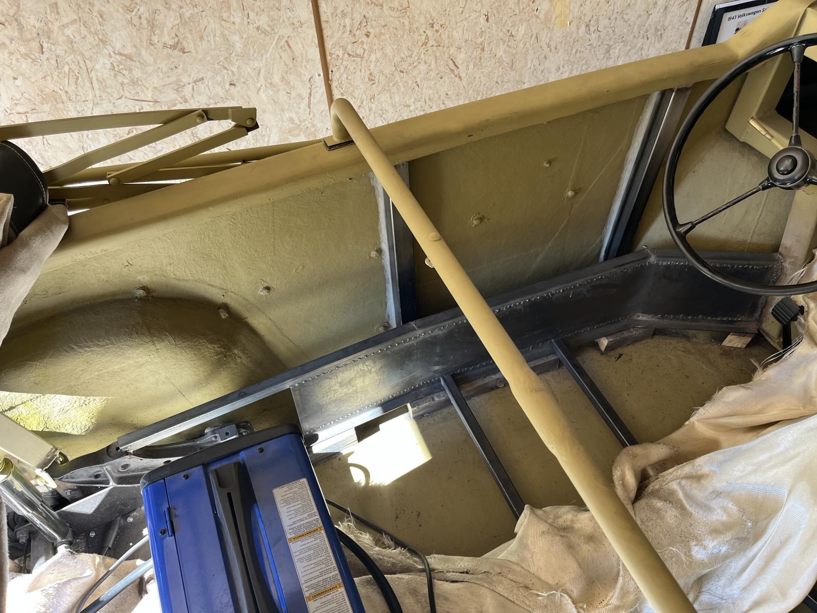

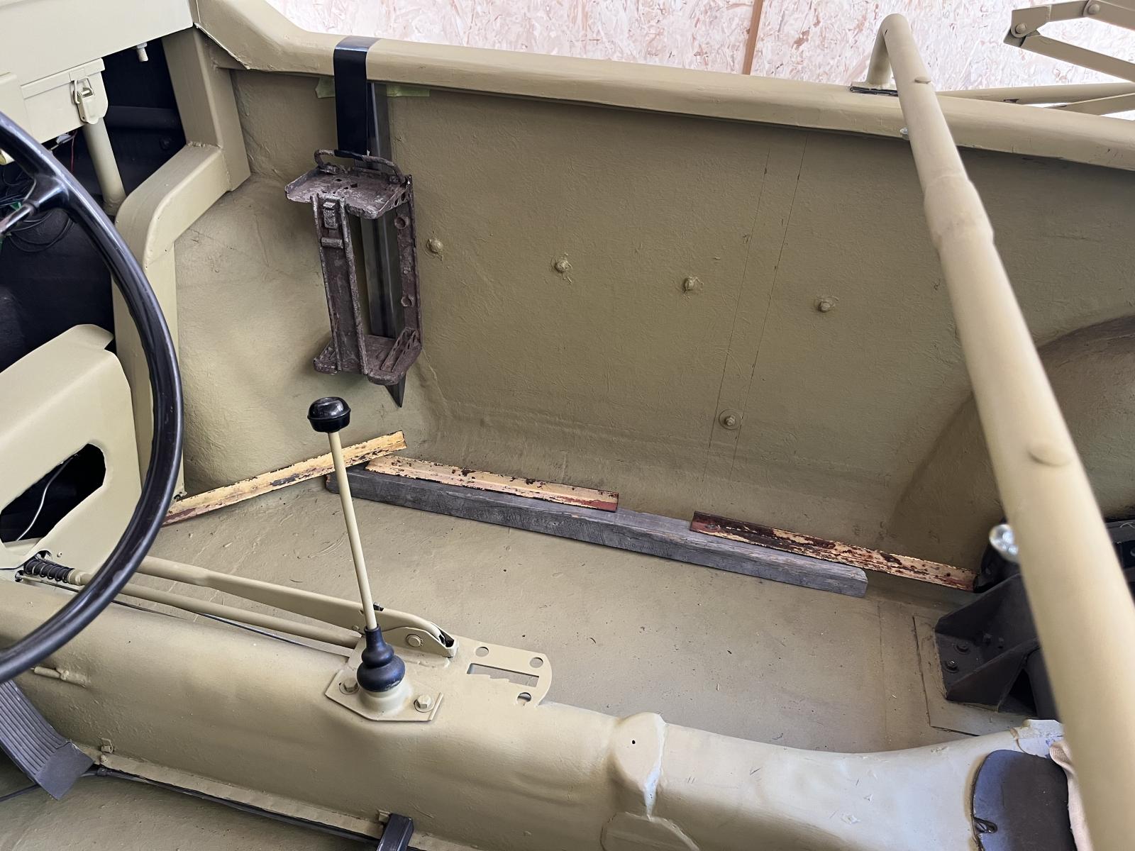

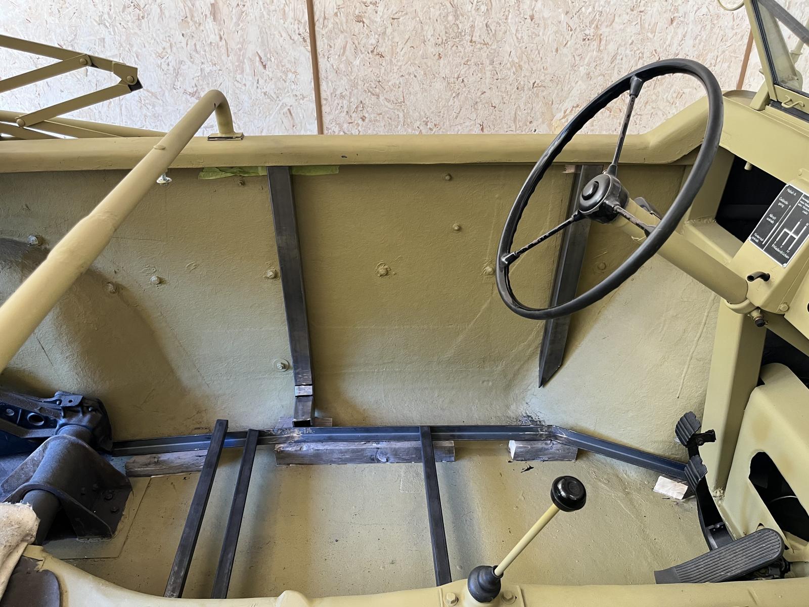

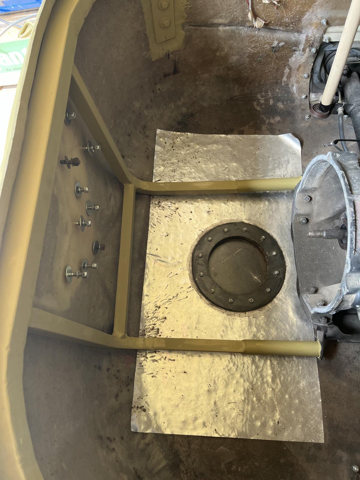

Hello gents, I was able to make a bit more progress this time moving into the cabin for the required steel framing.
To start I measured the lip on both sides of the center beam from the fiberglass floor and came out at 2 1/8 inches. I cut and bonded 8 pieces of 2 x 2 wood blocks where the outer steel 1” angle x 1/8 thick is to attach then welded in these two side rails. They are welded to the front and rear structure. This was done with the seats put in and out 10 times I think.
I hung an original MG34 ammo carrier where it will be mounted eventually.
The boxes are temporary but the correct height.
I also welded and bonded the vertical steel supports, two on the drivers side and one on the passenger side (ran out of steel second one next time home) The aft vertical steel supports weld to the outboard side of the support rail and vertical plate tieing the whole structure together. Next I added the vertical piece and the angle to the top and welded it all together. Still needs to be cleaned up but it’s pretty strong and in the correct position. Will work on the passenger side next time home.
The cross seat support tubes aren’t welded in yet just in place. I need to see where my seat mounts (which I already have) go first before welding them in.
I hope to make more good progress next time home again.
