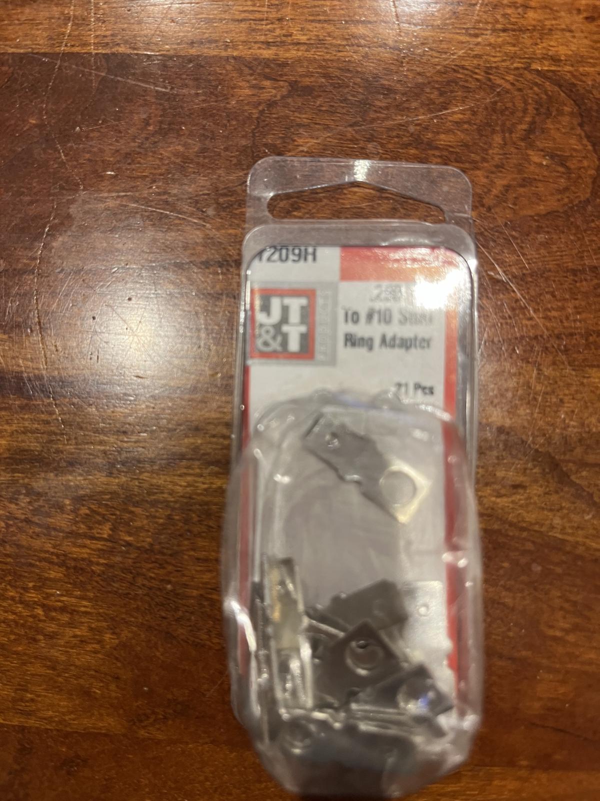

or, if you still have the female spade on your wire, this connector?

Thanks Tom.
Maybe can use a female bullet connector. Will have to decide tomorrow. Was trying to avoid a ring terminal but that may be the easiest solution at this point.
