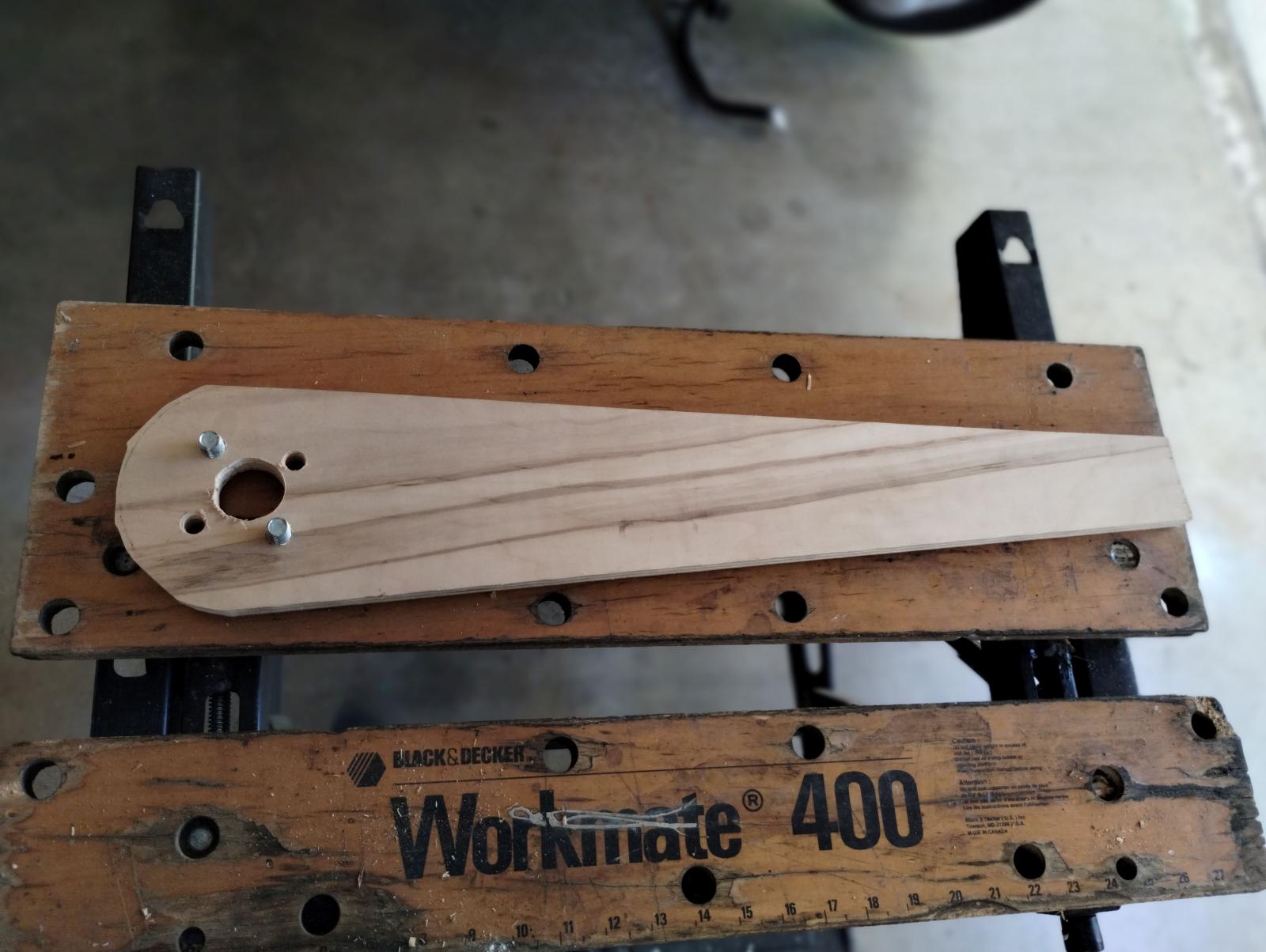

PostPosted: Sat Jun 21, 2025 4:25 pm    Post subject: Re: Luxury Tools Reply with quote
Nice one. Smile This is what I made from a gash bit of 3/4" ply and a couple of 1/2" bolts on our EJ22 to undo the crankshaft nut:

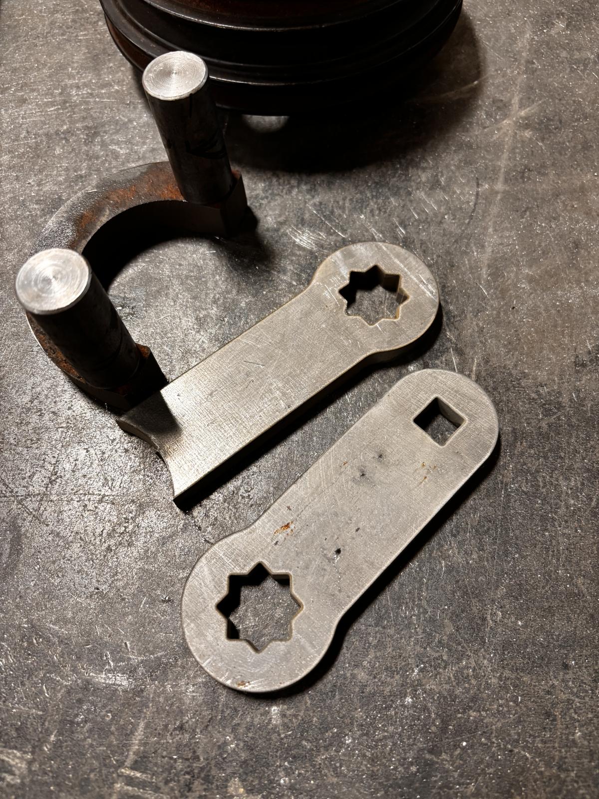

PostPosted: Sun Jun 22, 2025 9:56 am    Post subject: Re: Luxury Tools Reply with quote
Jeeze mayormccheese! Nicely done!
Did similar last week. Didn’t finish it completely before I used it successfully yesterday. That reaction arm welded to the horseshoe shaped part rested on engine carrier .

PostPosted: Sun Jun 22, 2025 1:50 pm    Post subject: Re: Luxury Tools Reply with quote
Maybe a photo distortion, but in the 2nd to last photo, the hose from the water pump to the pipe looks damaged.
Otherwise good execution of the tool. I had an offer to buy the Matra or Zelenda version decades ago, but the price was so high I passed on it. Even when I was doing repair work full time did not often need that tool.
Method to get the pulley bolt out was a 1/2" Chicago Pneumatic impact, a long extension, and a swivel joint, with 165 Psi.
