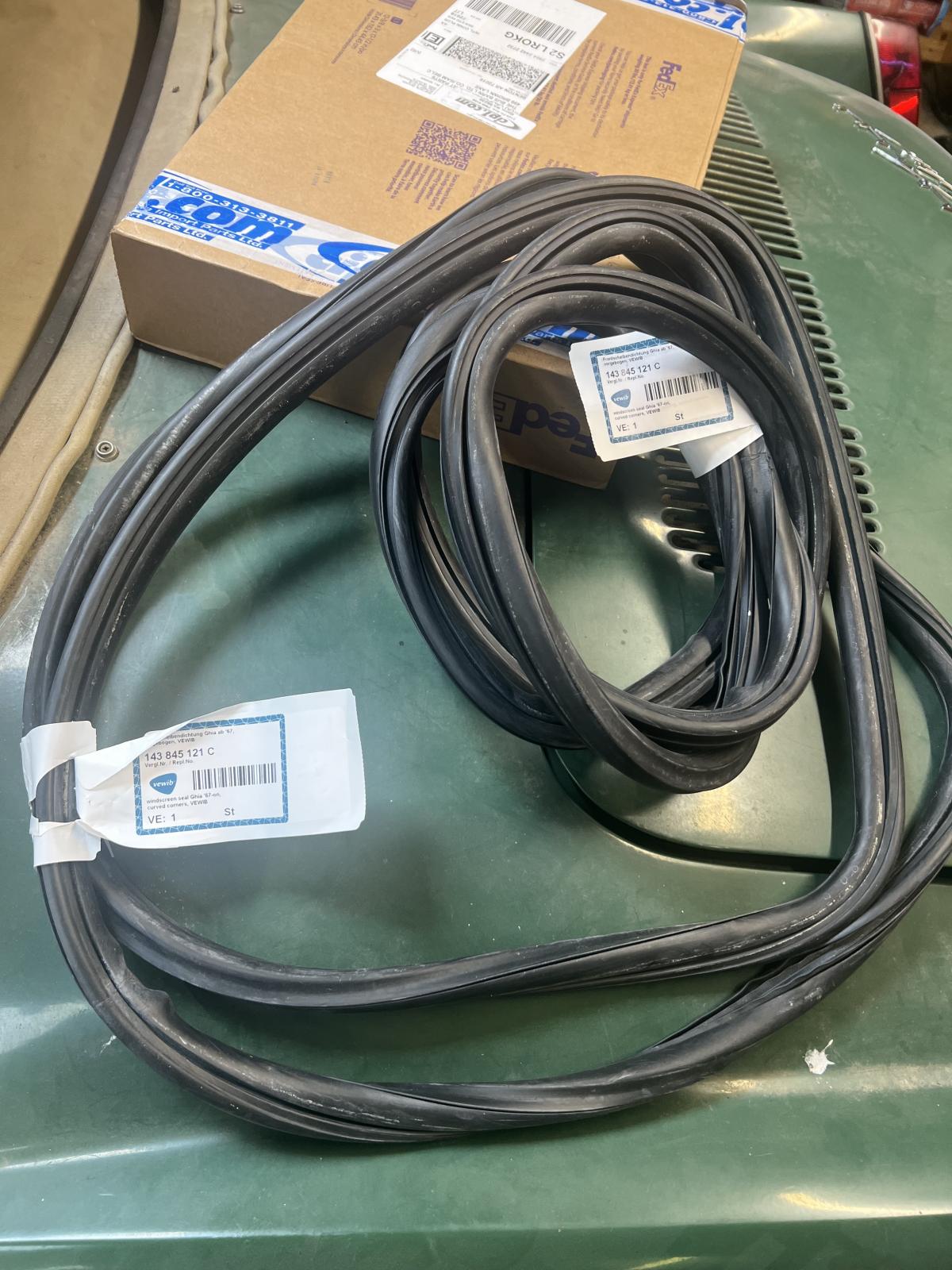

Called and spoke with a guy named William at CIP1, who verified that the 5 star seal was in fact a Vewib product. It’s hard to pin down, as they have more than one 5 star seal, along with 3 options of German seals for the deluxe/T trim setups.
The seal I received from Airhead was just too soft, and immediately pulls off the windshield when attempting to rope it in to the car. Now as far as the trim going into the seal, it was perfect, easiest I’ve dealt with, but the elasticity and looseness made installing impossible with the FYG glass.
Ordered two seals for both cars I’m working. Will report back in a few days.

This is the one you'd want for 67-74. As far as I can see on their site for 67-74 it's the only one labeled as "German with molded corners". I doubt Vewib makes the one that doesn't have molded corners and isn't labeled as German, since Vewib is located in Germany and uses the OG molds. I'm not seeing any other German front windshield seals on their site, aside from the one for 56-66.
https://www2.cip1.com/c24-143-845-121-c/

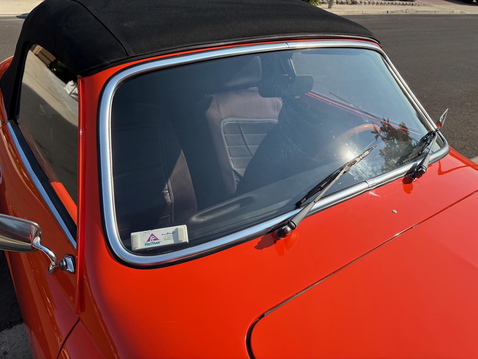

Well, I chickened out. I was already not confident about installing the windshield based other experiences posted on TheSamba, then with Sam (sambosamba22) buying the same seal as me from Airhead, having much experience installing windshields, and not being able to install with that seal, I decided "nope".
I took the car to the body shop that's done the bodywork and paint on my car. They also install windshields, including older cars. They tried to install the windshield several times and could not. They say every time they install around a corner then move to a straight section, the corner pops out. It sounds similar to Sam's experience. The glass I have, the FYG FF00222, is the same glass that they would have ordered, so they are not concerned about the glass. They are ordering a new rubber seal from their supplier. They don't know the seal manufacturer, but it's pretty expensive, so hopefully it's the good one. If the new rubber doesn't work, they can return it, so I won't have to pay unless it works. If it works and I can get the manufacturer name, I'll add the info here.

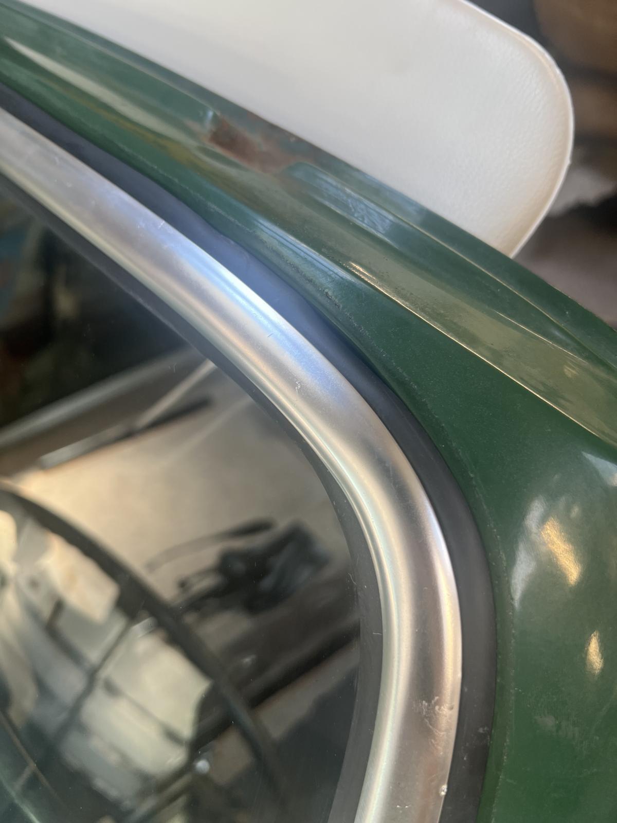

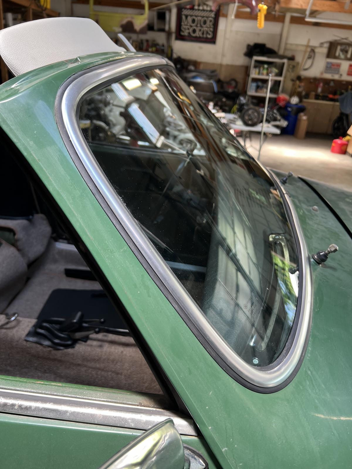

Here is my most recent effort on the 72 convertible that still retains the teeth along the pinchweld.
You can see the glass and trim are in, but the size of the glass is allowing the seal to roll short and back in/under the lower portion of the glass.
For what it’s worth, the German seal at CIP1 is in fact the Vewib seal.

PostPosted: Fri Jun 27, 2025 11:11 pm    Post subject: Re: Post 1966 Karmann Ghia Windshields Reply with quote
Sam, did you order the Vewib seal from CIP1? Are these photos with the old seal or the new seal?

PostPosted: Sat Jun 28, 2025 1:01 pm    Post subject: Re: Post 1966 Karmann Ghia Windshields Reply with quote
This is with the Vewib seal using aftermarket T trim which was from CIP1 as well.

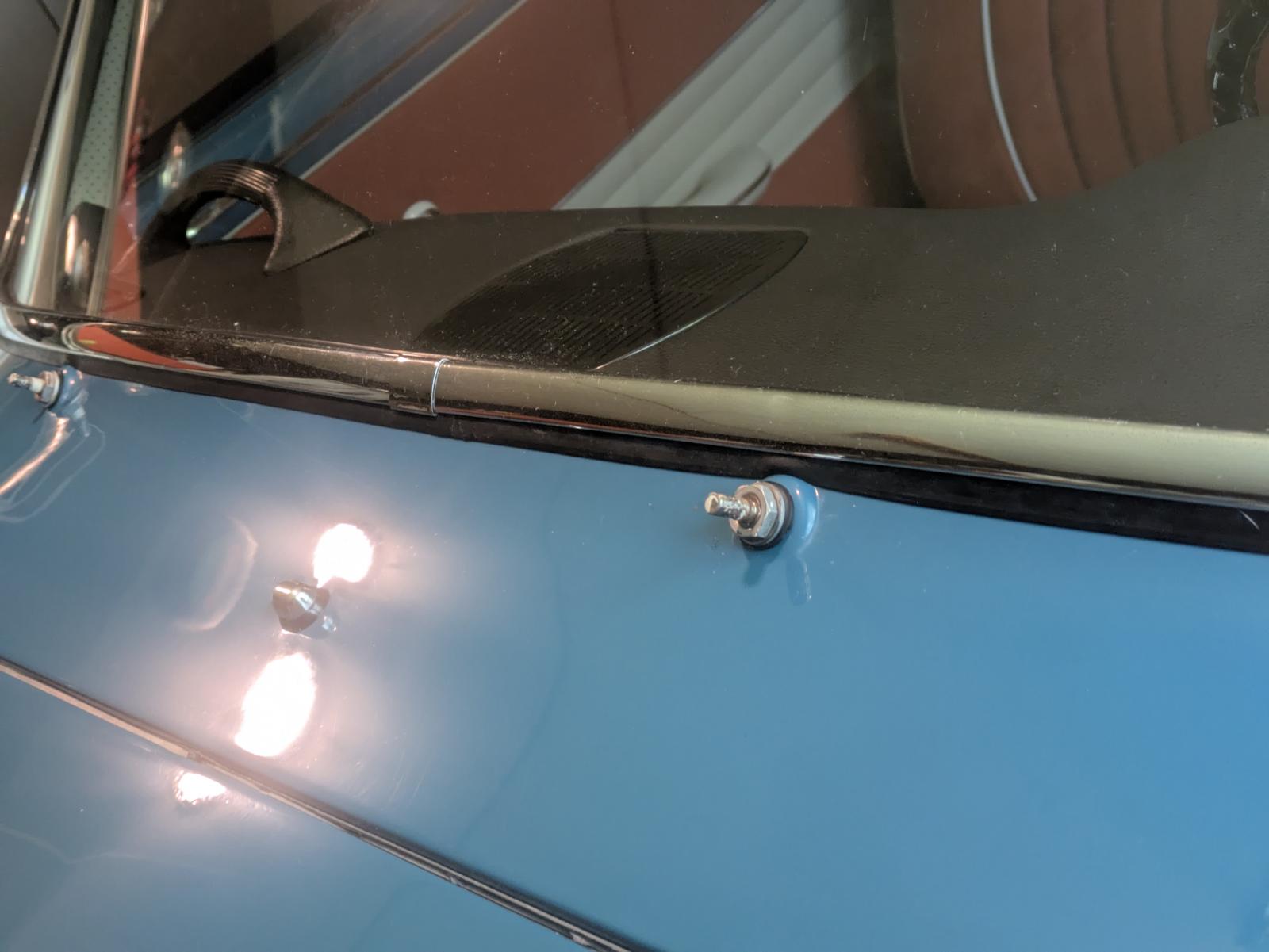

SamboSamba22 wrote:
I've only installed a C-trim windshield on my 66, but simply installing the windshield and seal isn't the last step. At least it wasn't for me. You can add string in the corners, like rcooled suggested to help fill it out. But when I installed my c-trim windshield with vewib seal, it initially looked like the above as well, with gaps in the corners. But then I went all the way around, working the seal outwards to fill the gaps. Leave the small center joining pieces of the trim in the center uninstalled when you do this. Your fingertips will probably be pretty sore afterwards.
This is how it sits after spending several minutes pulling the seal outward all the way around. Again before I did this, it sat exactly like the green car above

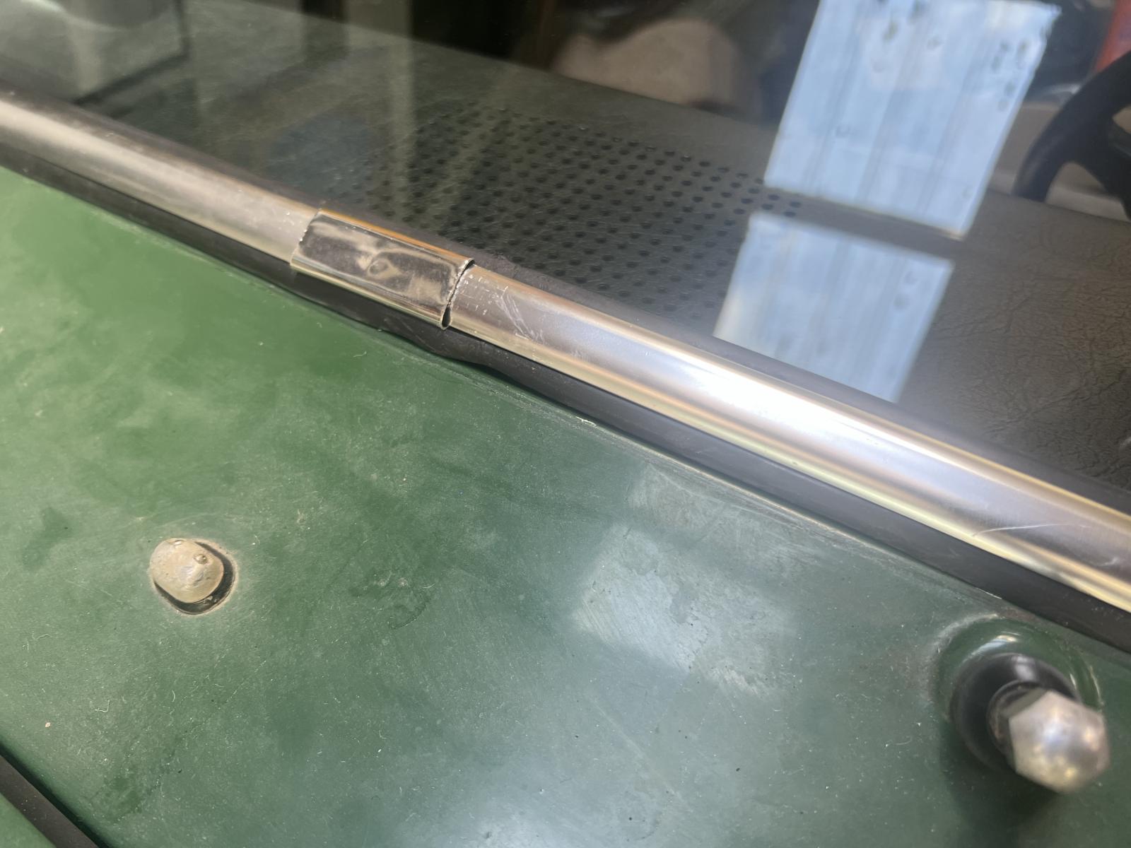

I finally got the car back from the shop. It was weeks to get the windshield installed. Remember that I provided the parts (rubber, windshield, and aluminum T-trim) and the shop was having problems getting the rubber to stay in place. They ordered a seal from their supplier, when they got it, it was the same as the one I provided or at least it acted the same when they tried to install it. Their supplier had an alternate seal so they tried that one next. That seal was very stiff, plus apparently the seal groove for the T-trim is supposed to have an inside edge that catches the barbed edge on the T-trim, but the seal groove edge was too deep and would not catch the T-trim, so the T-trim kept popping out.
At some point they tried installing the glass in the rubber then installing in the car then adding the T-trim, but that didn't work because they couldn't get the T-trim into the groove after everything was installed in the car.
The shop said they also removed the "gripper strips" at some point from around the window frame on the car. Those are the tack-welded angle sections that create a thicker edge to hold the window rubber. One had been removed before I bought the car, there were four still in place. I don't know if the shop removed all or some of them.
The shop finally went back to the rubber seal I had provided. Spent some time coaxing it into place. The last problem was around the top left corner that the rubber was not wide enough and kept wanting to roll into the space between the seal and the frame. They tried pulling the rubber out further. I also tried, but it was not moving. The shop put a spacer between the seal and the frame to help keep the rubber pushed out so it doesn't roll under.
Here's photos with the windshield installed. The last one is the top left corner that was the problem.
I didn't install the windshield myself, so don't have any tips to offer. The rubber seal was from Airhead parts, it was the better seal with molded corners, we never ended up trying the Vewib seal. I'm glad I didn't do the install myself. The shop that did the work is a general body shop; they work on new and old cars. They did the body work and paint on my car. They have installed windshields in many old cars similar to this (with glass inside rubber that installs into the frame), but not Ghia-specific. They said this was about the most difficult glass installation they have done.
