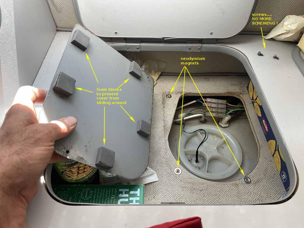

After 25 years..... no more unscrewing this cover to fill the water tank.
Just lifting it from here on out.
I was twisting the screws with my fingers, not using a screwdriver.
But still wanted to be absolved of the task. Wink

After sticking on those foam blocks that keep it from scooting around.....
it occurred to me that I could have glued on a 3/4" plywood 'plug' that drops into the hole.
And the weight of the block would hold the cover down.
The real solution is to modify the outside filler and make it better than opening the bins.

Then realized that the magnets don’t really prevent it from scooting
So I had to add the neoprene blocks,
Which, despite being conveniently Westy Gray,
we’re not aesthetically pleasing.
Gravity could be better than magnets.
(A heavy wood block that loosely engages the hole)

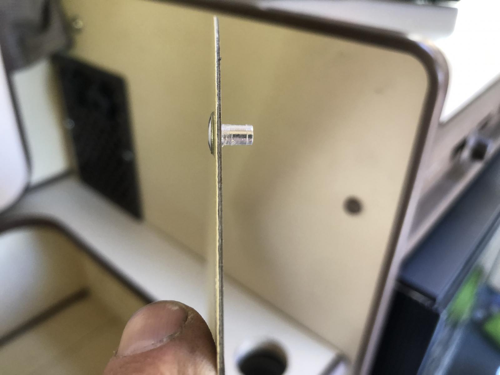

My modification was suggested by someone else here on thesamba. A pop rivet in each of the screw holes and then enlarge the hole in the wood to fit the backside of the rivet. Has worked great for years.
@Mark - I often am filling up my tank with water from a filtered water station in 5 gallon bottles so it’s much easier to dump that through the large hole on top rather than rigging something to fill from the side.

Much better Mr Heff.
Could enlarge the holes to engage the original screwheads.
Perhaps glue the screws in, but half-a-thread up.
Kittens wouldn’t even raise a brow.
And the Pop-Rivet solution. I understand much better with Andy’s pics.
That’s probably real secure.
