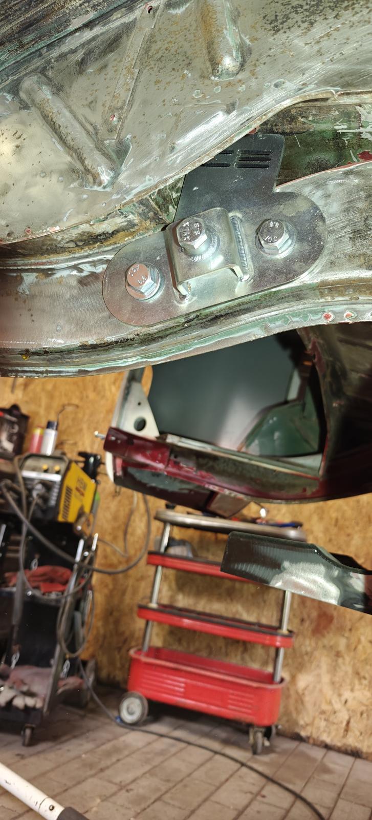

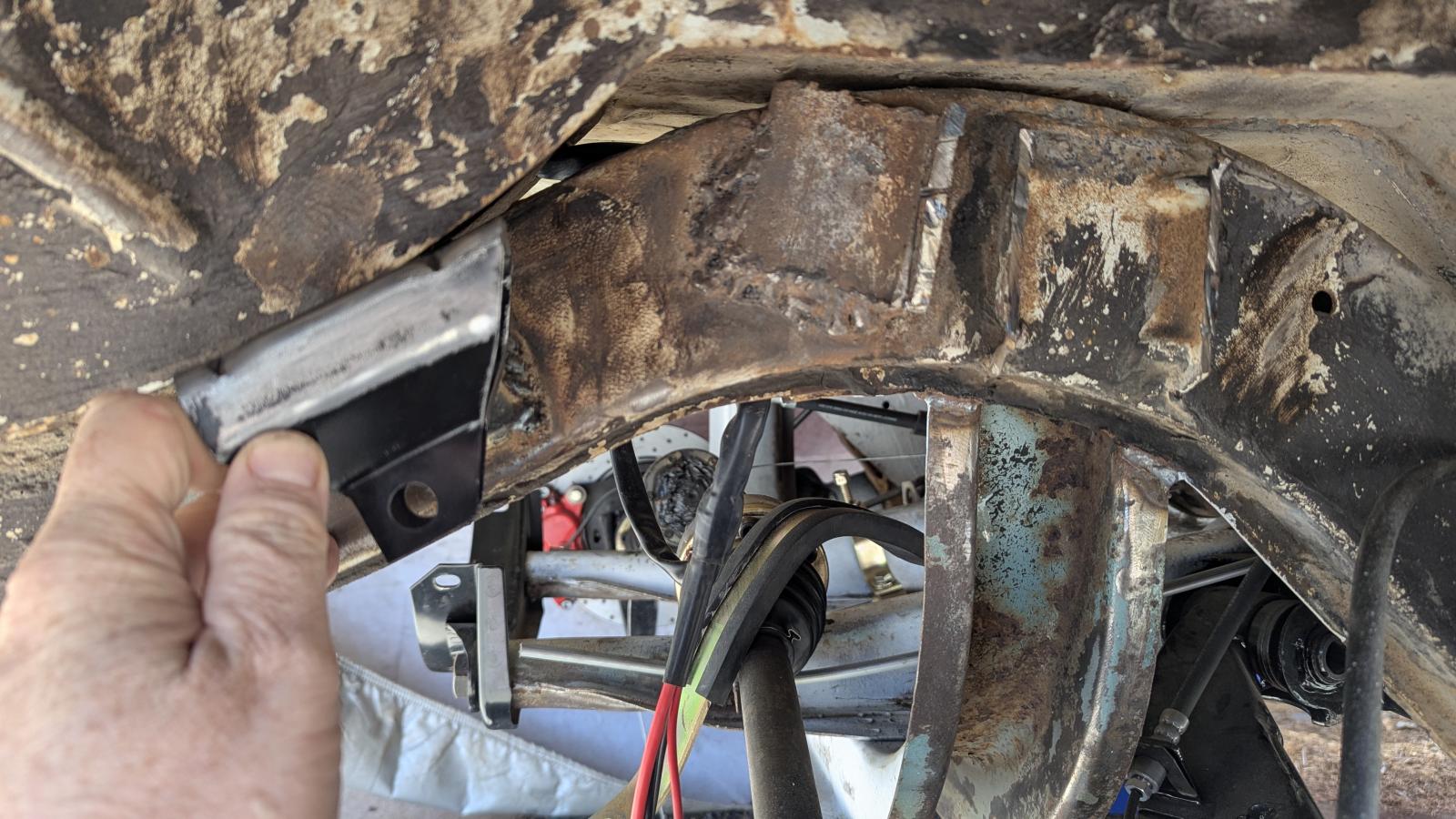

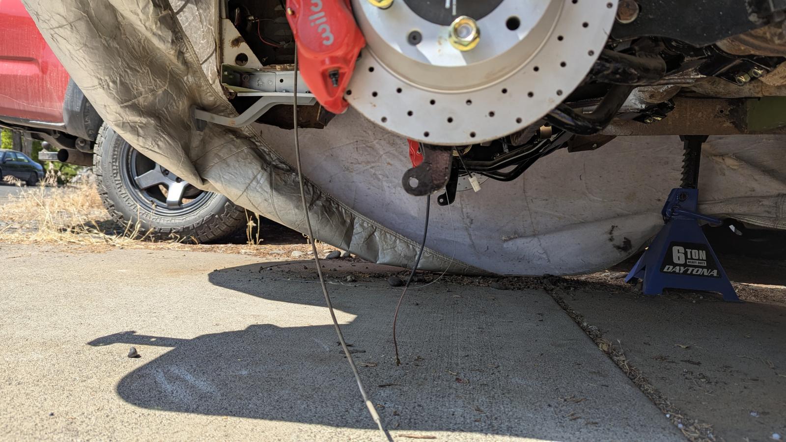

I need some wisdom.
I bought a tubed lowing kit from WagonsWest for my 62 Doka... The rear lower shock mount on the new hub plate is directly under the axle making it impossible to mount the shock in the stock mounting position. I've bought new upper mounting brackets and in tend to mount them further rearward and on their side to allow for free movement. With some reinforcement plates to give them strength under load. See pics.
I've done a quick search in the forums and don't see any info about relocating rear shocks on a transporter... Only for a bug and for off-road applications.
Has anyone had experience with this and is it safe to do this?
TIA!

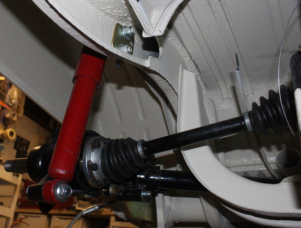

i did an IRS conversion on my bus and bought upper shock mounts from Creative Engineering (UK)
Rear hubs are from a bay window so thats where the shock mounts to on the lower side

Found a pic from their website how to mount them (it's been a while on my bus)
They also had a different style of shock mount.
Good luck!

Tell me more about having the shocks at the right angle. This is what concerns me most. Where I have the bracket in the Pic above is the steepest angle I can get with the shock clearing the axle. For the life of me, I don't know why the mount on the swing arm is directly below the hub... but it is what it is, right?
