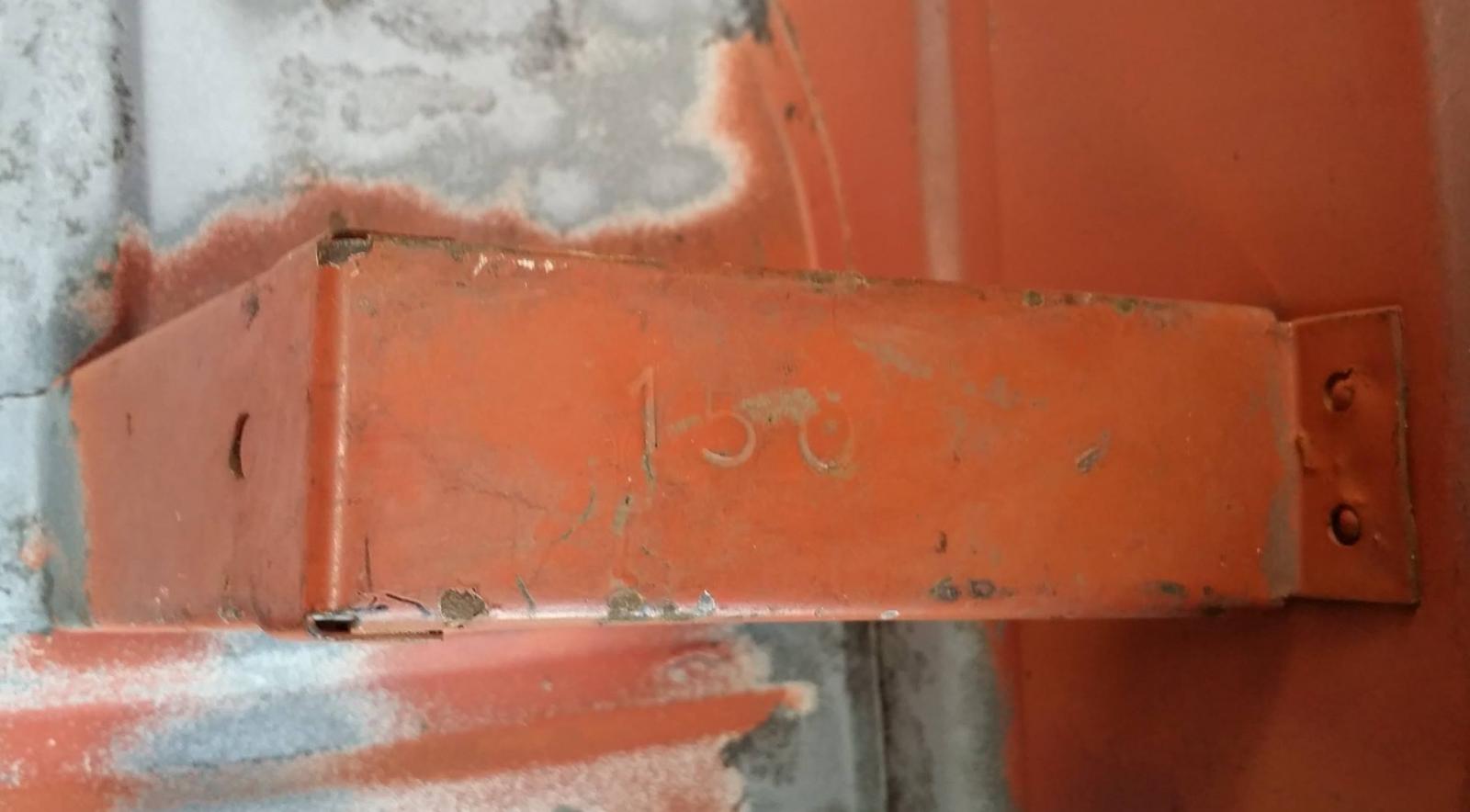

What is this number stamped on the seat support?

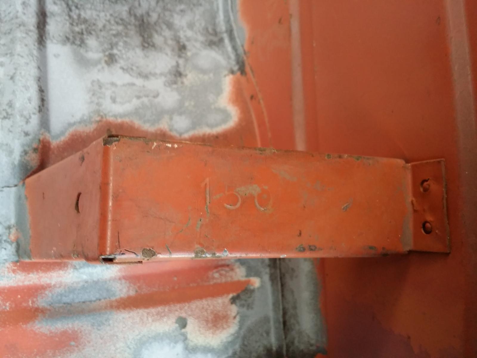

On my '57 deluxe the number '150' is stamped on top of the driver's bottom side seat support. I don't have my chassis number handy to compare.
What is this number?

maximum weight for the driver in kilograms
Crap. I guess I'll need to get rid of this bus then...

VW engineer's were so clever all those years ago that they anticipated the gradual fattening of society 50 years onwards!
150 KG= 330 Pounds Smile

I have a number there on my 57 Deluxe as well. I recall mine is 105 however.

So this really is a number for weight?

See if the number matches your sunroof header bow....both of your buses should be early enough to have a 3 piece header how.

I thought it was the last 3 digits of the VIN?
Go check that.
Go check that.
Last three of my VIN are not 105
Posts: 71512
PostPosted: Tue Sep 30, 2014 6:33 pm    Post subject: Reply with quote
How about the body #? Smile

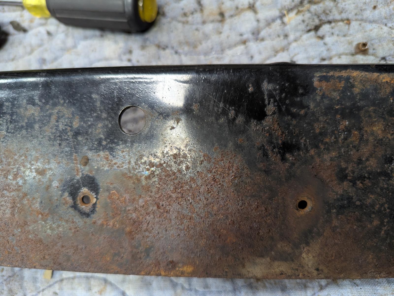

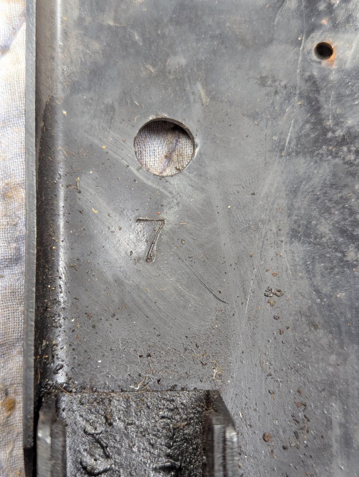

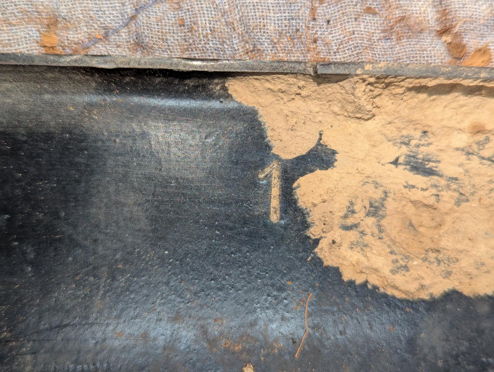

PostPosted: Sat Jun 28, 2025 1:44 pm    Post subject: Reply with quote
Winner winner chicken dinner - I finally got around to taking the sunroof assembly apart. Also, what I thought was a random dent in the top header piece was actually a single digit stamped from the underside. This part is 3 pieces welded together, and the outer 2 pieces are stamped "7" and the middle is stamped "1"
