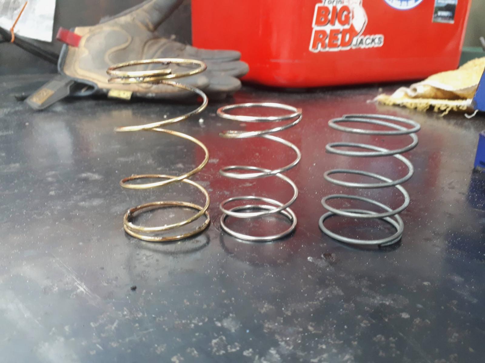

This was interesting, three different fuel pump springs
All three of them make about 3/4 of a PSI
