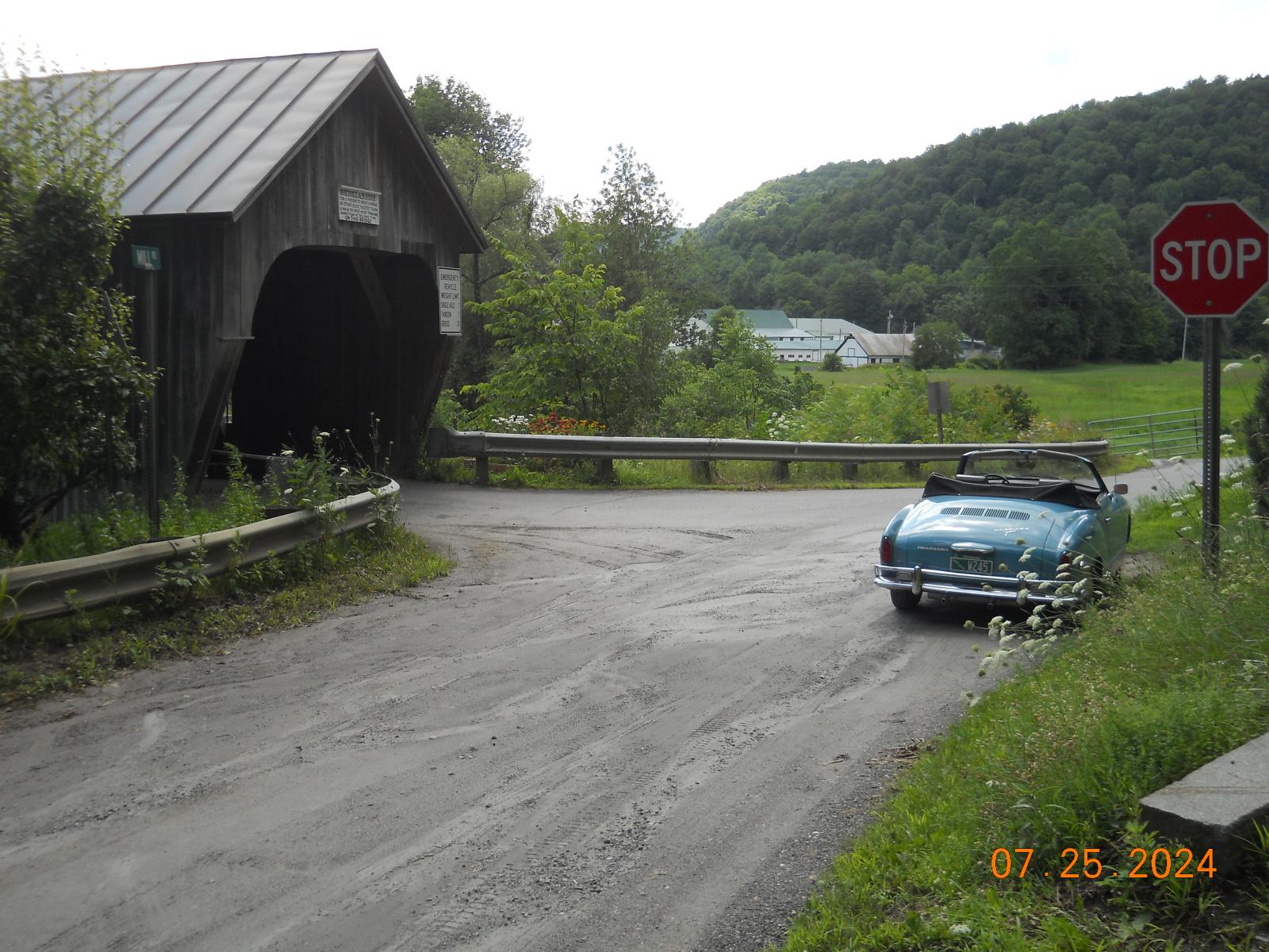

I'm having a great time driving Regatta to visit special places in Vermont. Since last fall, we had been planning to take Regatta for a drive to Tunbridge Vermont, the home of "The Tunbridge World's Fair" which has been held there every September since 1867. The road to get there is very winding and narrow though with no break down lane so it would be a terrible place to break down.
The Fair is mostly a historical and agricultural fair that is hugely popular in Vermont but it also brings in lots of people from all over the country. I first attended the fair when I was 6 or 7 years old and I even worked at the fair for 20years demonstrating violin making.
I also had been wanting some pictures of Regatta with a Vermont covered bridge which there are many in this state, but this one, built in 1883, happens to be near the Fair grounds.

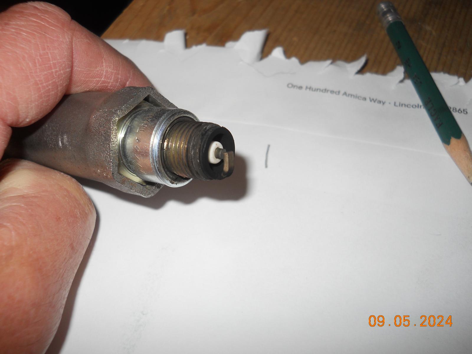

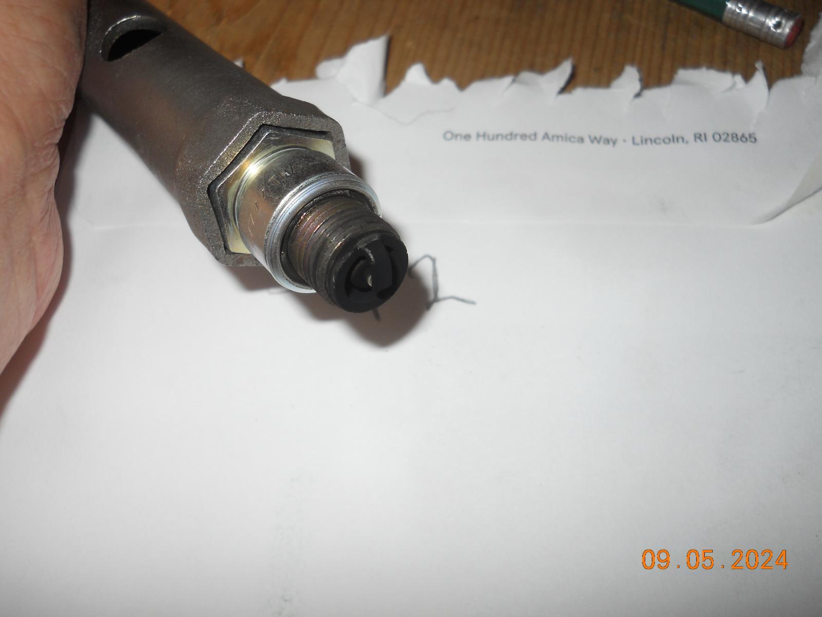

Have really been enjoying lots of rides with Regatta. I've added over 700 miles so far this summer and she's been running great until a few weeks ago when I had to turn around and come back home after a few miles. It was stumbling and had no power going up hill. First time having this issue. It seemed like it was starving for fuel. I had done a full tune up 500 miles before with all new parts after which it had improved mpg and had gained a little power.
I checked the points and they were fine. Checked the plugs and all 4 new plugs were black and sooty. Other than #3, even the centers were black? Seemed to be running rich, right? Yet the car was running great and the last fill up was the best mpg since I've had it. Cleaned them up and went for a test drive. No difference, I still had the same issue.
Turned out that the choke was not completely opening??? I adjusted the choke to so it would fully open when warmed up and that took care of the problem. I understand how that would mess up the fuel/air mixture, but why all of a sudden? It had been running great all summer?
I also adjusted the carb to reduce the fuel a bit.
Might there be more going on here? I plan to check the plugs again in a few weeks to see if they are still getting black.

Marc, on our cars we get fairly uneven fuel distribution so the differences you are seeing I'd call typical. If you want to have a go a more accurate plug reading you need to make a full throttle blast and cut the ignition, coast to a stop and pull a plug. I like a bit of a hill to load up the engine a bit.
If you leave the engine running when you get off the gas the plugs will soot up too quickly to get a decent reading, though it will tell you what you idle fuel mixture is up to.
Plug reading is a great tool to improve performance/economy at very little cost Smile here's a good video for an overview:
https://www.youtube.com/watch?v=MecCoercp-s
to get a reasonable idea you can look down the plug with a torch and a 10x ocular rather than cut it open.
