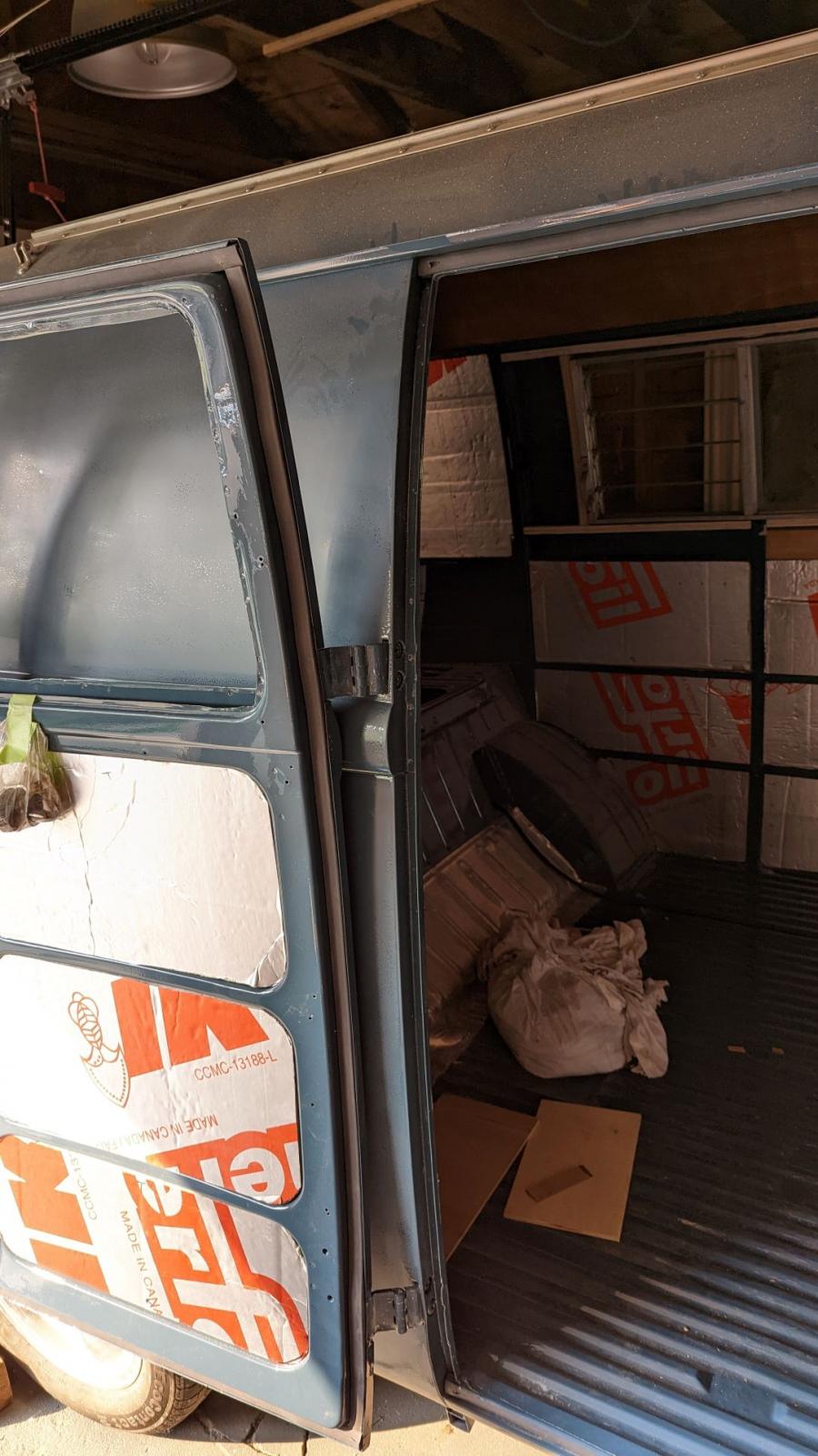

So I place my seals in as per the diagram and the door is pinching in the top and bottom corner. Is this common? I'm not sure if its my crappy body work shifted the hinge locations. I've tried adjusting the door location with no improvement. Is it as simple as trimming some foam off the corner?
thanks for any guidance

PostPosted: Tue Sep 13, 2022 9:12 am    Post subject: Re: Door rubber pics and information Reply with quote
What door are we looking at here? Need a wider shot. It is not uncommon to make modifications to aftermarket seals.

PostPosted: Tue Sep 13, 2022 11:38 am    Post subject: Re: Door rubber pics and information Reply with quote
sorry if this is a double post
here's a wider angle view of the dooor

PostPosted: Tue Sep 13, 2022 12:34 pm    Post subject: Re: Door rubber pics and information Reply with quote
The first thing you have to establish is your door fit without any seals in place. Hopefully your metal work is spot on otherwise this is gonna turn into a fight to get the seals to seal.
One of the big problems with new seals is that they are not the originals. New after market seals will be uncompressed and usually too thick. A good tool to have is a bench belt sander to sand whatever thickness you desire. I had to do this on several new seals.
Look at my photos and you can see the indent in the seal that you want. I was lucky and reused my original top double door seal. That is the type of indent you want to achieve on most all your seals. This shows the door is sealing properly.
You are pinching at top and bottom? The pinch should be even all across the top. If you are not getting that pinch indent all over then it may be the doors are not fitted correctly.
Bill

PostPosted: Wed Sep 14, 2022 9:24 am    Post subject: Re: Door rubber pics and information Reply with quote
Thanks for the insights Pepperbilly. The doors seemed to close fine with out the seals so I think the body work is reasonably good. It looks like the seals are too thick and I'll need to sand them like you suggested.

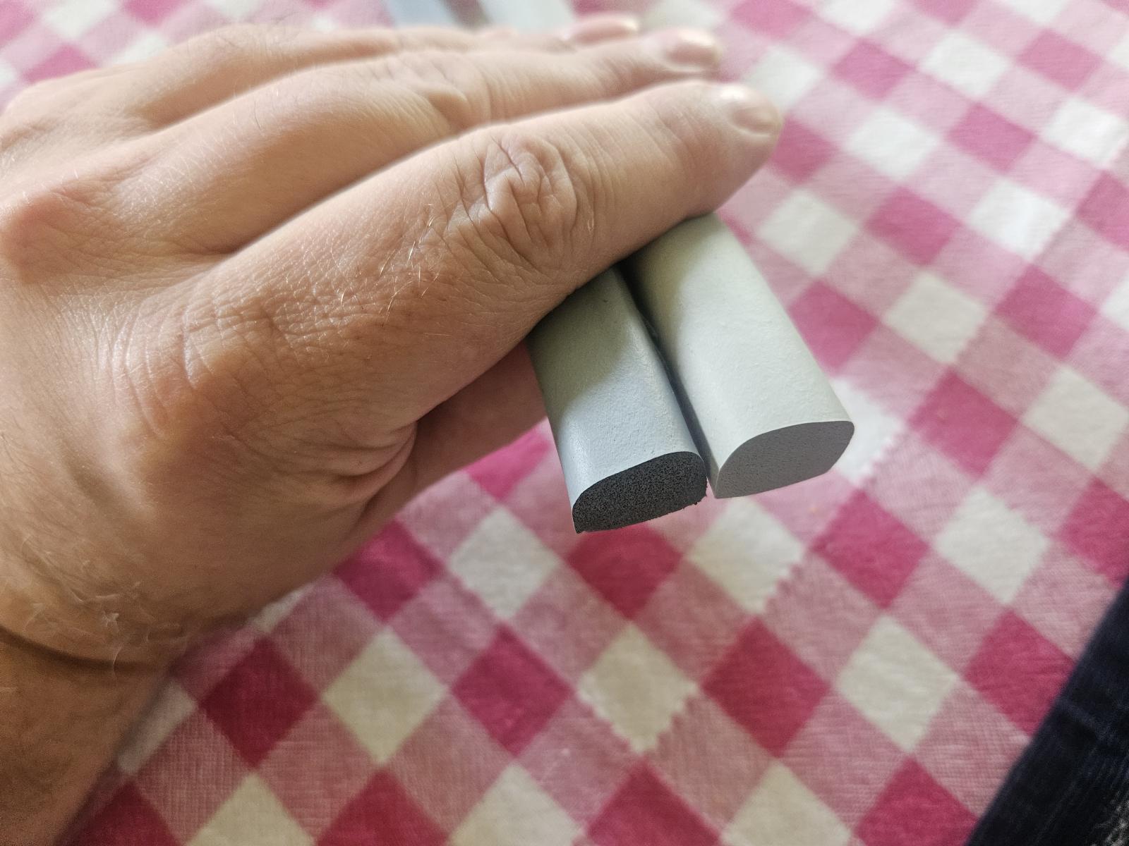

I am having a devil of a time finding the weatherstrip on the left.
I need the smaller, darker, less firm variety for the cargo doors on my 67 SO-42, for a variety of reasons.
I found out the hard way that both West Coast Metric and Wolfsburg West sell the same product (on the right).
Please help. All leads appreciated. Thanks!
"Get in the bus!"
1967 SO-42 Campmobile "Klaus"
That's weird... I bought a set from WCM in July 2024 and received the darker stuff on the left. I had a couple of issues: the pieces for the door tops were too short... they are supposed to taper as they approach the locking rods. I ended up grabbing pieces from another set and belt sanding the ends. The other problem I had was that the doors wouldn't close/latch until I thinned the long piece on the forward door. I took about 2mm off on the belt sander. Now everything fits great.
I recently bought a set from CIP1 and received the lighter stuff on the right. Haven't tried it yet, but it seems too narrow and will need gluing, although its soft and more compressible than the darker seals.
