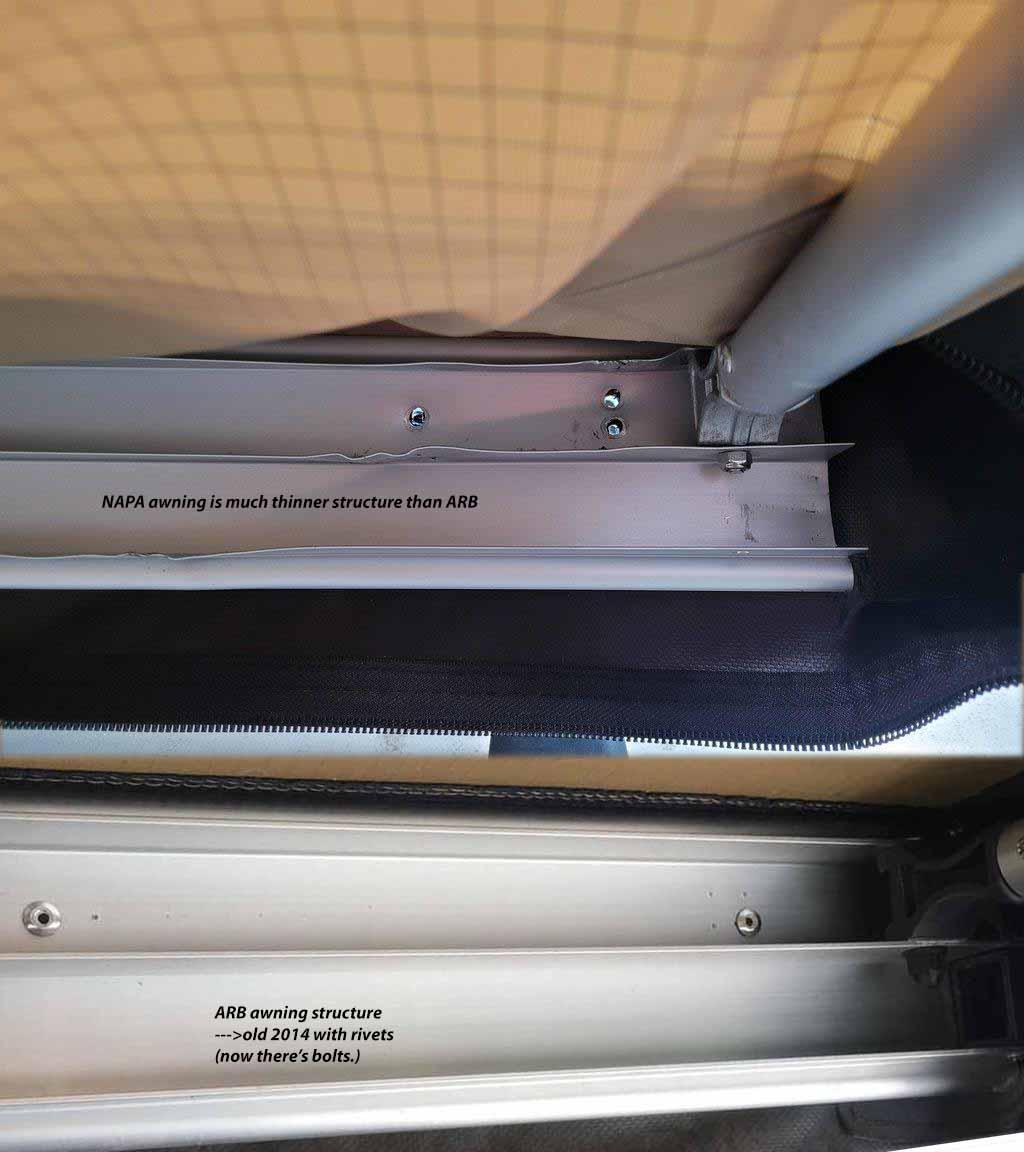

Here's a pic of how the NAPA awning skimps on aluminum.
ARB skimped on rivets back in 2014, but at some point they changed from rivets to bolts. If you have the old single-rivet you should add more rivets. I added 3 rivets to each one (on each side of the gutter-mounts)
Maybe NAPA is out of stock because a lot of people had to buy new units for 2023 Van season?
Which is not ill-logic, seeing as they cost about 1/3 of ARB, how long will it take to go thru 3 NAPA awnings?
In some ways, this is valid cost-savings.
Except for the waste of materials.
And if you're super-careful about wind and stuff.
Or maybe you Crying or Very sad Crying or Very sad seldom un-furl it. Crying or Very sad Crying or Very sad
But the biggie is.....
If my awning was a wadded up twisted mess on the side of the van, during a week-long trip..... I'd be wishing I chose the ARB.
The ARB above is 2014, 9 years old (now with 8 rivets where you see two)
I've had the ARB out in some fierce winds.
But, you do have to be careful and tie it down properly etc.
Stakes wiggle loose, you have to tie it to bushes etc if it's risk of wind.
Much wiser to roll up if there's a risk of wind or un-attended.
....KTMs, GasGas, SPOT mtb

Thanks for those comparative pictures, Sodo.
It's great to actually see the difference between the parts. It helps people to consider if the very flimsy cheaper part is worth it, even at the low price.

I used the tape wherever it touched the paint of the van. Acorn nut for covering exposed threads after the fastening nut, to prevent snags.
No holes in to pillars for me. Thats your call. If I did a bunch of off road roads. I probably would. But do research this thread for excellent guy line examples.
