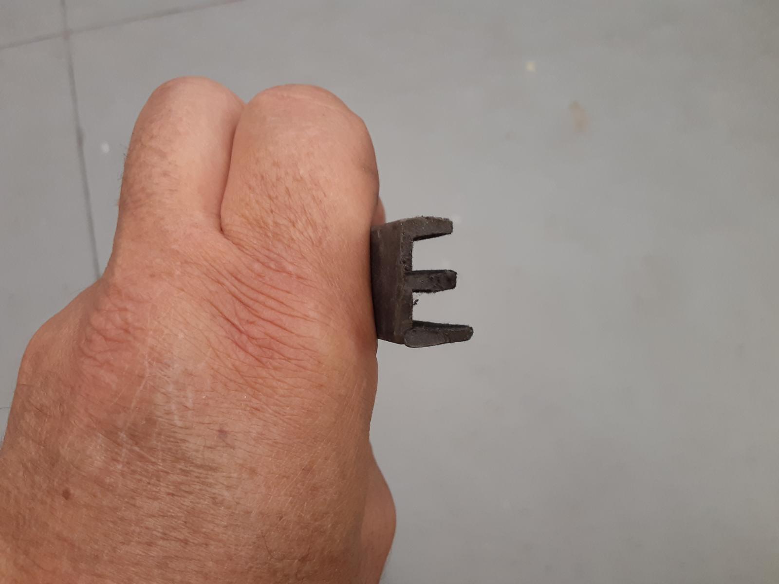

House
Minutia Militia
Joined: June 13, 2001
Posts: 1899
House is offline
PostPosted: Sat Jan 04, 2025 9:43 pm    Post subject: Re: Sigla felt channels Reply with quote
They are used in more than one spot and a couple different sizes and shapes.
I will have to do some digging some to show what I am talking about…
Here are some from MR:
https://www.thesamba.com/vw/classifieds/detail.php?id=2485273

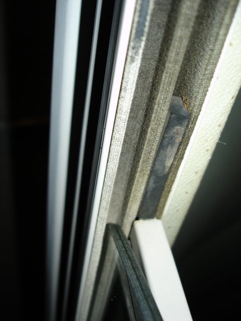

thom wrote:
How does the thickness of the bottom of that felt compare to an original? I don't recall them being that chunky.
This image is from the gallery of another felt, obviously not the Sigla version - and may not even be original.
I wonder if you'll even be able to close the door with a set of these installed. Usually the clearance at the top of the door is super tight.

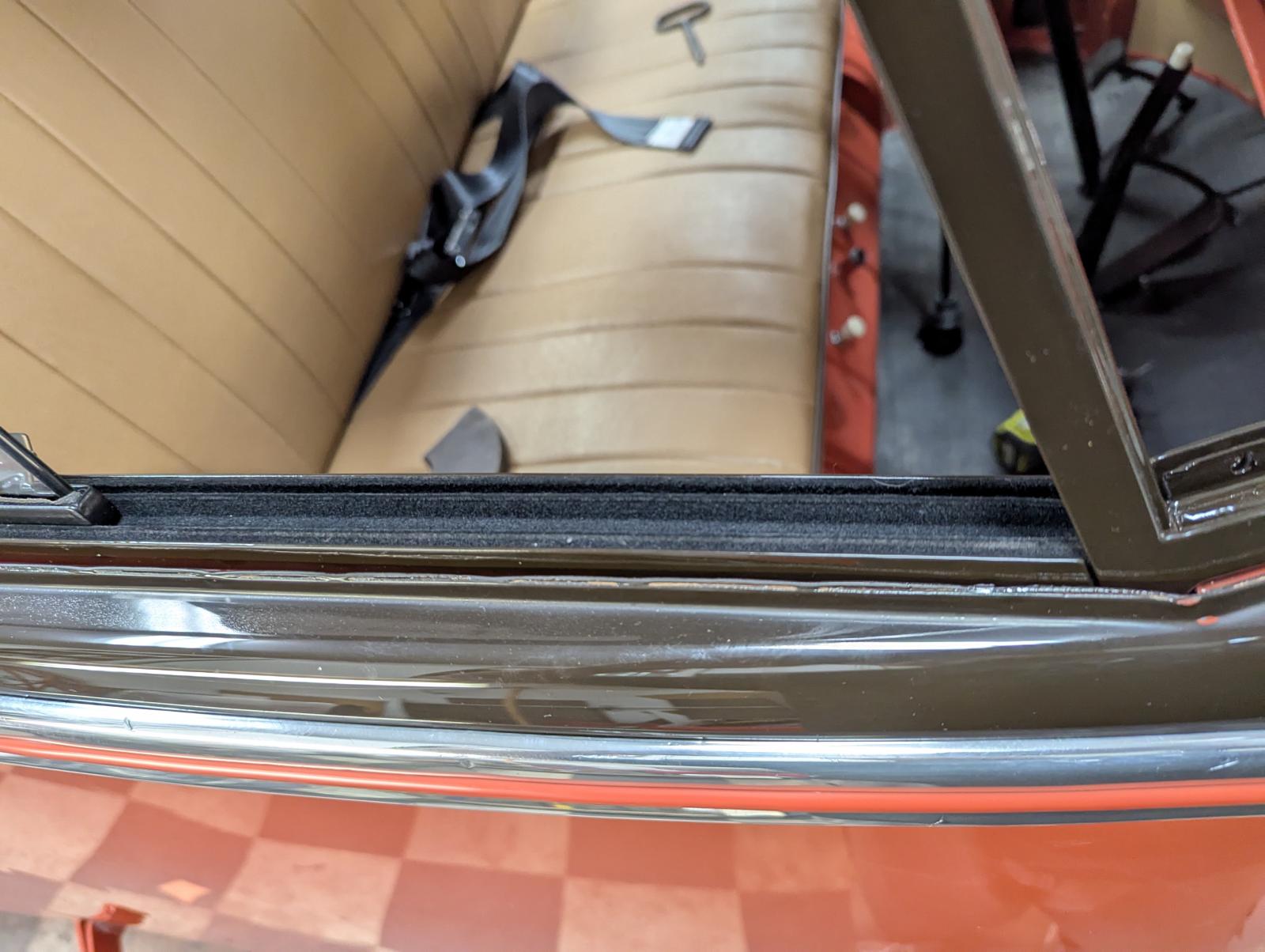

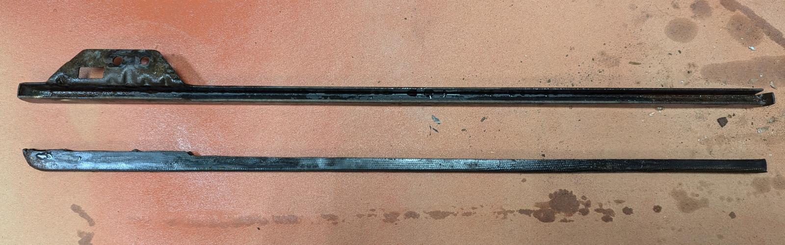

thom
Joined: October 12, 2000
Posts: 6133
Location: Sacramento
thom is offline
PostPosted: Wed Jul 02, 2025 9:21 am    Post subject: Re: Sigla felt channels Reply with quote
I've finally got around to assembling my door windows. To start with, I did a dry fit of the EIS felt channels glass, and slider bar. At first glance, it seems to be OK. There was concern because the bottom of the reproduction channel is really thick, but it doesn't seem to be an issue. I don't have an original on-hand to measure, but my guess is the top is thinner so it sort of evens out. I'll have a better idea once I start assembling them for real.
What are you guys using to join the glass in the slider? I used a couple layers of electrical friction tape, which seems to be holding them pretty well for now. I tried using a cast-off safari seal, but it kept wanting to pop back out.
