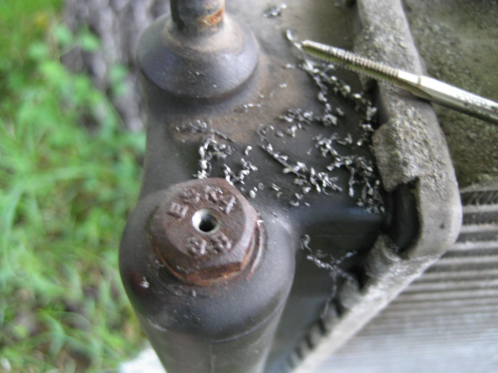

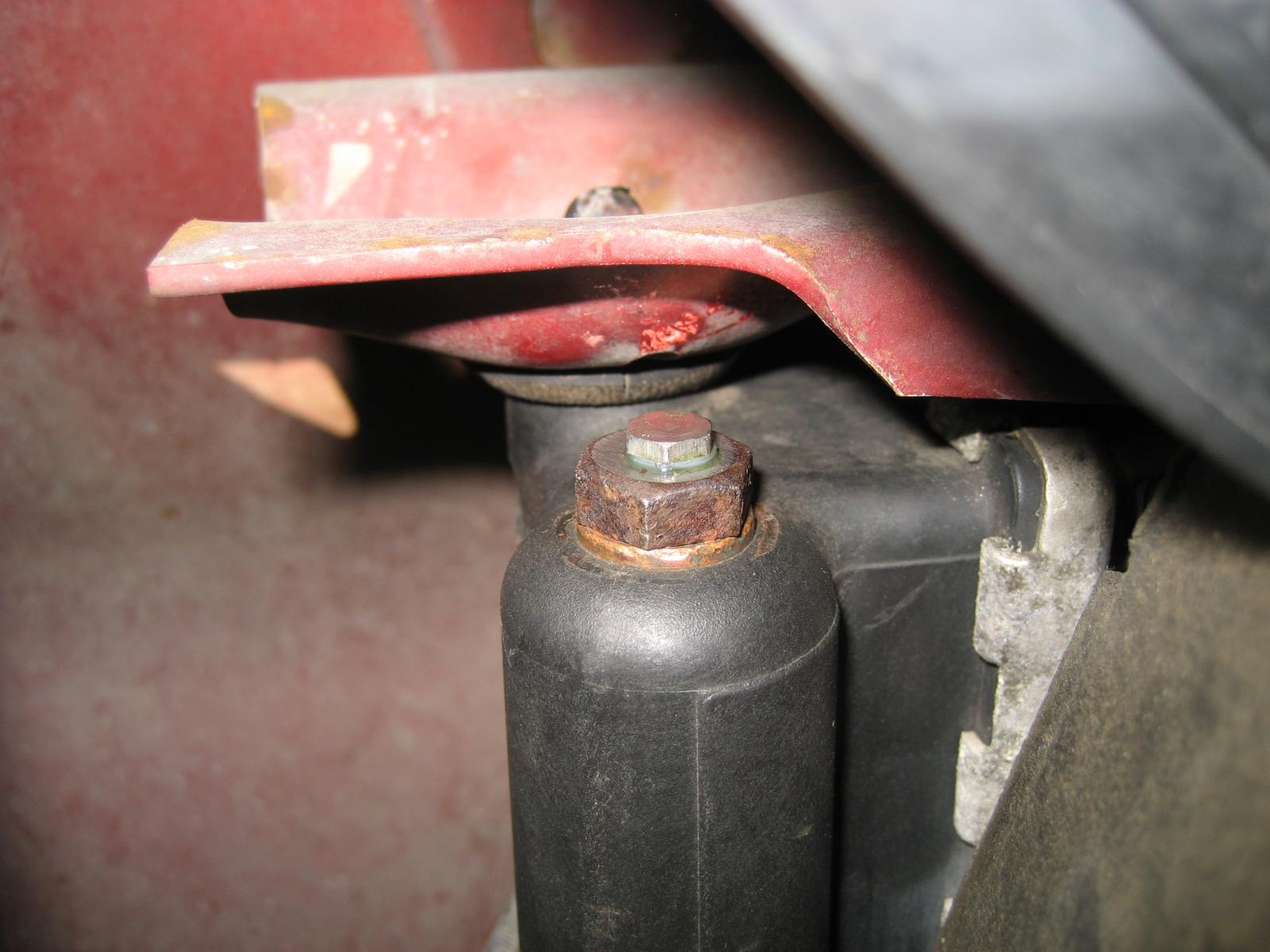

Van den Broke wrote:
Thanks for all the suggestions.
The drilling idea got me thinking - I could drill a small hole in the bolt and thread it for, say, a 3mm (stainless!) screw to bleed it.
If I were really lucky I could loosen the radiator and tip it forwards at the top so I could do the job without having to remove it.
When the van is warmed up the radiator is only hot on the lower third, which seems to indicate that's the coolant level. In other words I have one third the cooling potential of a properly functioning system.
But the climate here is not too hot so it's been okay for the few years of ownership.
I did try putting a 13mm box wrench on the bolt and tapping it many many times with a big brass bolt, I will also try the suggestion of heating the bolt gently while shielding the rad.
Cost is an issue, the only way my family afforded this beast was by squandering a small inheritance to pay for it. Luckily I can do all the repairs and maintenance myself, so far.
Before this the most expensive vehicle we ever bought was $3500.
I be very skeptical of using heat. you heat that bolt, well the brass insert will also heat, and that in turn is secured in the plastic radiator side tank, then you try to turn the bolt, and you may end up tearing out the brass insert. Then it is game over for that radiator.
Use penatrating oil, if that fails try to drill out the bolt. Drill it to just avoid touching the threads, then use a tap to clean out any remaining bits of the bolt threads from the brass insert. This is the safest bet if penatrating oils dont work
for rusted in bolts, one usually needs high heat, but that will not work with the plastic. That brass insert is very likely held from turning in the plastic by delicate splines which have dug into the plastic, get that insert hot, and then try to turn the bolt and the splines in the plastic will rip away, and you will be stuck with a leak or spinning insert.
I reckon the temperature needed to break free that bolt from the insert does far exceed the temperature that the insert to plastic interface can accept without failure.
For better access to the bolt you just grind off some of the metal above it (oh sacrilege!) To bleed it just run it til hot then park it with rear end raised.Any air will collect in the expansion tank. Fill it full and overflow to max. You don't have to deal with the rad bleed screw.
Call Malahat auto for a used rad on the lot or put you on a waiting list. You might get lucky with a fairly new wreck just in. Be aware that "anything vanagon will be expensive" they once told me.

PostPosted: Tue Jul 01, 2025 5:10 pm    Post subject: Re: Bleeding cooling system with seized radiator bleed screw Reply with quote
I heated a box end wrench with the propane torch to indirectly apply heat to the hex head but this didn't free it up. I agree that heating is not really practical in this case.
I really like Wesitarz' idea.

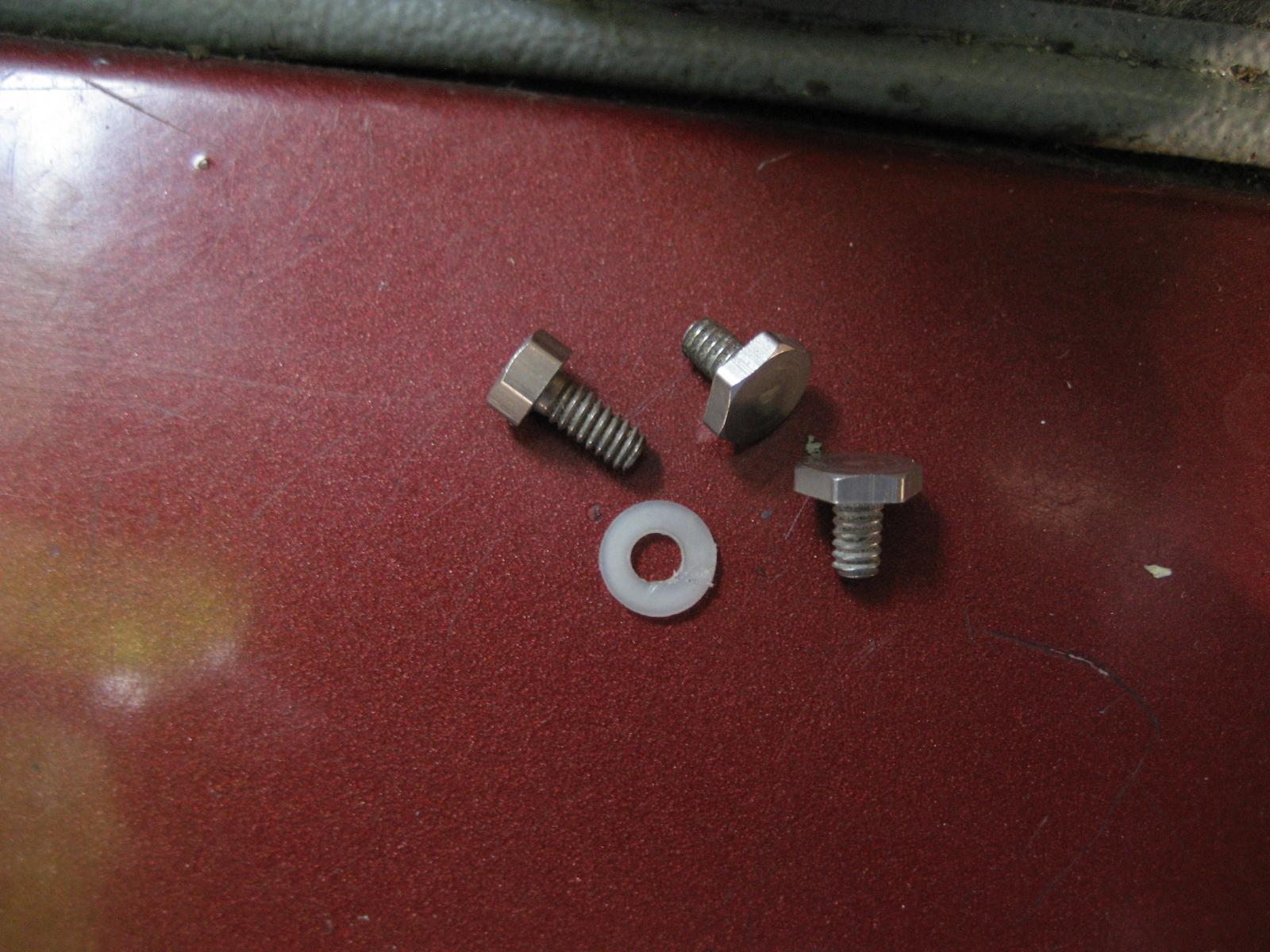

PostPosted: Tue Jul 01, 2025 5:13 pm    Post subject: Re: Bleeding cooling system with seized radiator bleed screw Reply with quote
When I snapped the Nissens plastic screw/bolt I put some JB Marine weld on it then ground it down,cut a slot in the plastic screw/bolt with a dremel and unscrewed it later when I had a replacement bolt.
I replaced the original rad when the bleed screw just spun in place which may be the case here.

Okay, so I took the radiator out and drilled and tapped for a small bleeder screw.
First I center punched to locate the hole accurately in the center of the existing M8 hex head screw:
Drilled it 3/32 then tapped 4-40:
Chamfered hole, filed surface flat (not shown):
Here's a few SS 4-40 machine screws for trying, with a nylon sealing washer:
And here it is all back together:
It worked just fine, I oriented the van nose down and topped up the coolant reservoirs. Then I removed the screw and listened to the slight hissing of the air coming out, and then quickly put the screw in.
Over the next couple days I bled the system when it was hot by just loosening the screw a little as there wasn't much air to come out.
When the engine got hot, the whole radiator got hot! Success!
