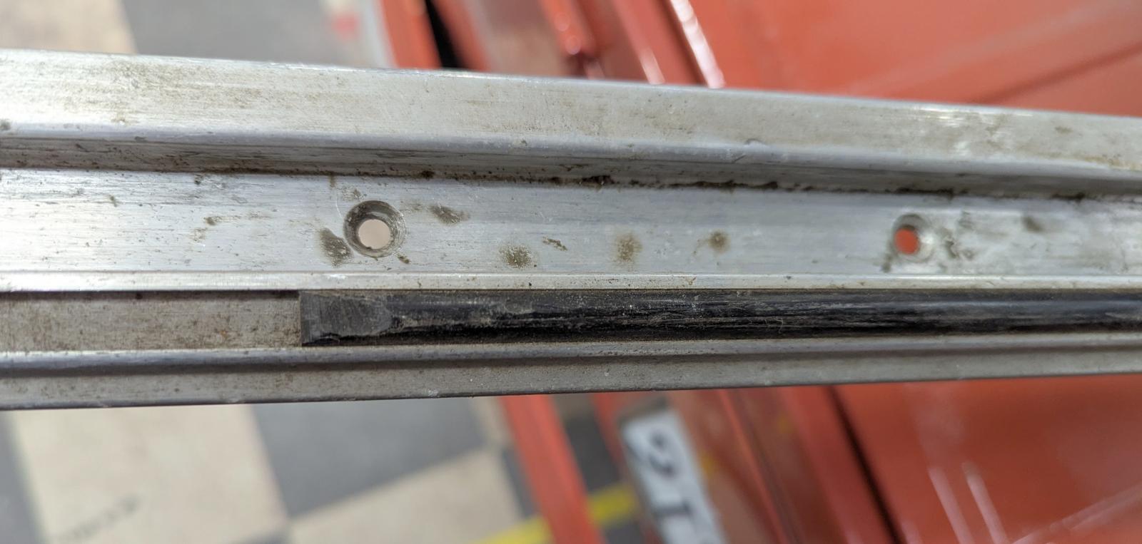

I don't know what this strip is called; it's similar to the deluxe beltline and rocker trim insert, but just ever so slightly narrower. Is there a source for it?

I have always used the beltline trim insert.
It's best that it sits up in the track to help prevent wear from the sliders.

End of beading insert:
http://www.thesamba.com/vw/forum/album_page.php?pic_id=894951
As far as I know from looking at the parts books the beading is the same as the belt line insert but the shape looks different because it gets squeezed in there differently.
I could be wrong though.

I looked it up on OACDP and it appears to be the same part number

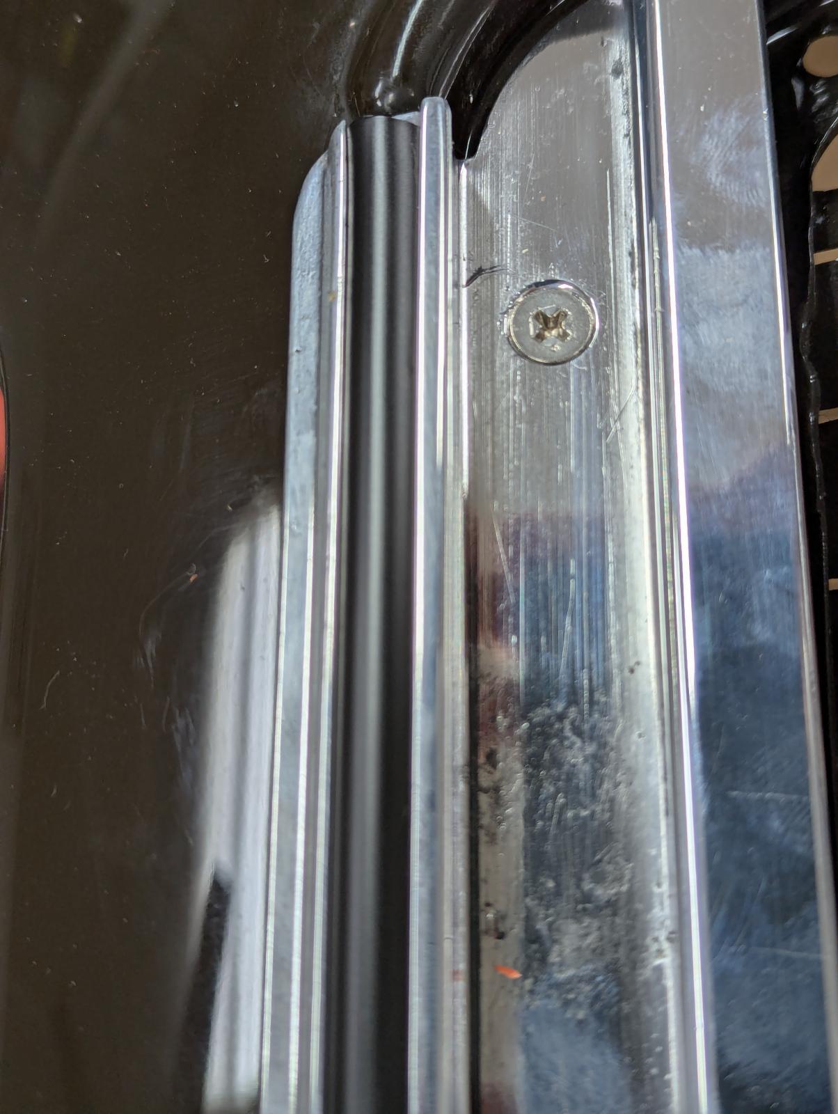

For shits and giggles, I put in a little bit of the SWR insert just to see what it would look like
And the basic black
