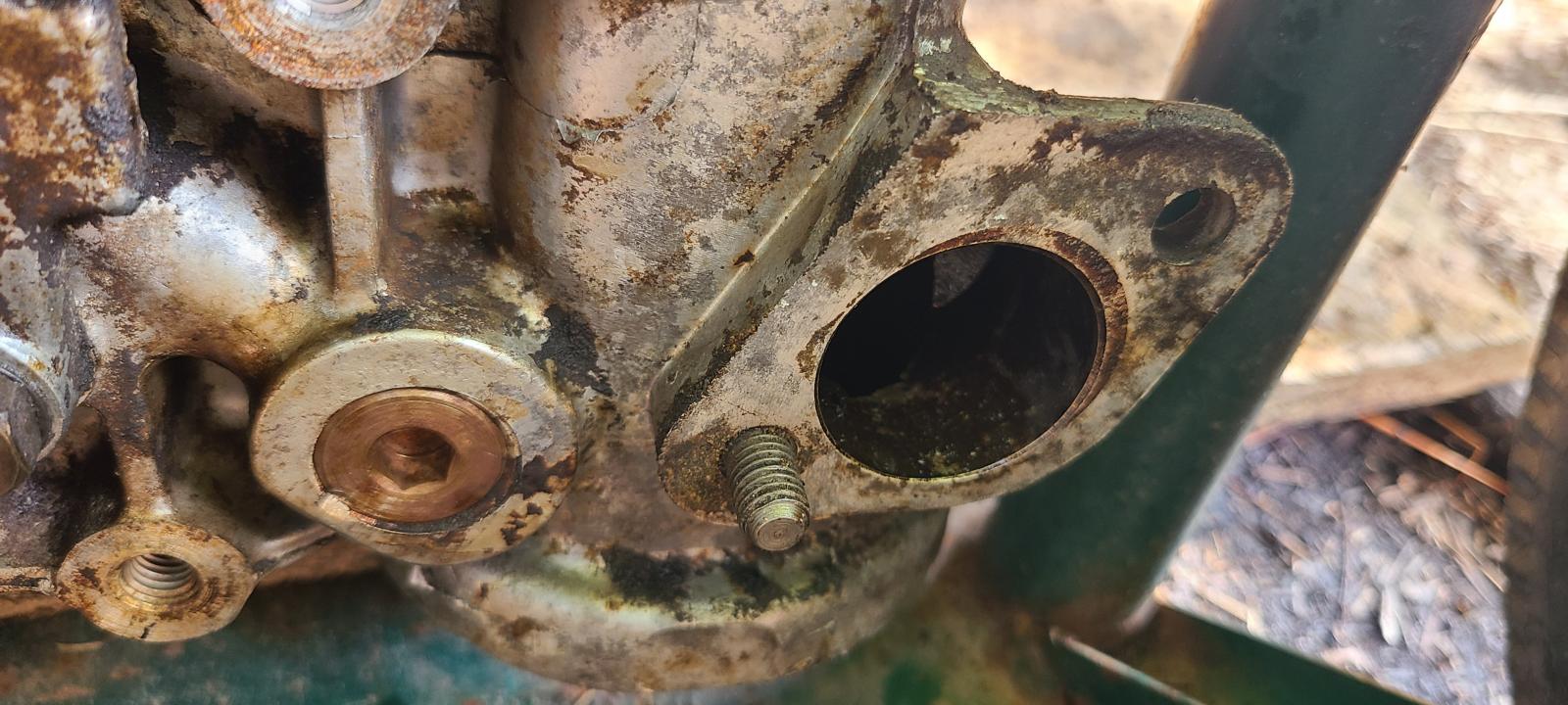

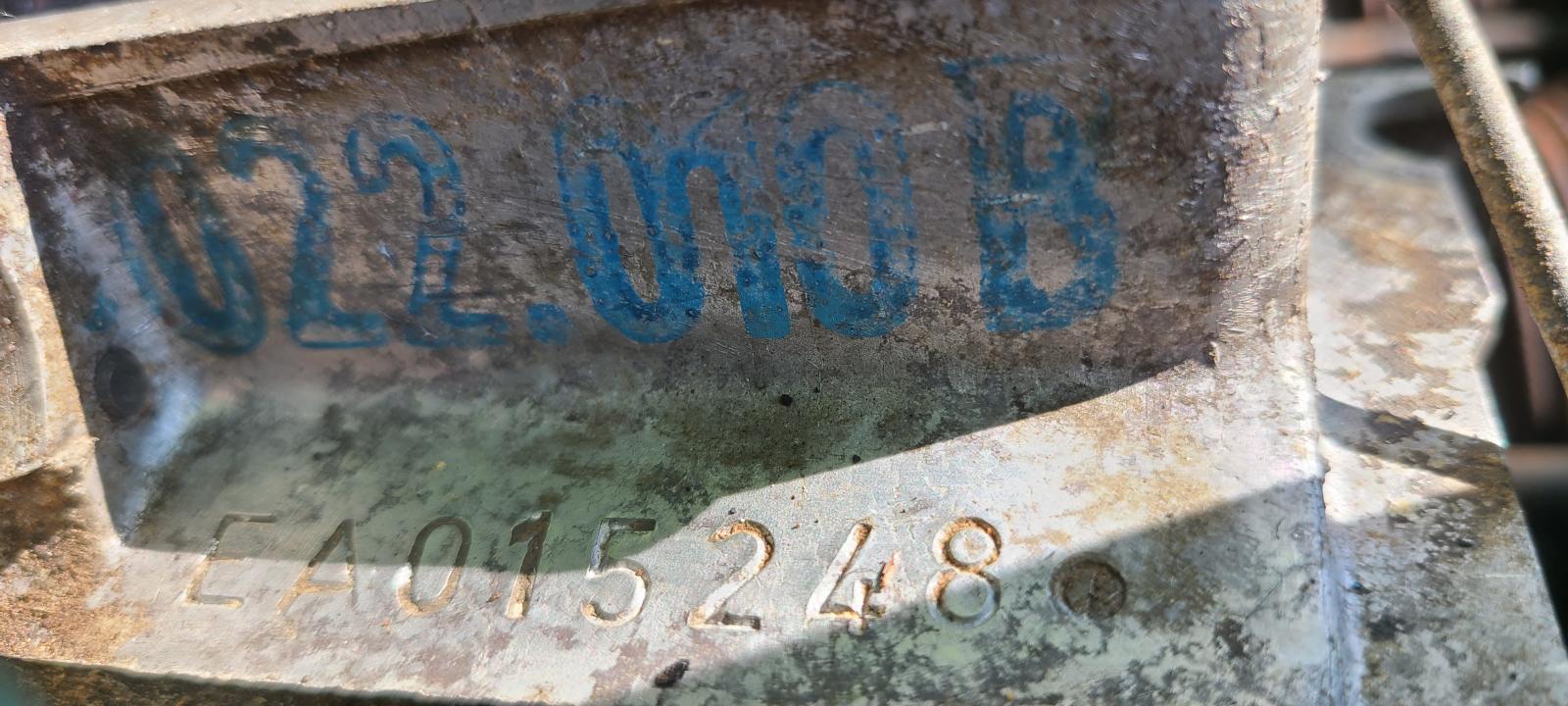

Were EA engines exclusively for 411, 412 and Porshe 914? Did they ALL have the oil filler tube on the breather on top of the engine? Were they ever used in busses or did any of them have the bus style oil filler tube?
I picked up a EA engine longblock that's been sitting for decades. It has the hole on the bottom right to attach the bus type oil filler tube. Maybe it was machined out at some point? I don't know enough about these and searches are not clear.
For engines in Type 4 cars I believe the oil filler location varied with body style.

Wildthings wrote:
Yeah, Ray might be the final answer here, but I think some were in the rear lift gate sill like the type 3's.
