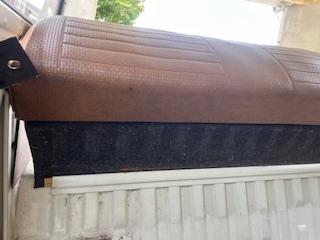

Hi everyone, I can’t find anything on how to remove a 78 transporter hinged backrest. I’ve followed all the steps and now the only thing stopping me from removing it is a fabric flap sewn onto the back of the seat cover, it’s pinned by a tuck rail on the body of the bus just behind the rear seat bench. Is there a trick to freeing the fabric without cutting it or damaging the rail itself by prying on it? Any ideas welcome, thanks in advance.

I'm not sure I've ever seen one intact, can you post a few pictures so I can devise a plan?

Here is what we're working with, there's a thin cardboard strip sewn on the hem I imagine to help keep the fabric from slipping out.
I've tried weaseling it by pushing the fabric+cardboard strip up with a thin flathead at one end and pulling it up at the same time, but it's in there pretty snug and hasn't budged. I will say the fabric is in good shape and is still somewhat strong.

That's a very German way to attach fabrics in many different cars.
With the tension on it relieved there should be just enough slack to push it down and get the top edge of the cardboard out from under the lip, a wide putty knife will help keep it from sneaking back under as you work your way along. The very end may have been bent shut a little, you might have to pry it open a bit there.
If you do decide to pry it open all the way along do it from the other side of the carpet with something thin and wide, that will open the gap without brutalizing the channel.

Thank you! I followed your suggestion and successfully removed it mostly intact, the fabric ended up separating from the strip but nothing to cry over. Just happy its out, Cheers!
