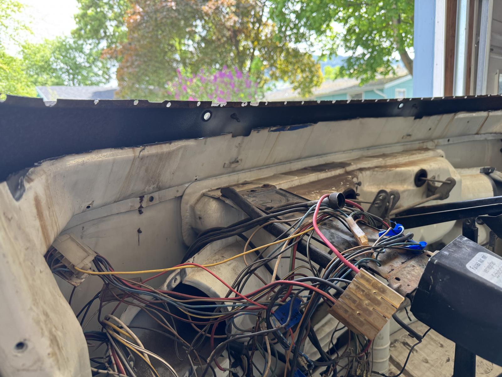

Hey, wondering if anyone has experience removing the brackets that hold up the dashboard.
I am cleaning up the rust and making a plan to repair the lip around the panel
I’m trying to figure out if it slides in to some slots and if I’m able to hammer from the bottom and pop it out or if it’s welded in. Don’t want to gorilla it and mess it up. Thanks

PostPosted: Sat Feb 22, 2025 2:12 pm    Post subject: Re: Finally in a VW! 1971 VW Bus Riviera Reply with quote
No experience with that support bracket.
I'd bet it's spot welded to the front of the lower windshield opening.
If you can reach under the support, can you sand the paint away and look for spot welds?
If so, if it were me, I'd drill the spot welds and remove the support as cleanly as possible.

PostPosted: Sat Feb 22, 2025 2:59 pm    Post subject: Re: Finally in a VW! 1971 VW Bus Riviera Reply with quote
Thanks just came back to report that I found the spot welds, they were hiding.
Windshield wiper assembly removed. Going to start taking some measurements for the support brackets so I can weld them back in place after repairing the inner windshield support. The corners of the windshield will be replaced with some panels I found at heritage,the rest of it will be interesting. Luckily the dash support brackets follow the contour of the panel so I’ll be able to use those to help me make some repair sections

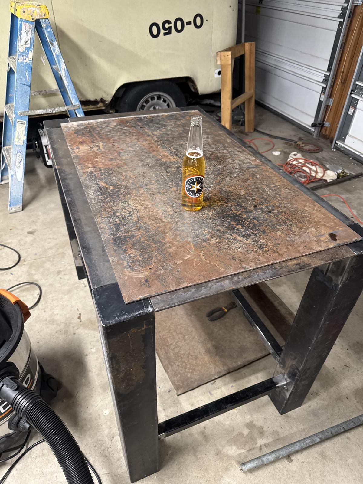

PostPosted: Thu Mar 27, 2025 10:48 pm    Post subject: Re: Finally in a VW! 1971 VW Bus Riviera Reply with quote
Got side tracked while removing spot welds. My welding situation wasn’t great and figured if I was going to be fabbing up some parts needed a real welding table, so built this. It’s tacked up and I have a 1/2” plate that’s about 3/4 the width and will be putting my vice on the remaining space. Pretty happy with it while drinking a few beers making sure no sparks set anything on fire Very Happy
1971 VW Bus Riviera

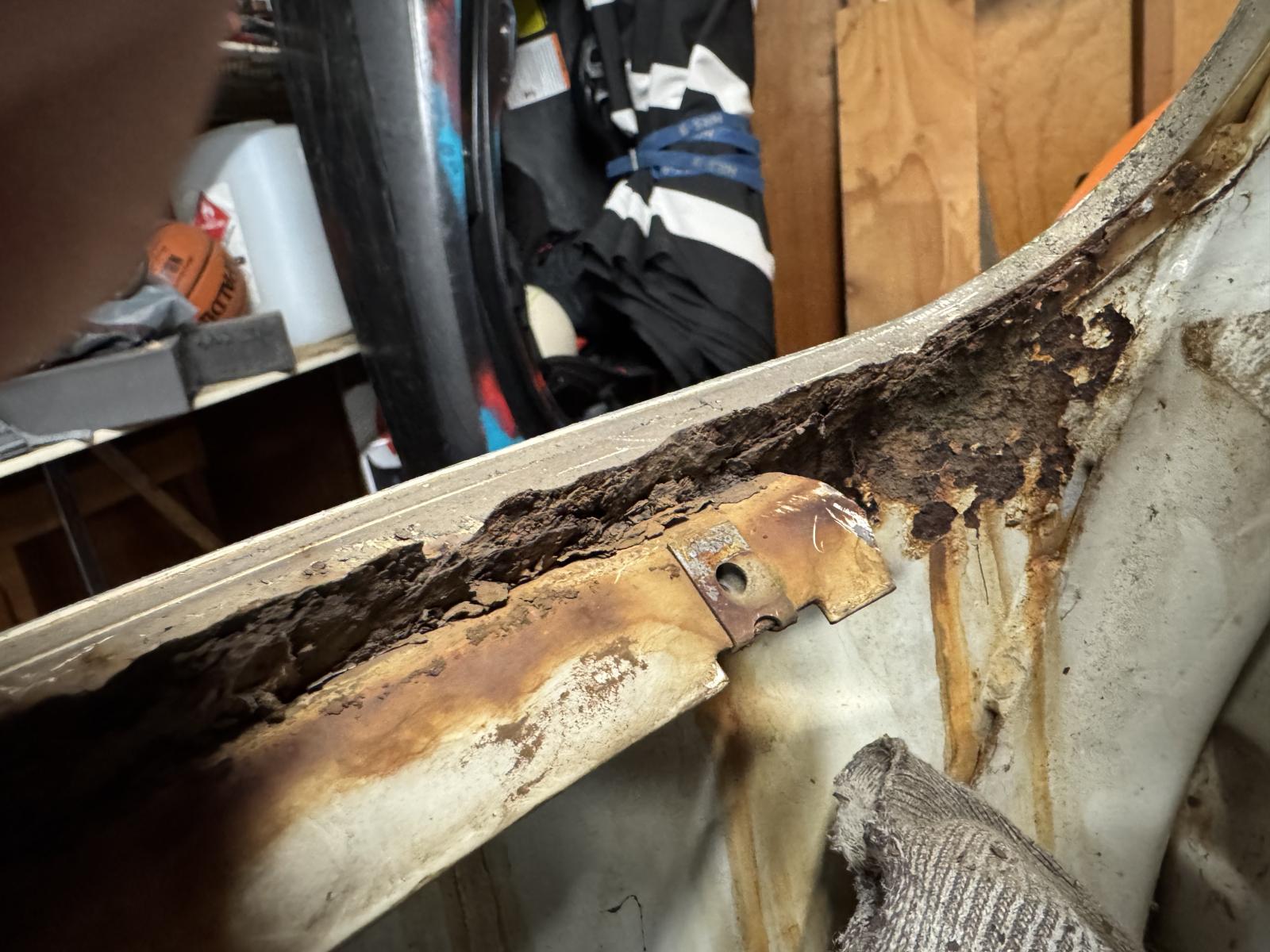

PostPosted: Mon Apr 14, 2025 4:38 pm    Post subject: Re: Finally in a VW! 1971 VW Bus Riviera Reply with quote
Alright all, got the dash brackets off. For others that may do this there were 10 spot welds on each dashboard support bracket. I drilled out the welds with drill bits as I found the spot weld cutter kept breaking and the bits were faster. I used a paint scraper and hammer to cut through any remaining weld left over.
The blue painters tap is my proposed cut, my thought is cutting out this larger section will help with aligning it all later. It will also give me access to check the metal in that area and treat it appropriately and remove the built up rust between the seams.
Let me know what you think, “Pete that dumb too much work!” Or “Hell yeah that’s the proper way!”.
Figured this is a worthy repair since a lot of the interior damage, ie floor pans and electrical were due to water damage

PostPosted: Sat May 17, 2025 3:29 pm    Post subject: Re: Finally in a VW! 1971 VW Bus Riviera Reply with quote
Small update, commit to it and made my cut today.
Happy I went this route, found some surface rust which will be nice to treat and have the piece of mind that I’m taking care of any rust behind the nose panel.
Measured the sheet metal and it’s right around 20 gauge, so going to pick some up this week to start the corners of the windshield lip. Hoping to be able to fabricate the pieces I need instead of buying.
