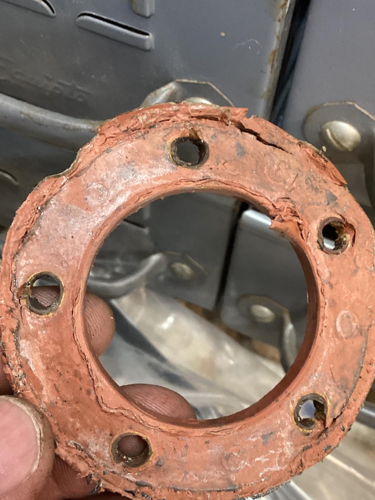

Any TRUCK owners remove their gas sender without removing the gas tank? Just making sure before I unbolt the divider panels and crawl in there that I won't be blocked by 1/4" or something annoying.

Almost a decade ago I just removed the fuel tank on my '59 D-Cab (which of course does not have a fuel gauge or sender). It wasn't that hard to do. I doubt that you can remove the sender in yours straight upwards without cutting a hole in your load bed. Drain the tank, remove the fuel outlet/drain assembly with filter sock, and un-strap the tank. Maybe you could rotate the tank enough to get to the fuel sender, loosen and remove it, but your neck and back will be broken by then from all the contortion-ism. Probably easier to continue to remove the tank! Pull the tank towards the driver side, and rotate the empty tank about 90 degrees as you manouver it out through the vertical rectangular opening on the driver side into your S.C. treasure chest area (or under rear seat stowage area on a D.C.) and then outside.
Have a new fuel "sock" with fresh red gaskets, and the thick spongy foam gasket between the tank bottom and the chassis on-hand as you'll probably want to replace them all while you have the tank rotated or removed.

For the record - a truck owner can easily remove a sender fom the tank without effort or removals (aside from divider panels if you have them). PLENTY of room.
Also, that gas smell you've been having? Never use an orange seal! This is one year old.
