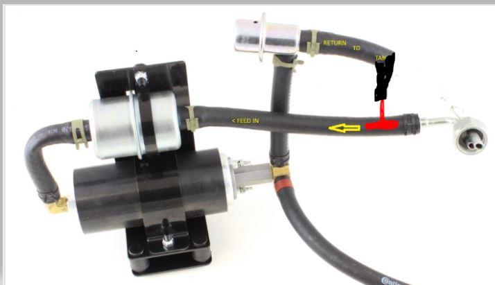

PostPosted: Wed Jun 04, 2025 1:07 pm    Post subject: Re: Washburn EFI for 1600 Bug Reply with quote
Could you just add in a 'T' to the line to the filter/pump ? Just don't use the threaded one supplied and return the fuel to the 'fuel in' side.....pre filter.

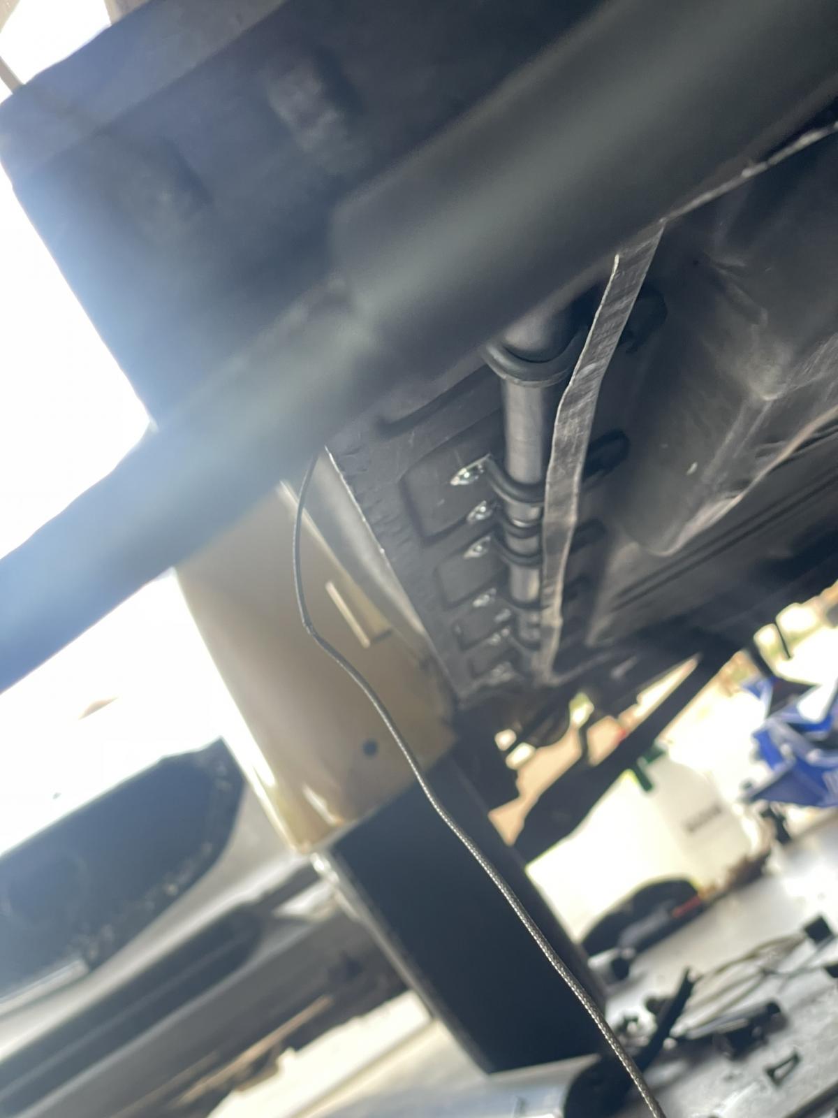

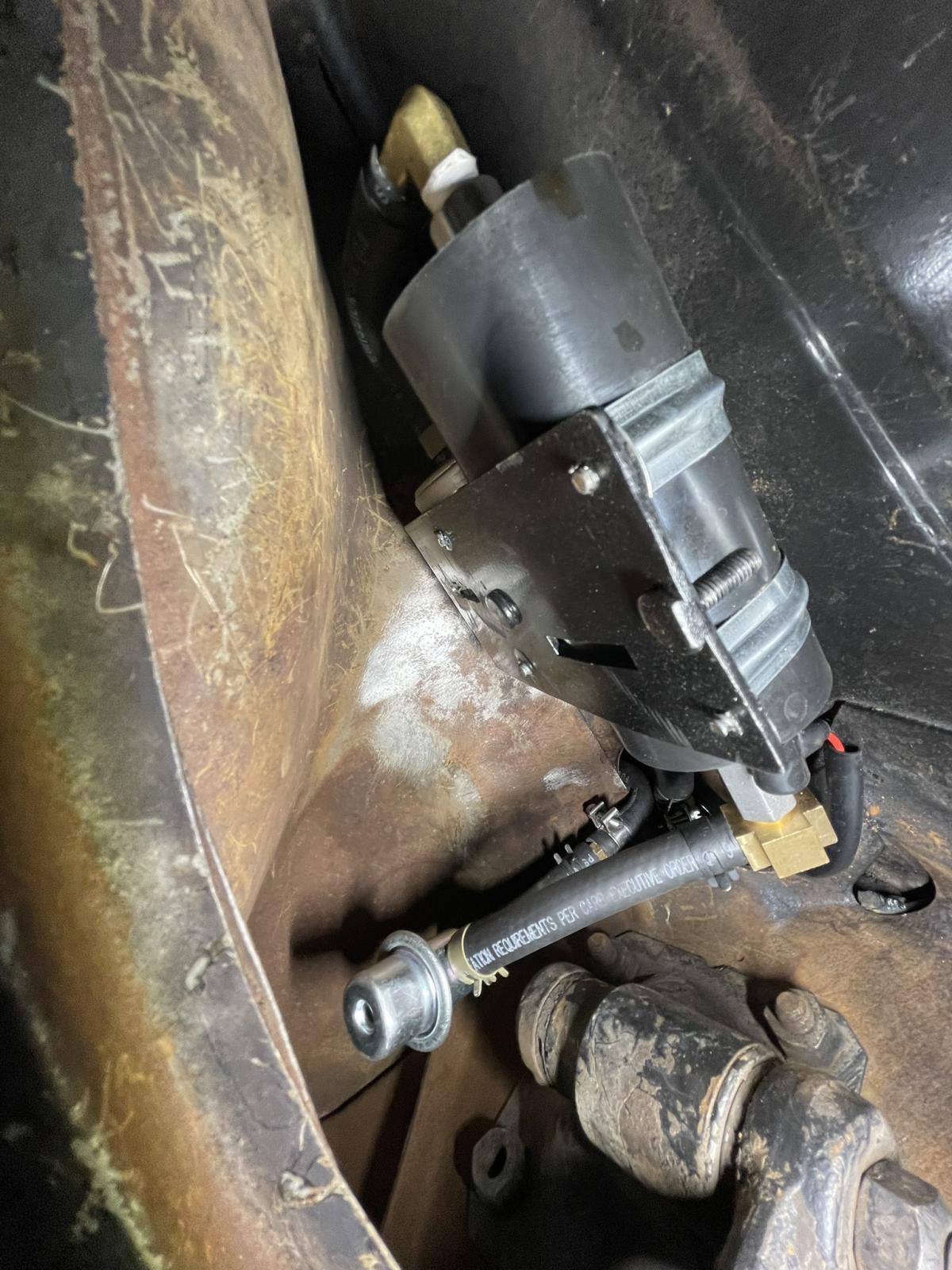

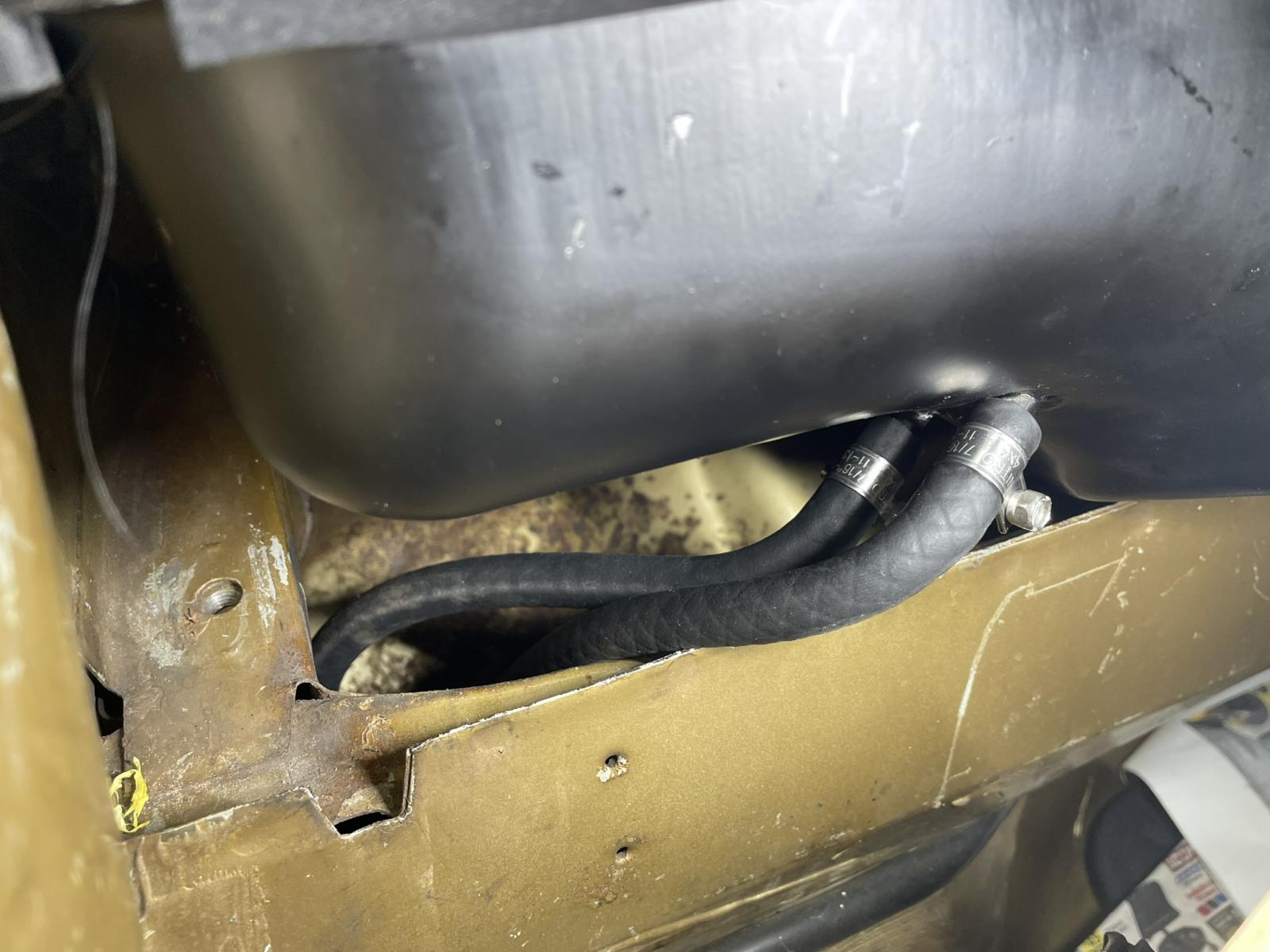

Thanks for the pictures, AMS. What did you do w/the threaded end of the original pump assembly? That's the one item not visible in your pics.

PostPosted: Thu Jun 05, 2025 6:04 am    Post subject: Re: Washburn EFI for 1600 Bug Reply with quote
I'm guessing he didn't use it. Just took a hose to each of the tank connections.

AMS_Dizz
Joined: December 15, 2022
Posts: 35
Location: Arizona
AMS_Dizz is offline
PostPosted: Thu Jun 05, 2025 6:05 pm    Post subject: Re: Washburn EFI for 1600 Bug Reply with quote
I removed it since it was designed for a standard Beetle/Bus fuel tank. I also removed the threaded part and replaced it with a barb splicer for the fuel line to my tank.
If you want, you can ask for more pictures, and I can add them to the gallery.

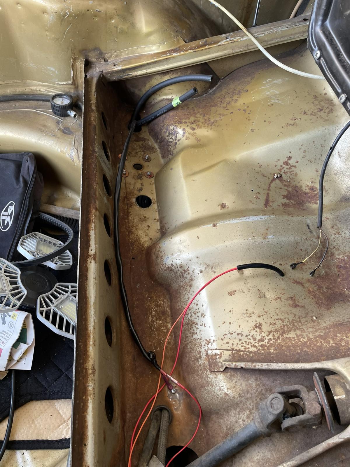

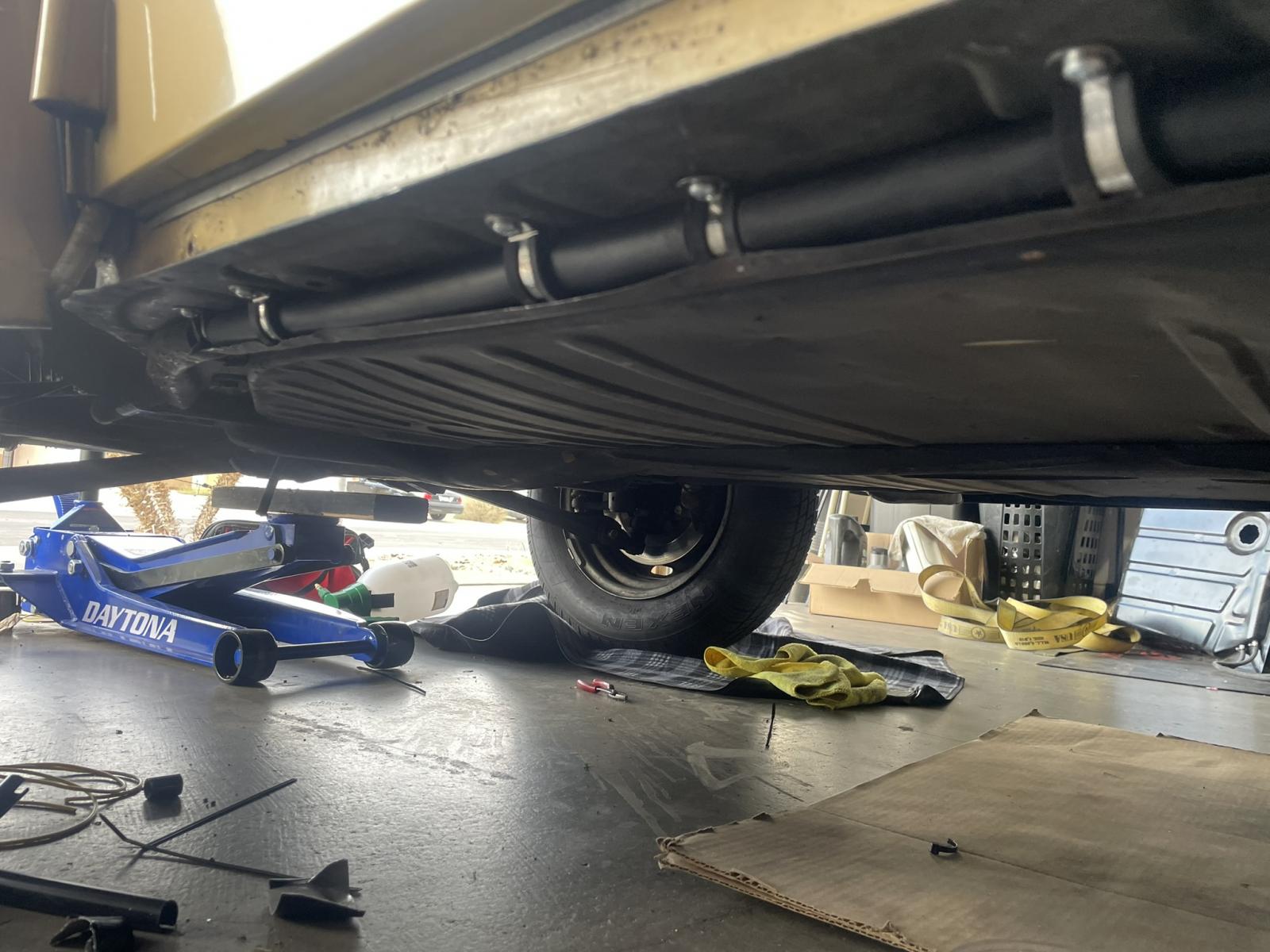

PostPosted: Thu Jun 05, 2025 7:24 pm    Post subject: Re: Washburn EFI for 1600 Bug Reply with quote
More pics would be greatly appreciated!! Cool

AMS_Dizz
Posts: 35
Location: Arizona
AMS_Dizz is offline
PostPosted: Fri Jun 06, 2025 5:06 am    Post subject: Re: Washburn EFI for 1600 Bug Reply with quote

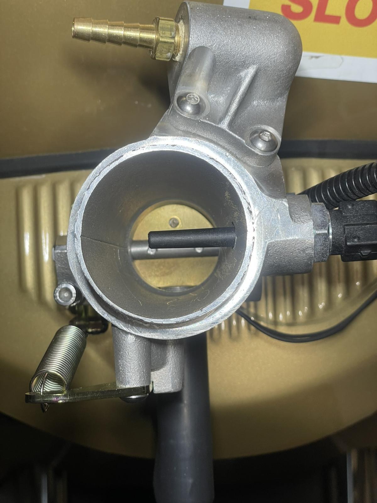

the comparison on 34pict and Fis2 looking down
and this screw is where you can adjust the idle
and adding the fuel injection line along the channel instead of using the stock fuel line which they give press fitting for it.

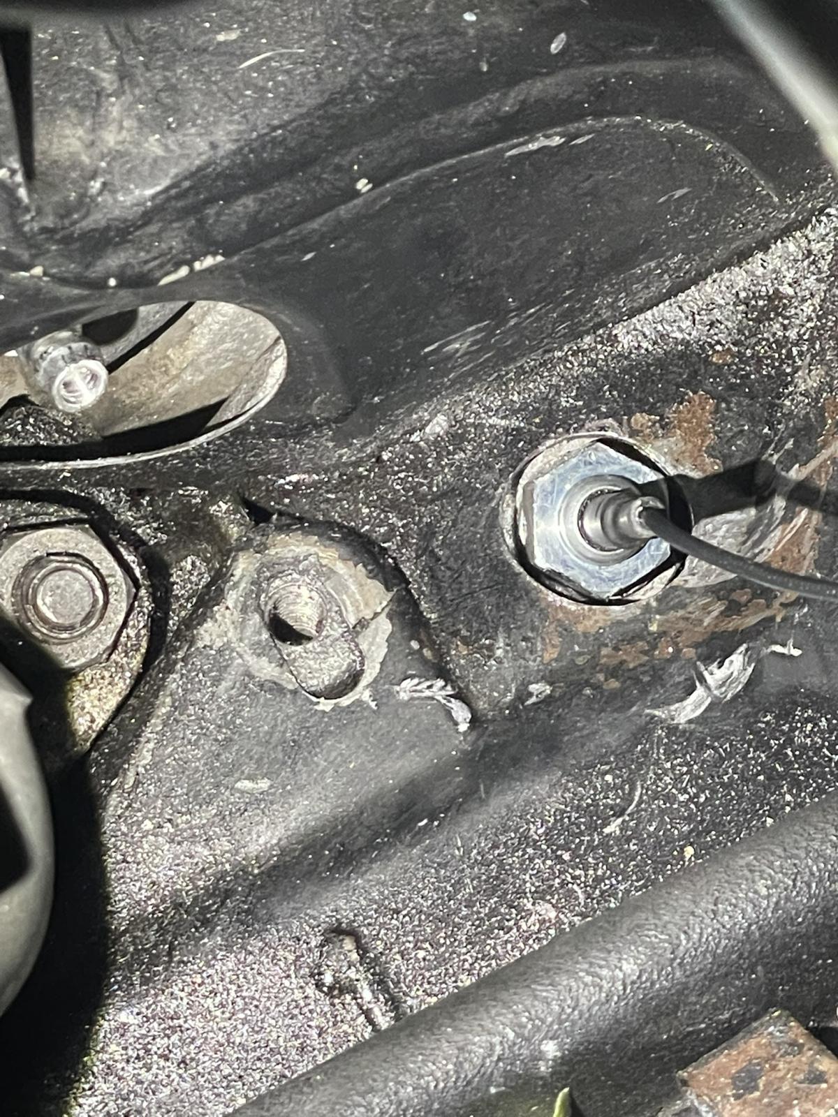

This is the cylinder head temp sensor for the ECU it replace the tins screw.
i relocated the sensor and i have to drill the tin for the thread.

PostPosted: Sat Jul 05, 2025 2:07 pm    Post subject: Re: Washburn EFI for 1600 Bug Reply with quote
Why did you relocate the sensor? Is this a better spot for an accurate head temp? And did you have to tap the head for that spot?

PostPosted: Mon Jul 07, 2025 3:35 am    Post subject: Re: Washburn EFI for 1600 Bug Reply with quote
I relocated the spark plug because it’s easier to remove the #1 spark plug now. The old method, which involved replacing the tin screw with an adapter, was obstructive, requiring the adapter’s removal to access the spark plug.
The head temperature is likely the same since the brass adapter conducts heat to the sensor. However, I believe the head-to-sensor setup is better than the head-adapter-sensor configuration.
The head already comes with a threaded part. The hardest part was making the hole for the thread without damaging it
David Raistrick
Joined: January 26, 2004
Posts: 632
Location: Geneva, Florida
David Raistrick is offline
PostPosted: Sun Jul 13, 2025 3:15 pm    Post subject: Re: Washburn EFI for 1600 Bug Reply with quote
it really shouldnt matter where you put the temp sensor - in this configuration (all of the EFI systems for our aircooleds including the factory) this is just a on/off switch for the cold start fuel enrichment. "is it warm yes or no" is all it serves.
it's not a true head temp - it's a replacement (and used in place of) a coolant temp sensor that says "hey we hit enough water temp"
I'd have swapped it out for Mario's sensor, which is much lower profile. interesting approach, this one, but yeah it really gets in the way of the plug.
