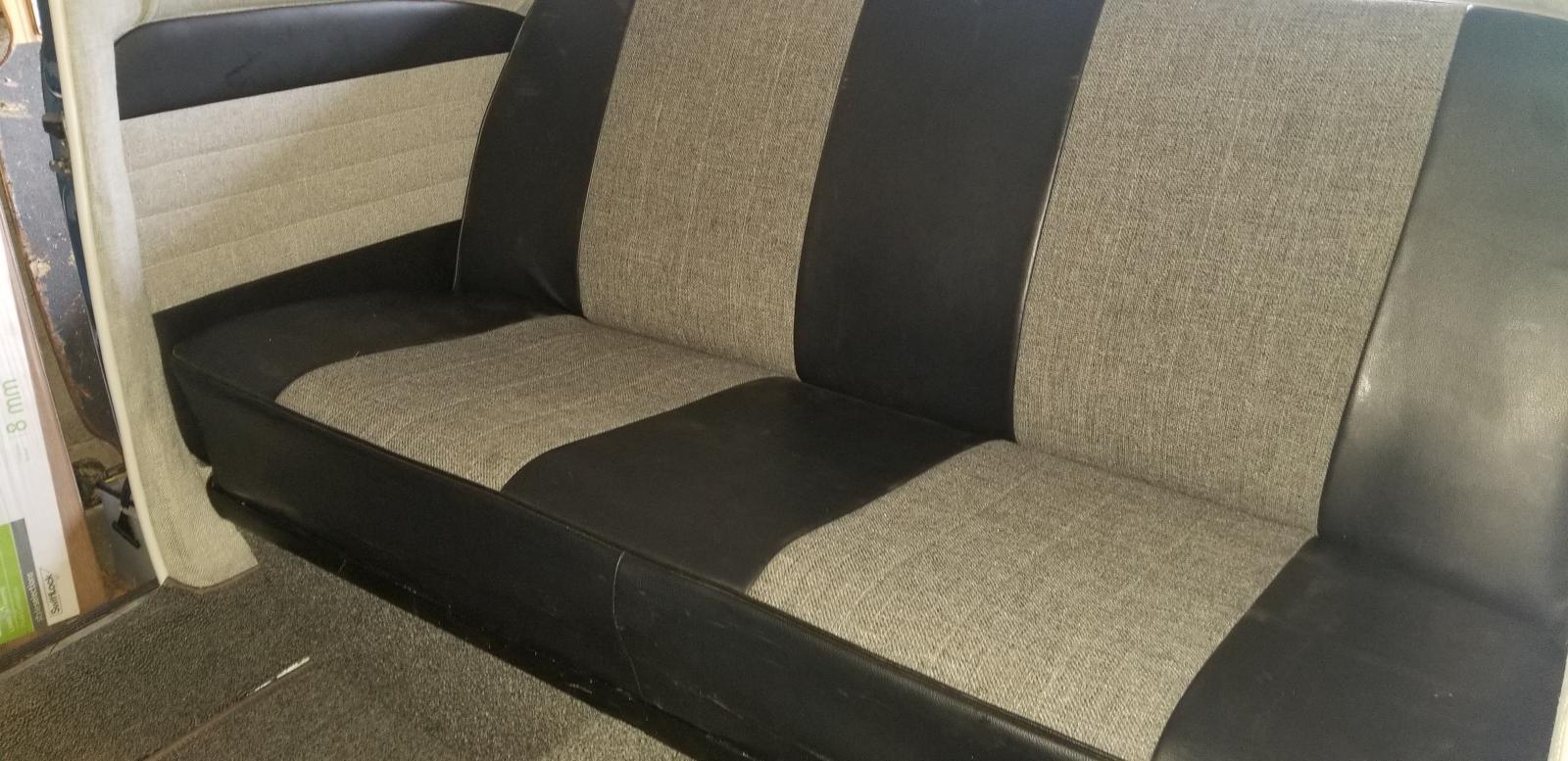

PostPosted: Mon Jul 07, 2025 8:23 am    Post subject: Re: 1963 beetle rear seat back and bottom Dia? Reply with quote
I don't know if you want pics of a bare frame or not, but this is my 63. Hope it helps.
63 T1 Ragtop Gulf Blue

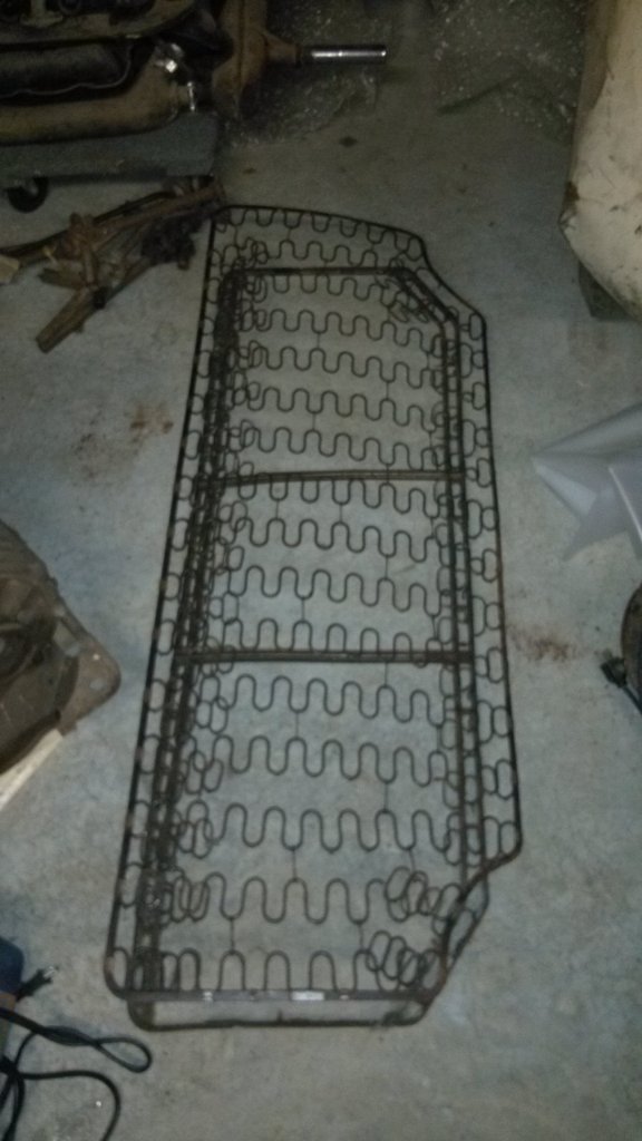

bobnorman wrote:
I have an original '63. The top of the bench portion of the rear seat is 19 inches, not 17 3/4. It has two support bars on the bottom. Old thread, but it may help someone else down the road.
finster
Joined: May 26, 2012
Posts: 9965
finster is offline
PostPosted: Mon Jul 07, 2025 9:28 am    Post subject: Re: 1963 beetle rear seat back and bottom Dia? Reply with quote
Aynthm wrote:
Top image is 56-64
Bottom image is 65-77
Note the difference in the shape of the backs.
both these quotes are from https://www.thesamba.com/vw/forum/viewtopic.php?p=5719600

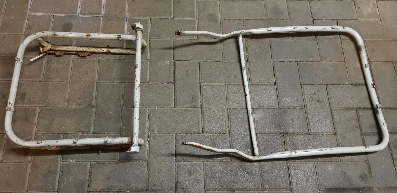

PostPosted: Mon Jul 07, 2025 1:06 pm    Post subject: Re: 1963 beetle rear seat back and bottom Dia? Reply with quote
can only serve this purpose:
front seat 1963
pipe diameter seat frame 20 mm
pipe diameter backrest 22 mm
