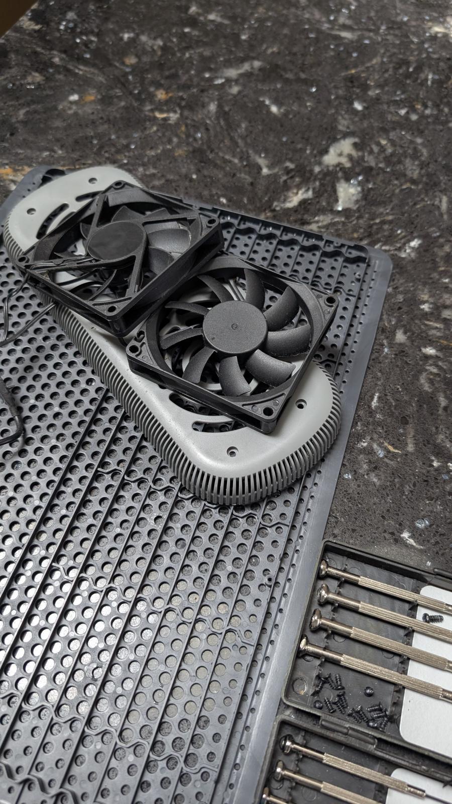

It's kind funny that you posted this when you did because I was just watching a bunch of stuff about lifepo4 and their inherent saftey over other lithium chemistry.
Then, a couple days after I replied here, Will Prowse posted a vid about lifepo4 saftey.

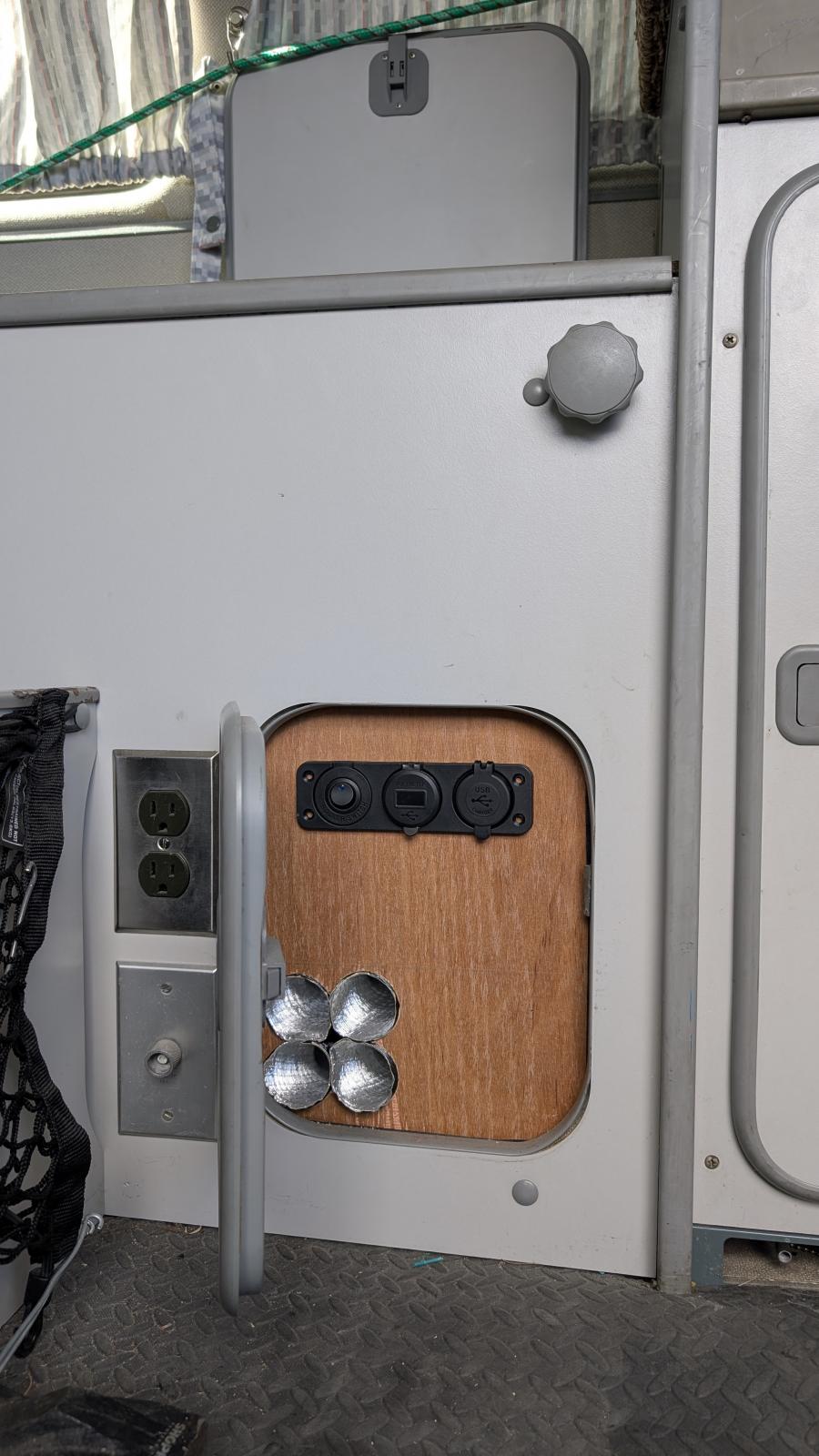

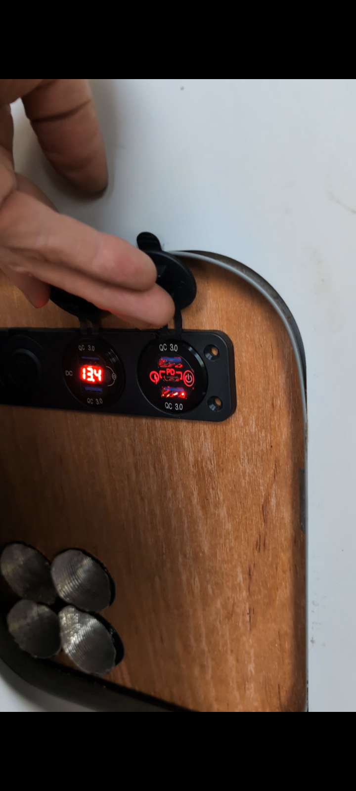

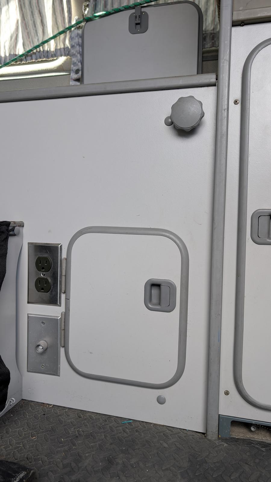

PostPosted: Thu Aug 14, 2025 6:35 am    Post subject: Re: LiFePO4 Batteries: Discussion Thread Reply with quote
Hey vwhammer....
Thanks for the insight and perspective on both applications. I have used space constraint fuses for a few below 100amp and ,..Yes I also used an online fuse to my Aux fuse box of 6 low amp blade fuses.
My system works like a charm. Powered for a week and the plug in to shore power to charge my lifepo 100ah battery.
No DC...No MPPT yet but in the future. My whole system cost approximately $1000 with heavy tinned copper termination lugs, crimper tools and welding cable (in short lengths).
I may invest more sooner than later on Solar but for now.... I'm good for a week.
My plan is to have the capability to charge my two 19ah e-bike batteries from battery bank over night. I expect I will need 400w of solar array but not sure what battery capacity to build up.
