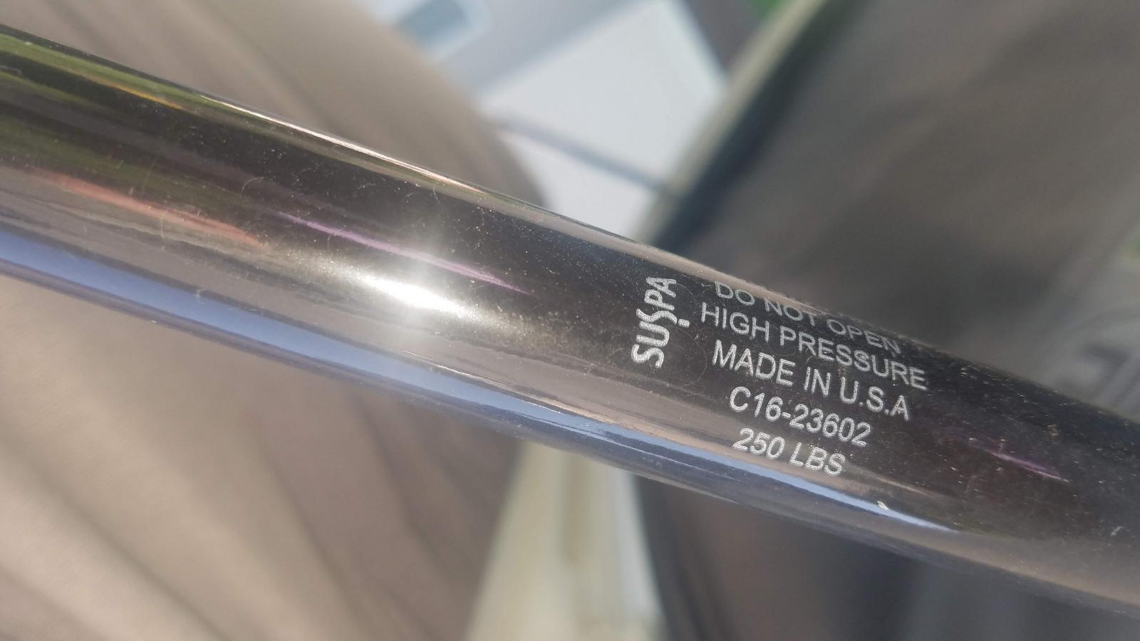

I have these and they will hold the hatch freighted with two bikes as well as a full ladder. From McMaster, you'll need they eyelets for them too.
This pic the second bike is missing but they do hold it up too. Waterport Tank filled with 4 gal. of water.

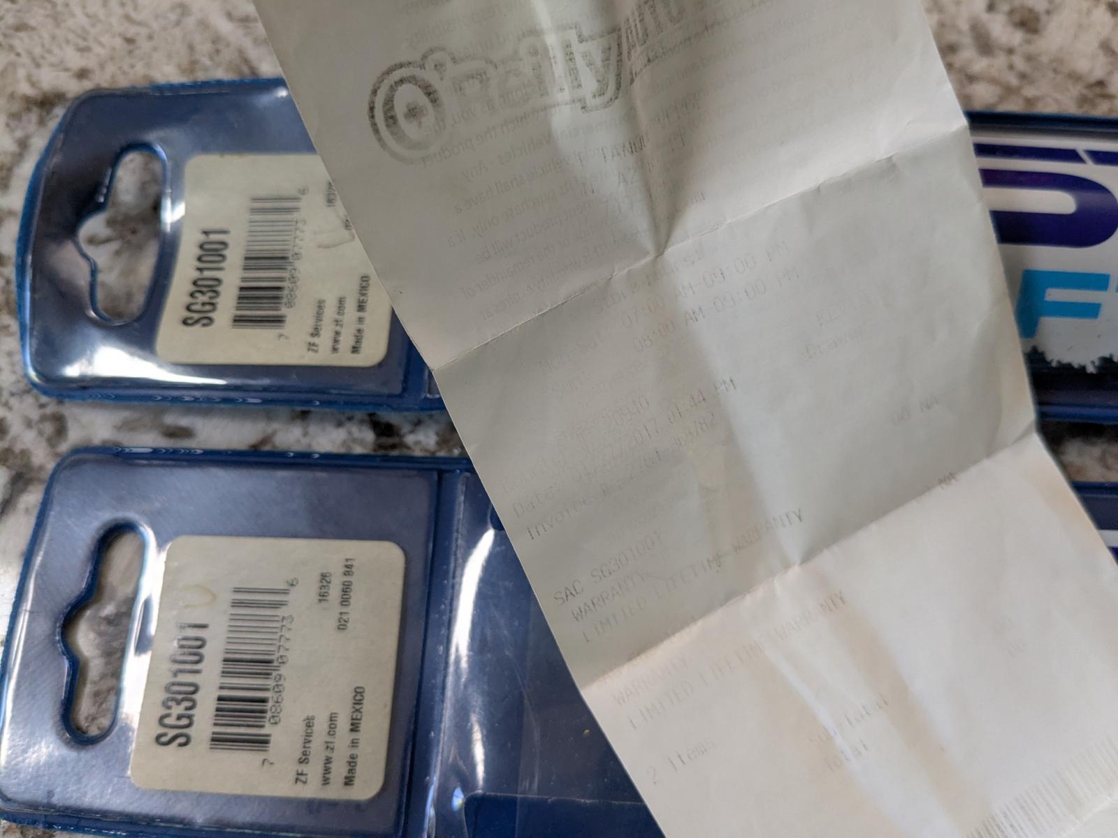

Ages ago I got my hatch struts from O'Reilly's. They work fine and have a lifetime guarantee. I've replaced them once about 8 years ago, a simple no hassle exchange.
Fortunately they have it in their system since receipts seem to be printed in disappearing ink.
heat printers/paper :-/
pic or scan of receipt always helpful, especially if you can access on phone
when Checker got taken over by Oriley's, copies of receipts were VERY helpful on the continued lifetime warranty
