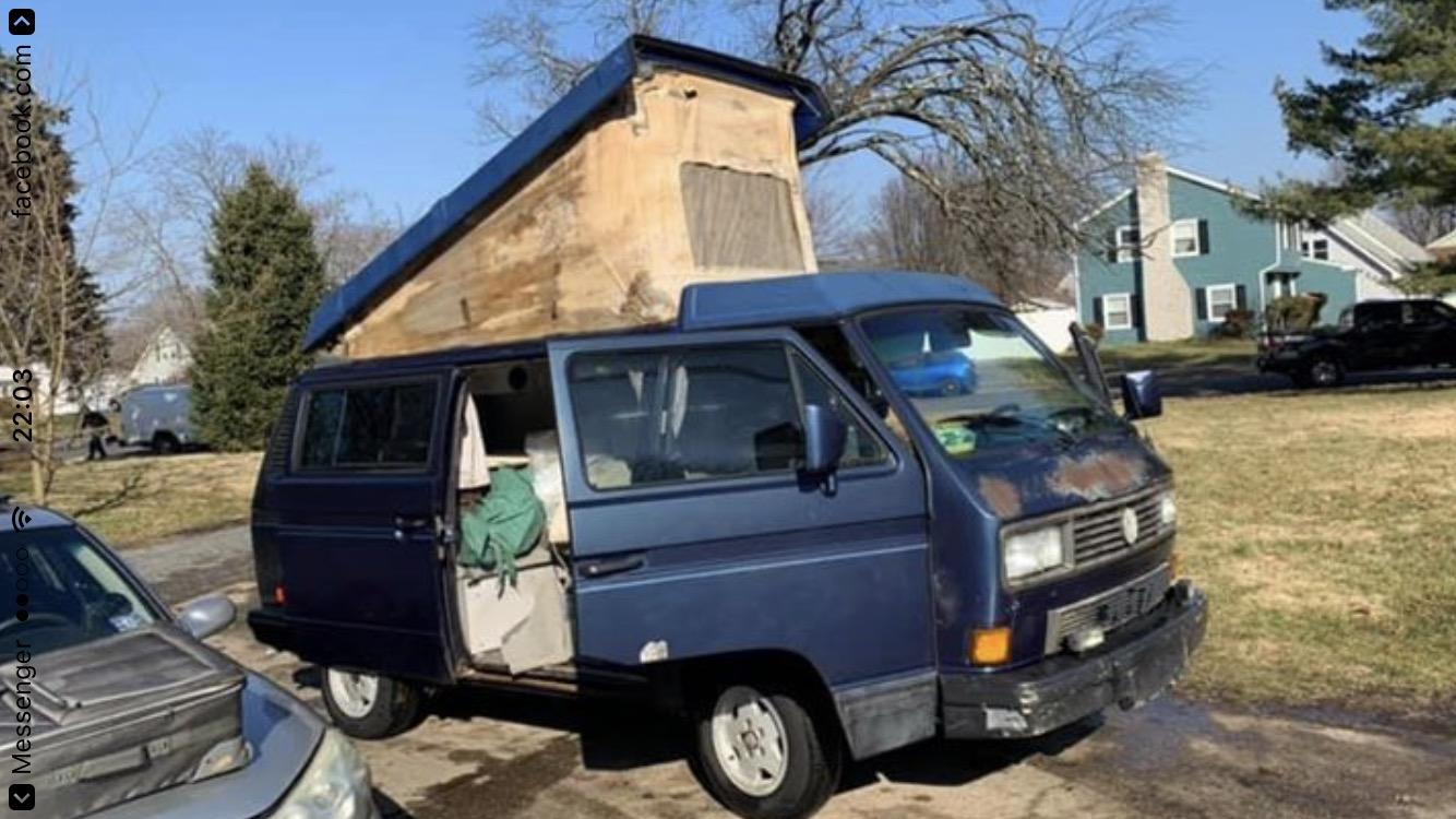

i am finalizing the sale and bringing home a 1991 full westy tomorrow. it was a backyard find in NJ and sat for over a decade before being rescued recently by a very interesting gentleman. he spent some time getting this running and replaced the tires with Hankook RA-08's before driving it about 10 miles to his house. it's not a beauty queen and has some minor rust, a few dings, a crunched right rear wheel arch and there is some seam rot on the driver's side rear that will need addressed. i'm going to have it towed the 50 miles to my house since there is no way i'm driving this, esp. since it has to go over the Delaware River on the PA turnpike!
the engine will need some work since both heads leak coolant until things heat up, then it just drips coolant. it will need all new belts, hoses, and fuel lines. it has just under 120k on it so it might have a few years on the bottom end until i need to be concerned. i'll check the torque on the head bolts, check the oil pressure and do compression and leak down tests to see how it looks overall. i'm thinking i might be able to drop the engine and just do the top end reseal, water pump, and anything else that jumps out at me while it's on the bench.
the tencentlife heads are tempting, it really depends on what i find when i pull the heads. i may end up putting the split case rebuild i did last year for the tintop into the westy to get it going and do a full rebuild later this year. that would be a fun project to do with my 12 year old son.
there are some electrical issues to be sorted out. the power door locks do the cycle routine, the turn signal LED is constantly on (water in the lenses), and the ignition switch will need replaced. it is being started by shorting the starter with a screwdriver. there appears to have been an alarm system and remote starter added and that will need to be addresed as well. i'll check the operation of the windows when i pick it up.
as you will see, this is a bit of a project which i hope to have roadworthy and camp ready for Vanagons in the Valley 10 this July in Duncannon, PA. it's a lofty goal, but it's good to have a deadline to work toward.

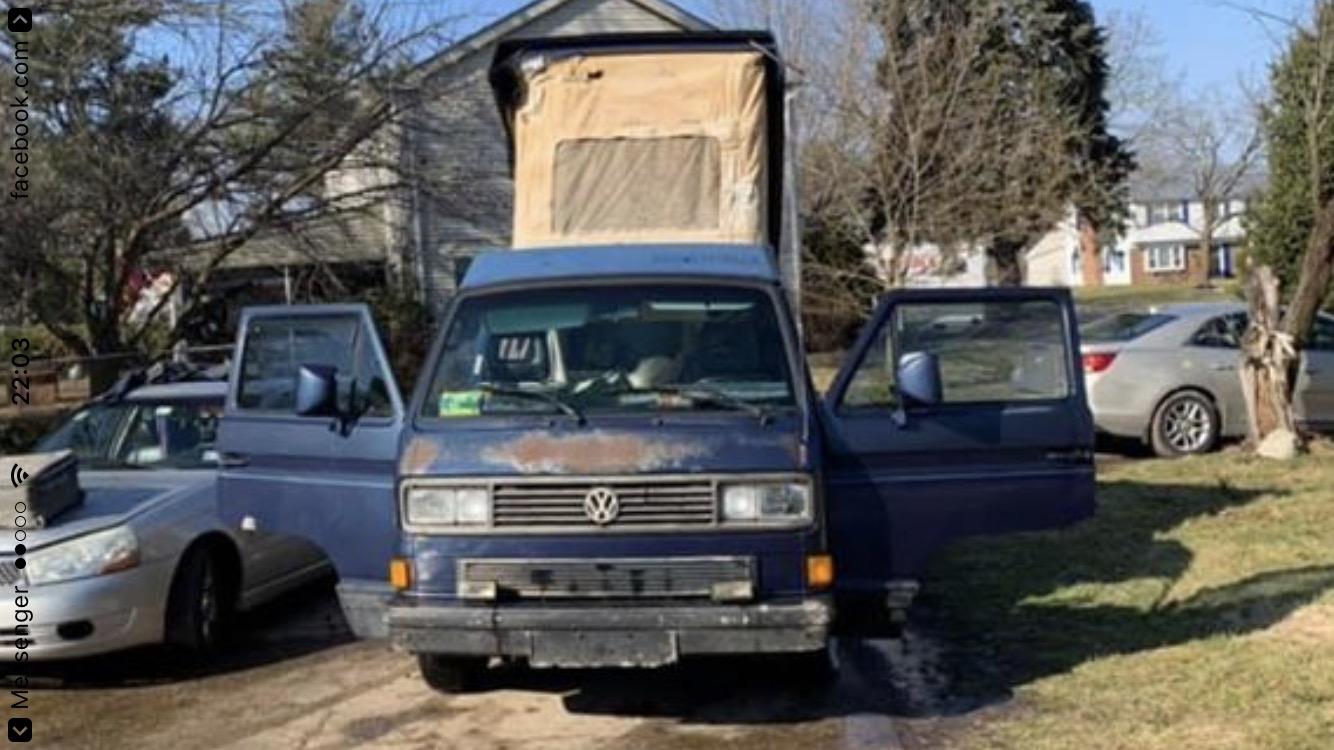

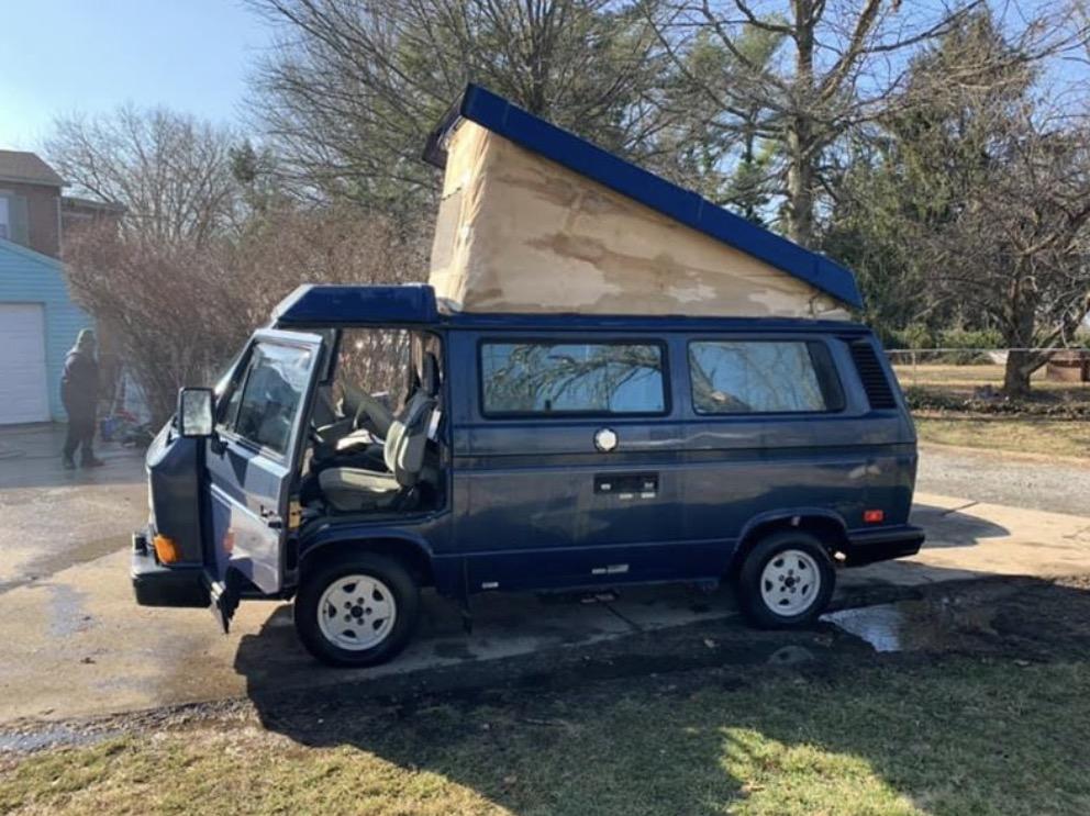

i think the rust on the front is from water getting behind a bra. in the photo the area is still wet from power washing it so it looks worse than it is, the seams on each end are good. a bit of sanding, some build up primer, more sanding, and a rattle can of LA5B and clear coat should do the trick (i'm being optimistic).

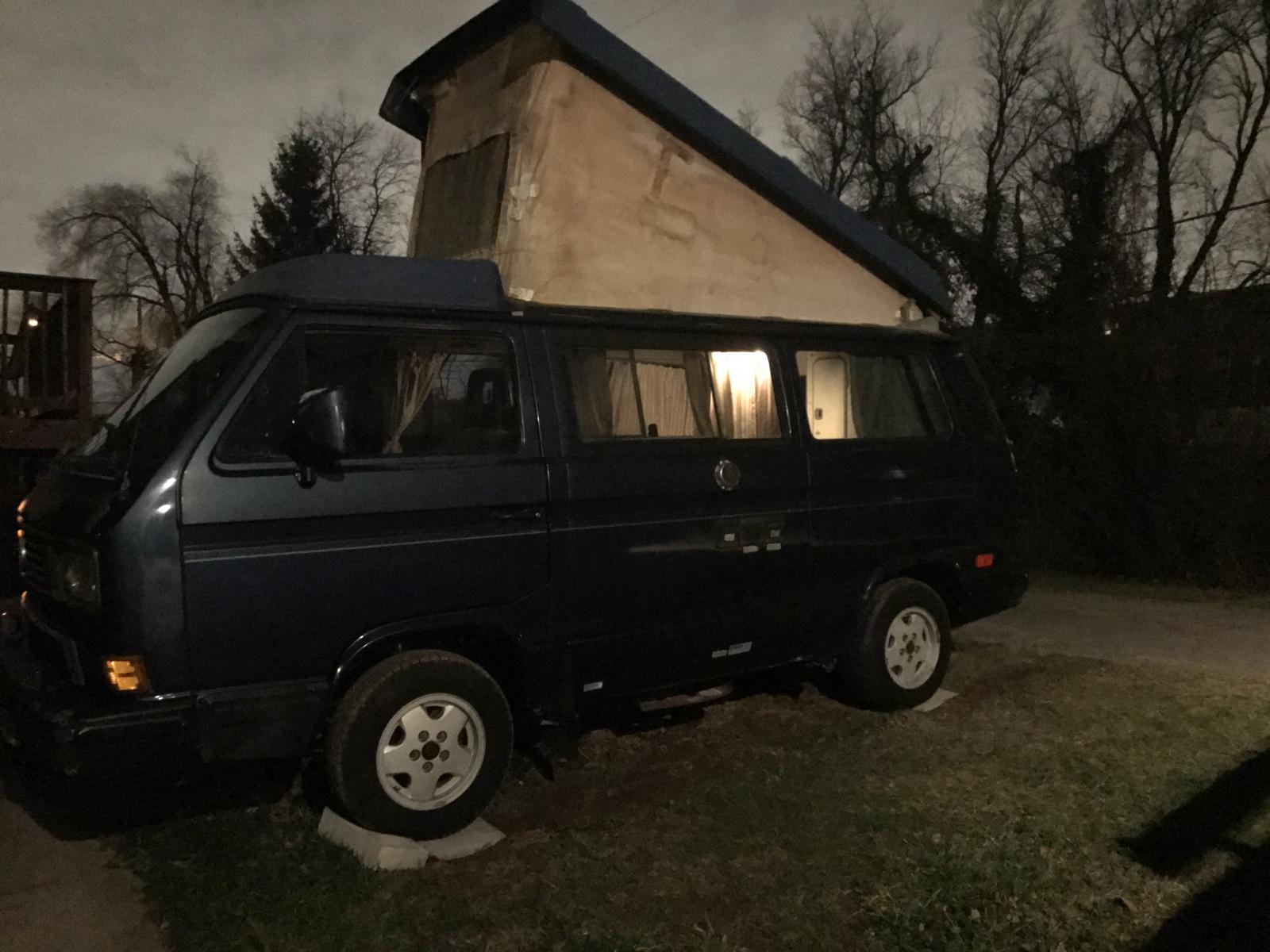

the tent is well past it and will be replaced with a Bus Depot three screen model.

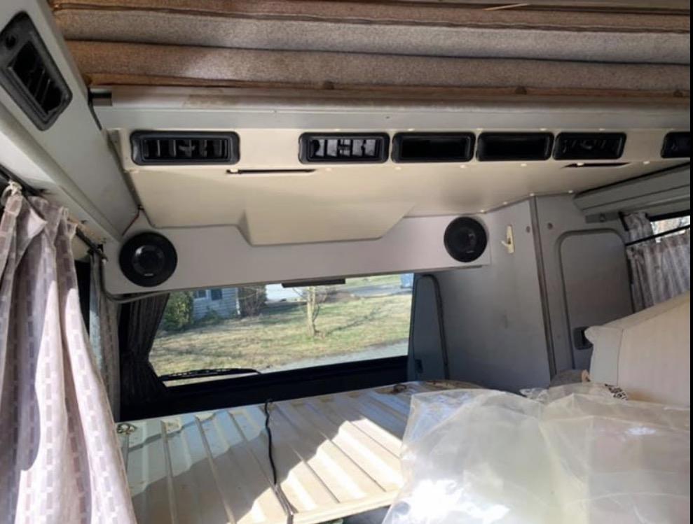

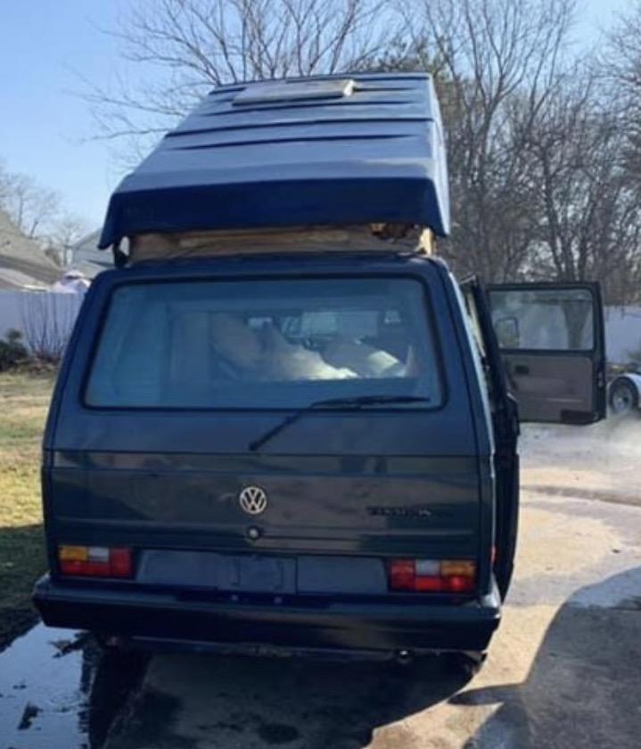

the skylight will need to be completely replaced. it was covered with a large baking sheet with a tire to hold it in place, but it has allowed water in over the years. the pop top latch will need refurbished, i'm planning on getting this powder coated or painting it with a hammer finish. the pop top will get a bleach solution treatment and allowed to air out when i replace the tent.
the driver's lower seam is rust free. the LP tank will need to be wire brushed and have updated fittings added before it can be used safely.
the rear hatch is in good shape. it will need new struts and the electric lock actuator fixed/replaced.

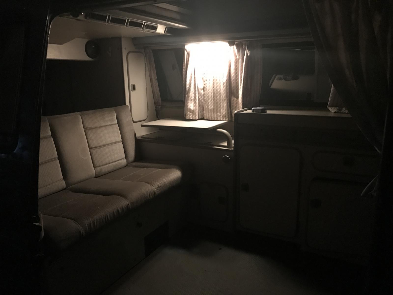

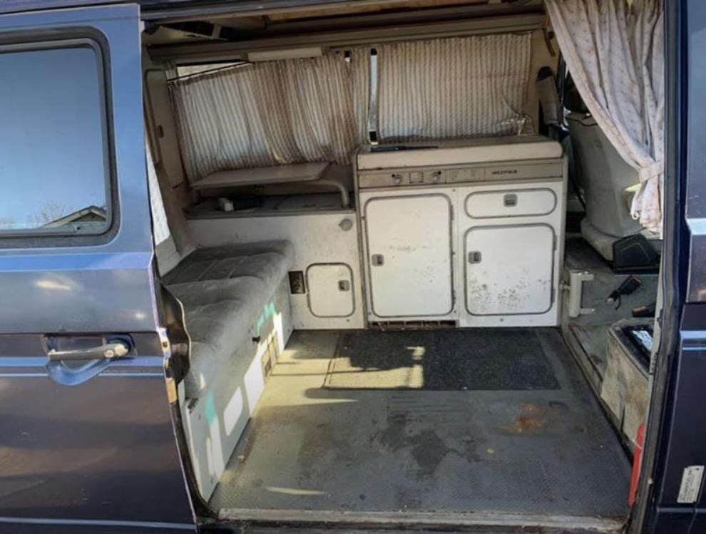

nothing a bottle of bleach, a box of magic erasers, and a shop vac can't sort out, right? i plan on removing the interior and really giving this a good cleaning. i'll remove the insulation behind the kitchen and check for leaks around the ports. i'll most likely replace all three of them.
i have my work cut out for me, but the cabinets are in good condition and all the curtains are intact. all fabric items will be washed and all surfaces sprayed with a bleach solution.

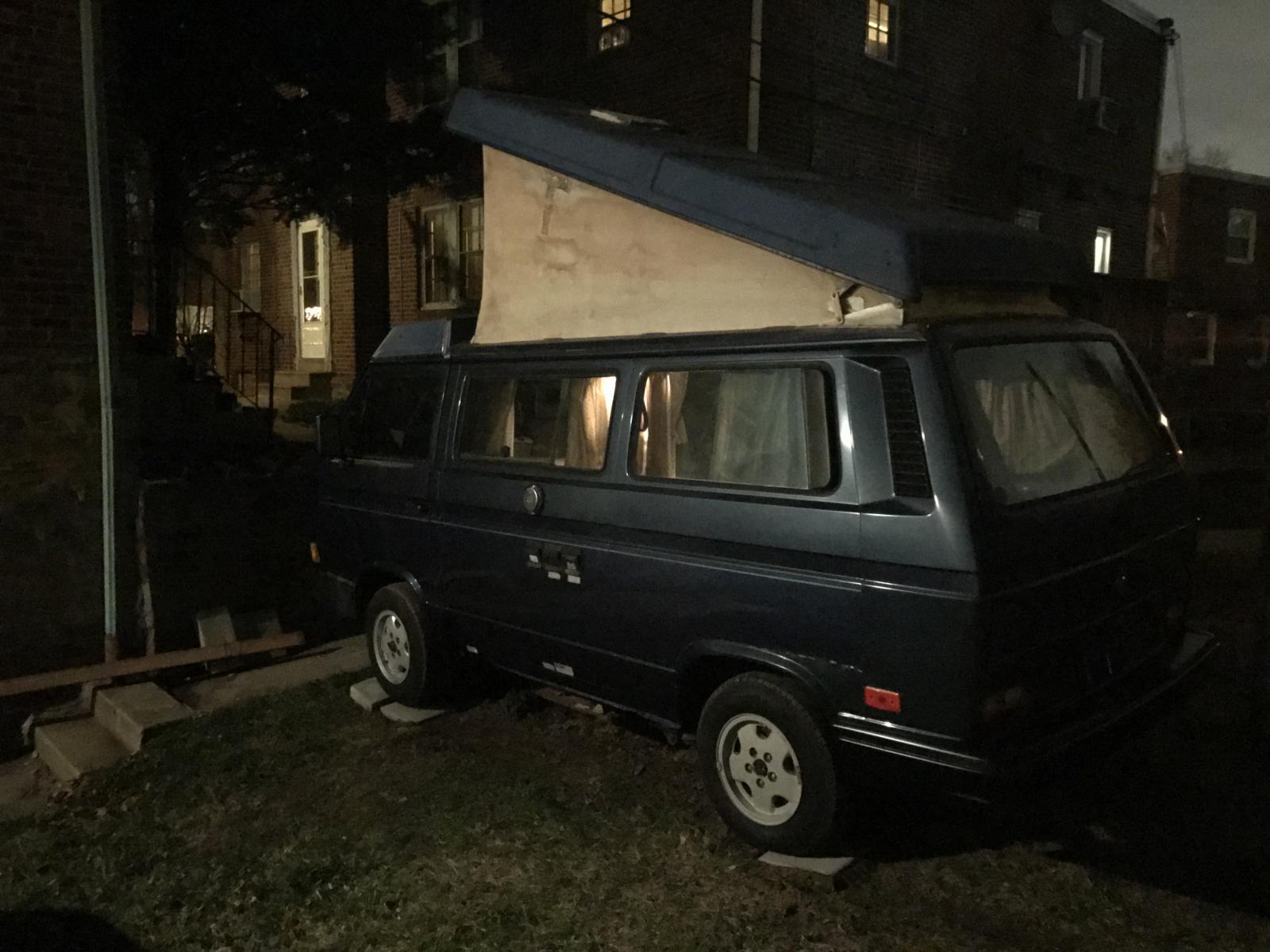

this is the worst of the known rust. i'll remove the rust and apply a rust convertor and then primer and paint it when i do the front. at some point in the future i'll replace the panel but slowing the rust is the priority.

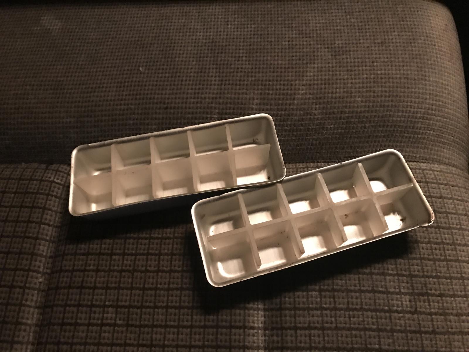

Nice - you even got the teeny ice cube trays!!!
